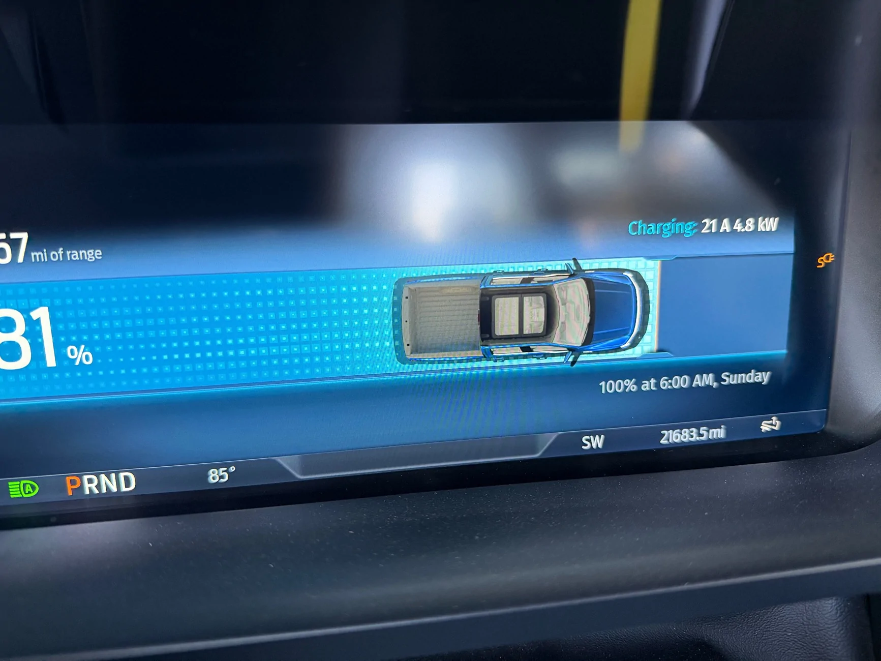

Well all is well! Thanks to those who helped. Took took 5hrs 10min for the IPC. I had an extra battery hooked up with a 60amp charger that was almost full blast the entire time. I loaded the 24 as built and then just quickly did the changes for seat belt ped sounder and glare free. Seems to be working as it should. I’ll be going out shortly and will try BC to see how those animations might have changed. Interesting. Ford pass is showing 4.1kw while the dash reports 4.8kw. 🤔
I've noticed that as well. Seems the dash is reporting what's coming from the EVSE. Mine was showing 48A 11.5kW which was what the Tesla UWC was reporting. Ford app showed around 10.5.

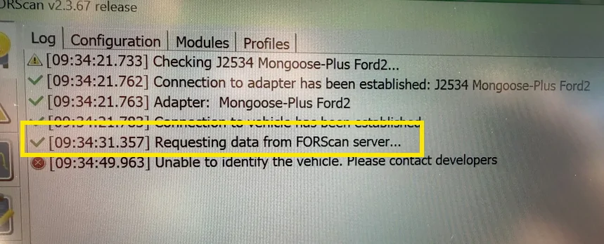

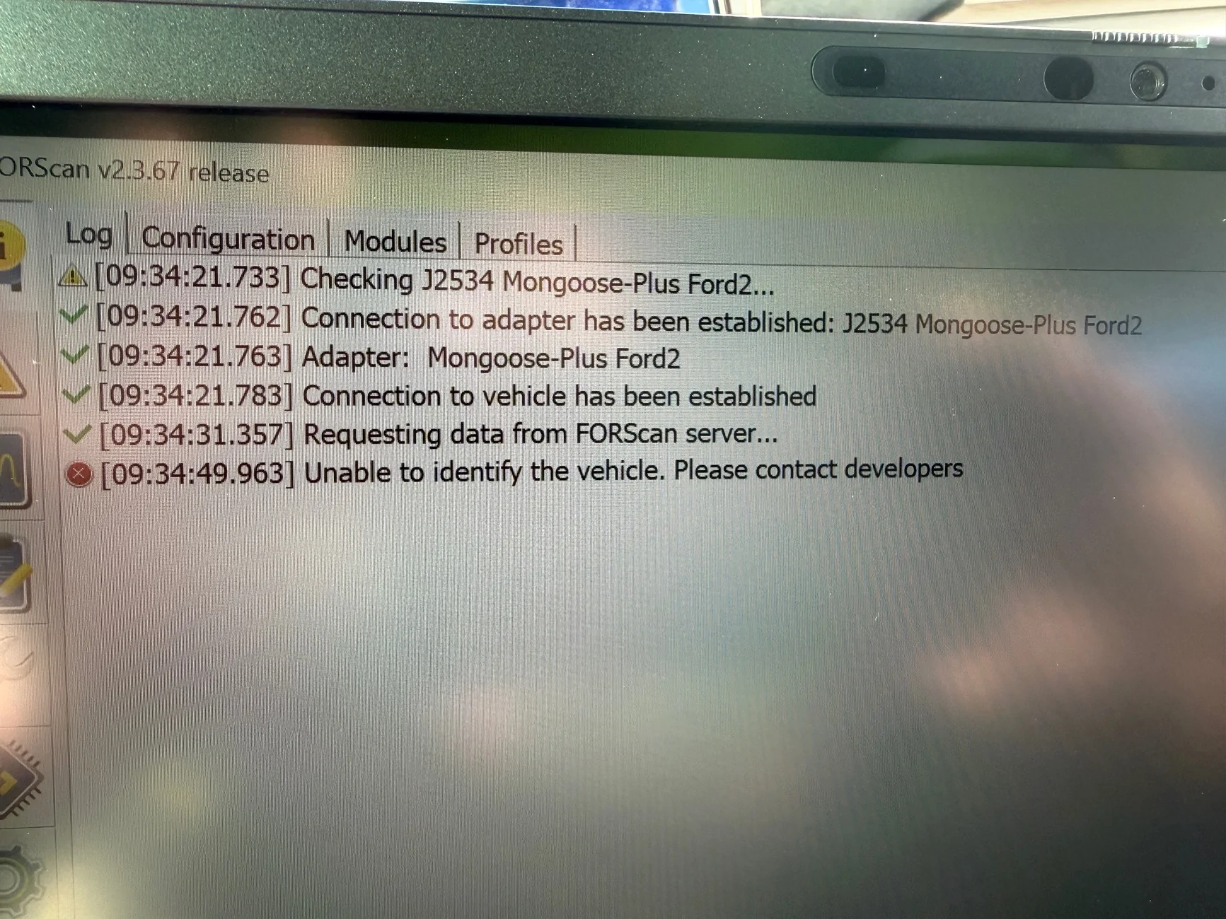

Ok. Here is a new one. Did this update yesterday. And then fdrs updates this morning. And now forscan can’t identify the vehicle. 🤔
Ford F-150 Lightning Enabling charge speed on dash. IMG_1747
3,250
4,730
Did you clear your profile (under that Profiles tab) and do a fresh scan?
I don't recall seeing that it connects to the FORscan server. Have you tried using the non-beta software you used to do the IPC side-load?
My log doesn't show it connecting to the FORScan server:
(OK) [13:26:36.850] Adapter: OBDLink MX+r3.1.3 STN2255 v5.10.3 (ELM327 v1.4b)
(OK) [13:26:37.117] Connection to vehicle has been established
(OK) [13:26:37.507] Ford F-150 Battery Electric Vehicle 110-180kWh 2022 ( 2022 MY ), VIN: 1FT************
(OK) [13:26:40.433] OBD2_PCM - On Board Diagnostic II (PCM)
Your log:
Your log:
I used the beta first. Then reinstalled normal forscan and got the same message. But I’ll try again later and clear profiles. Side note Mac user here. lol. How can I have both beta forscan and normal forscan to be on my computer at the same time? I tried changing the name but that did not work.

I've just been using the beta version since I installed it. Didn't see a reason to switch back. Odd that it's not working now. Maybe an issue with the Mongoose?

Ok. Tried again. Cleared all profiles restarted laptop and forscan. This only happened after doing fdrs updates. There was not a pcm update but I did a generic function module 2 update that kept failing but it triggered a bunch of other modules to update one was the pcm. So who knows. Update. I logged into fdrs and tried the PN of the pcm as forscan asked for and still got the middle finger.
Ford F-150 Lightning Enabling charge speed on dash. IMG_1750
Ford F-150 Lightning Enabling charge speed on dash. IMG_1749
PJnc284
Sep 30, 2024
1,238
1,407
Garner, NC
Definitely haven't seen that one before. Did you try reinstalling the beta? nm. See you got the error on the beta first.
