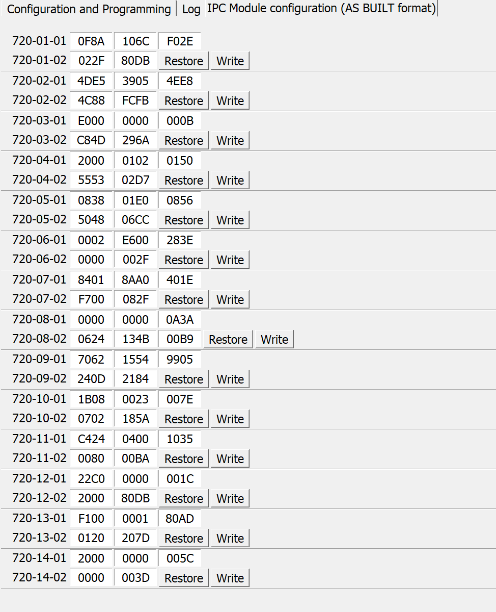

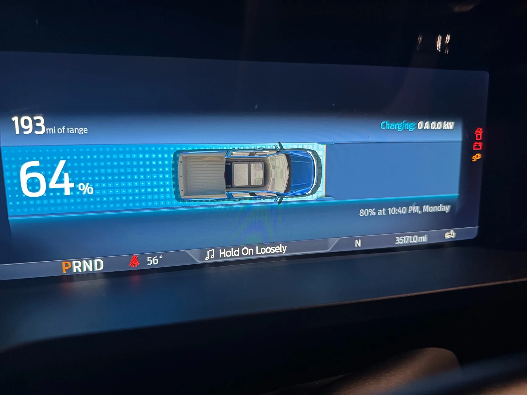

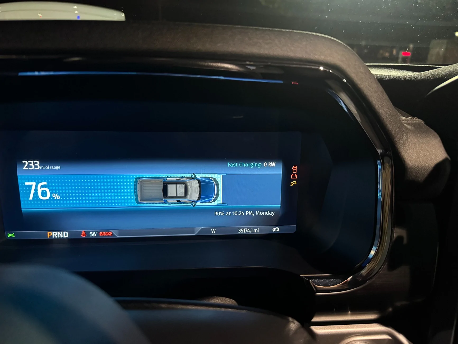

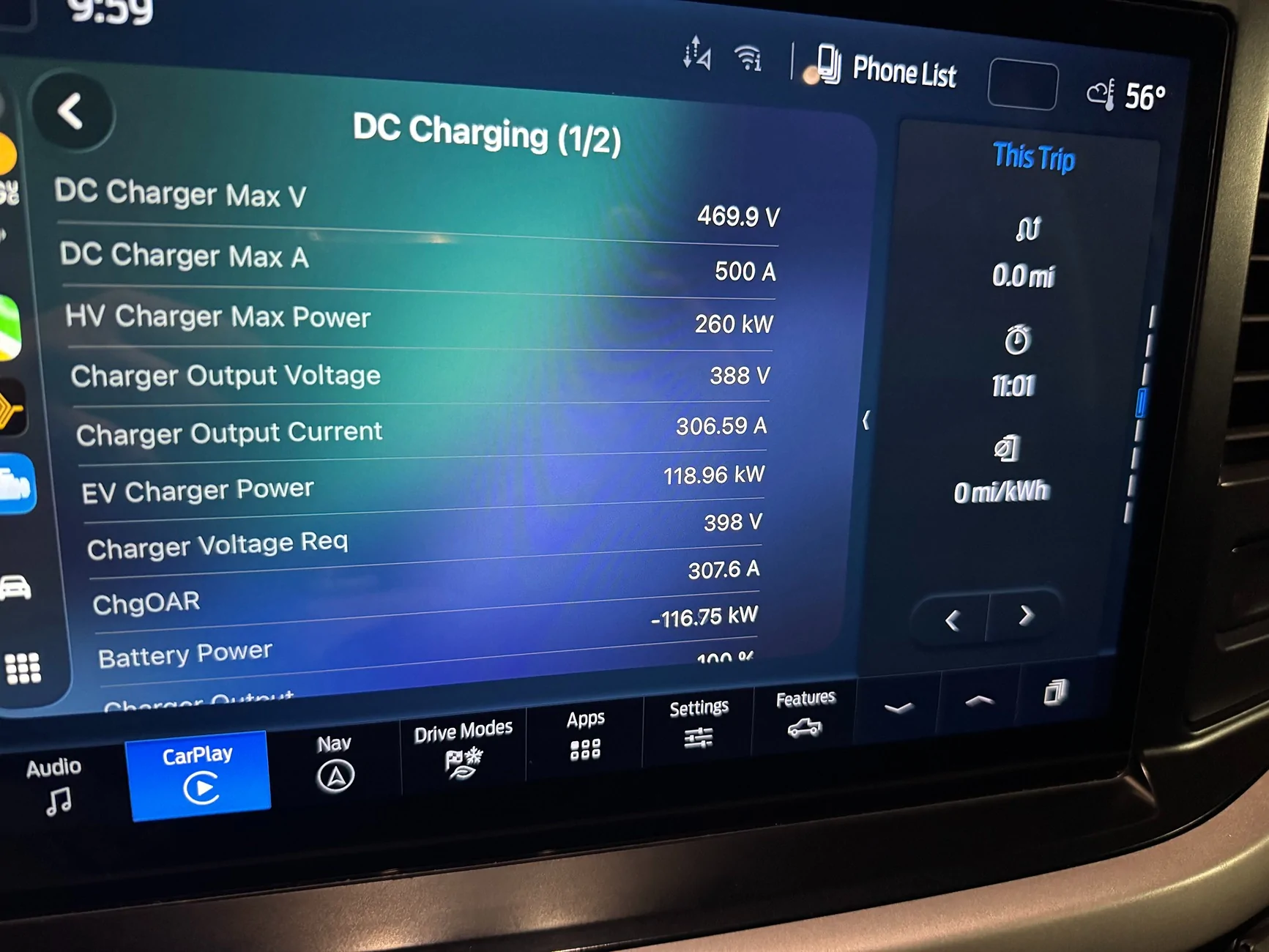

So I just found this thread, thanks to Transport Evolved, and this is something I've wanted for a long time for my 23 XLT XR Lightning. Thanks to this tread and TE I was able to get the IPC updated and loaded the 2024 As Built file loaded successfully. Everything looks great and seems to function as expected with one minor exception the charge rate shows 0 kW. I've attached a few pictures showing that both AC and DC charging doesn't make any difference, using Car Scanner you can see the vehicle knows it's charging and I've attached the as built setting after loading the AB file.
Any idea what setting needs to be changed for the XLT? Thanks for any help on this.

What was your last update to the truck. This is what I was told on my 22 XLT ER when I did this. Everything worked fine as I had just updated everything via FDRS.
"The rest of the modules have to be up to date. The SOBDM a-c, PCM, BECM.
If they aren't the rate will not display"

Yeah these updates require the BECM, SOBDM, at min be updated.
When I helped the first person do this they had to do the updates for it to work.. they had the same issue.
Once the modules were updated it worked.
Most of those are updated in groups though and cant be updated independently.
