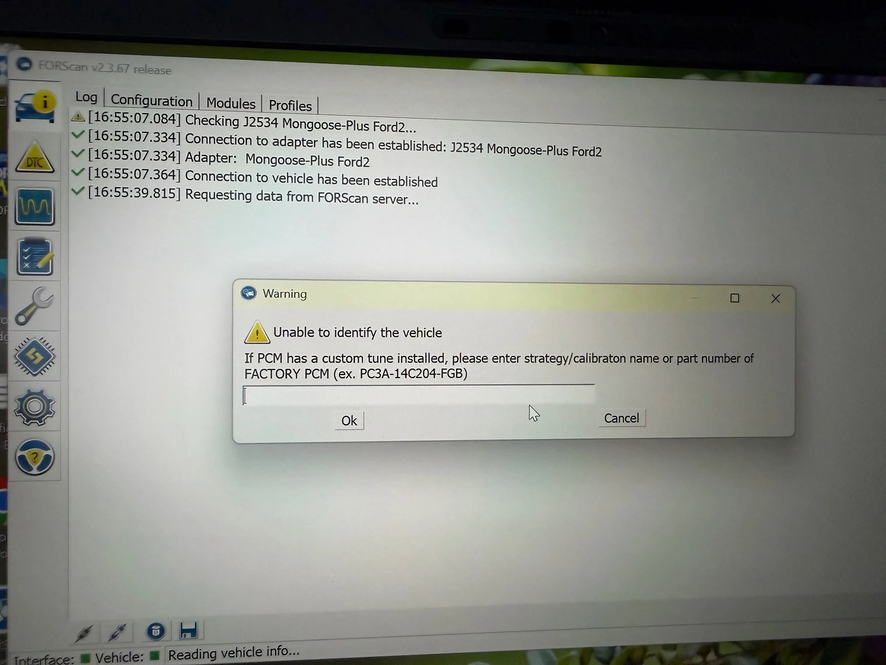

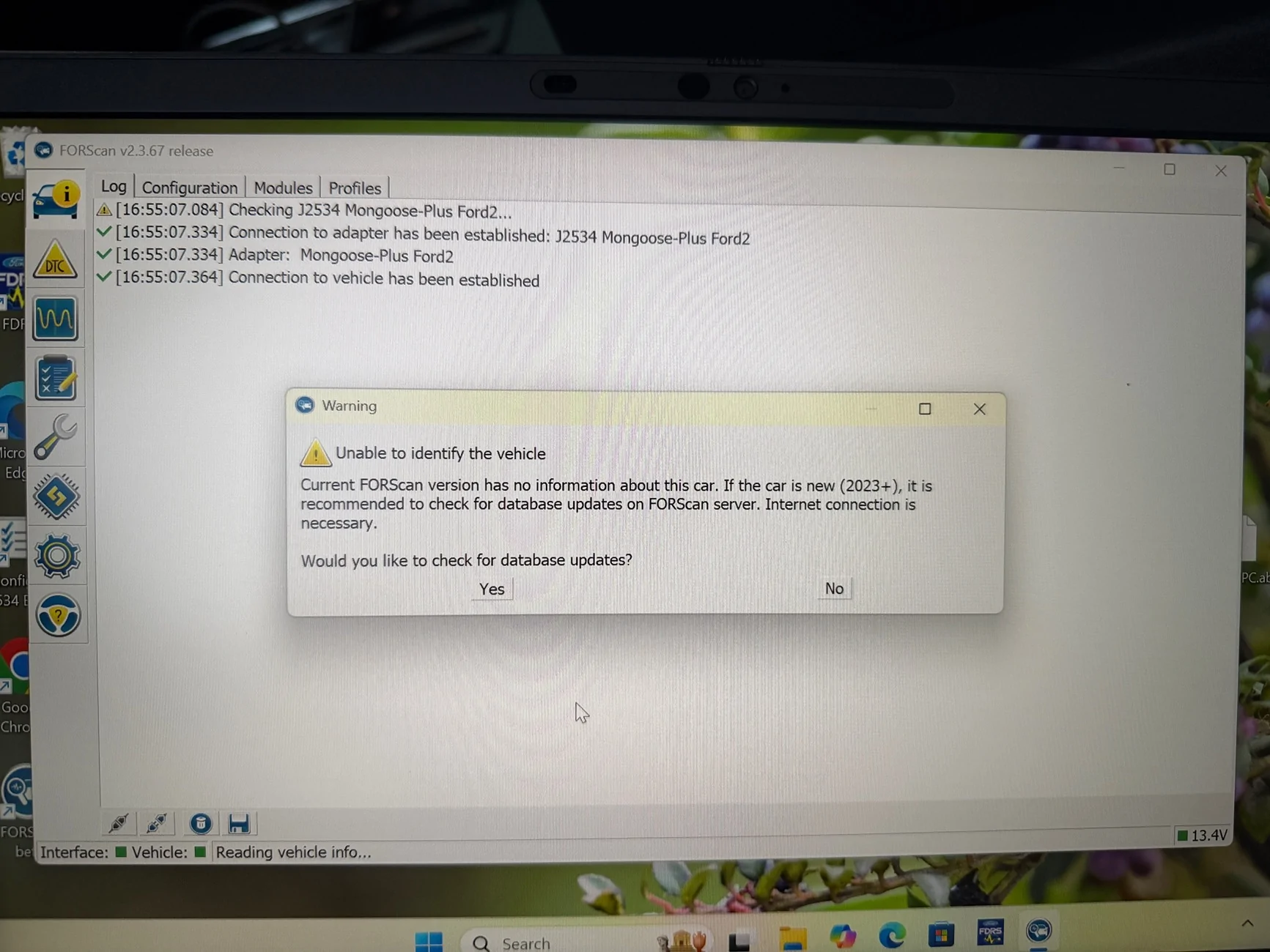

Ok. Tried again. Cleared all profiles restarted laptop and forscan. This only happened after doing fdrs updates. There was not a pcm update but I did a generic function module 2 update that kept failing but it triggered a bunch of other modules to update one was the pcm. So who knows. Update. I logged into fdrs and tried the PN of the pcm as forscan asked for and still got the middle finger.

Definitely haven't seen that one before. Did you try reinstalling the beta? nm. See you got the error on the beta first.
I reinstalled the normal forscan twice. Just to be sure. Hopefully the forscan gods will figure it out. I just want to fix my 24hr clock and the phone button on the wheel. lol.

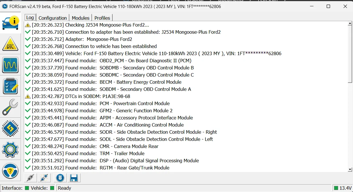

yeah mine isn't giving the requesting data from server message. In other news my charger coupler apparently got too hot and I don't even recall having it plugged in then. :crazy:
Code: P1A3E - Battery Charger Output Limited - Battery Charger Coupler Temperature 'A' Too High

If you updated the PCM it just means the PCM strategy is not in their database yet. Enter this
PL3A-14C204-JP

I believe the requesting data is if you have a free license .. COuld be wrong.
I pay for the yearly license. I like the idea of helping to support the platform. I will try that strategy number when I get home tonight and report back. 😁

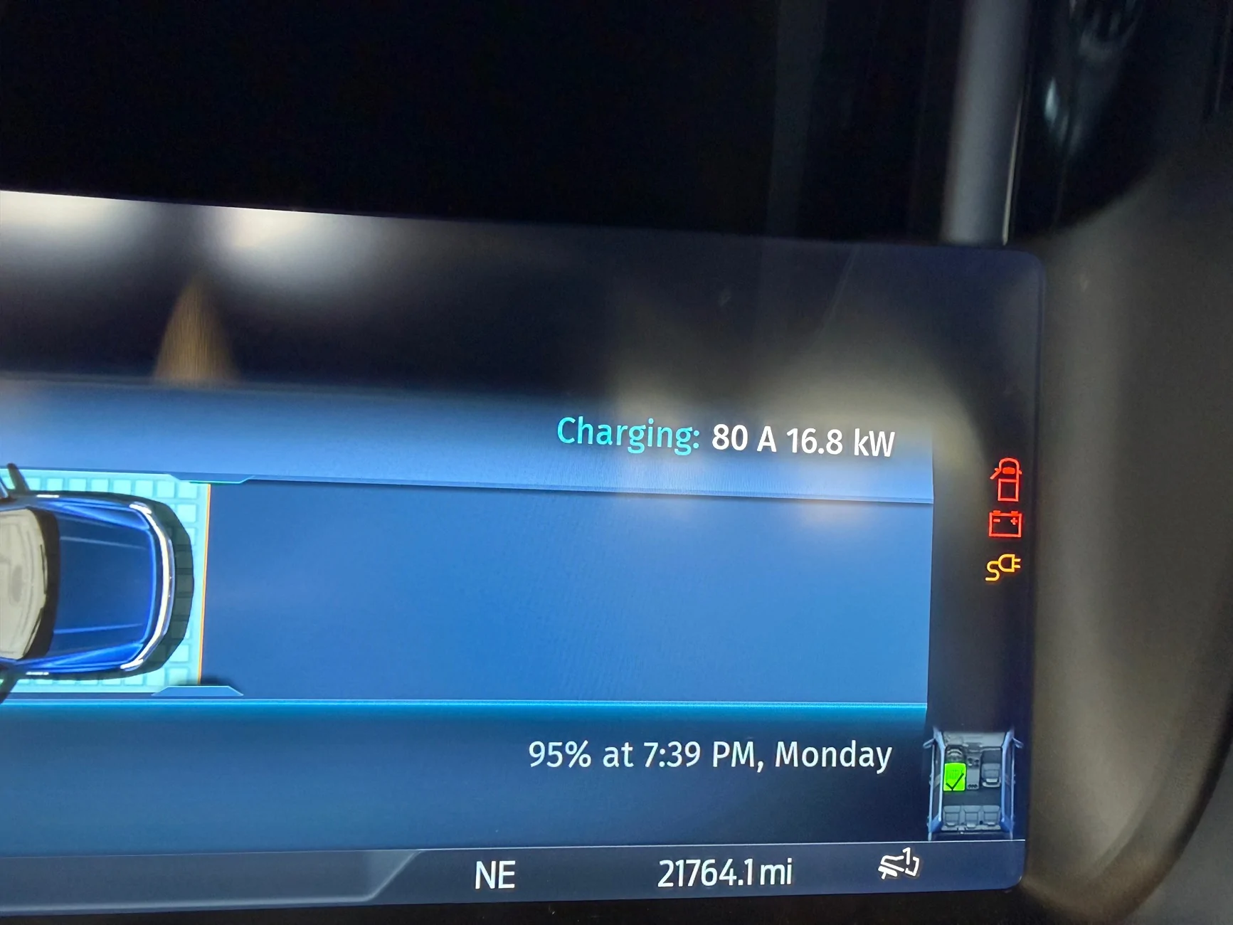

Well I like having it on the dash. Side note free charging at my current work location and a 23 with 80amp charging ain’t too shabby. 😁
PL3A-14C204-JP
Thank you my friend. Once again you save the day. This worked and now I was able to fix those last 2 tweaks. 👍
