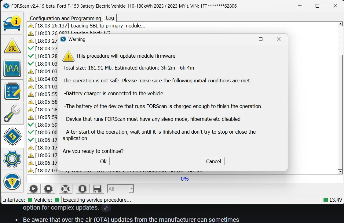

Well got bored tonight. Wish me luck! :crazy:
"The operation is not safe",,, LOL,, it's almost as if they are trying to scare you out of doing MFU :(. Does anyone who has familiarity of FDRS know if these exact same warnings get prompted with FDRS. I've always assumed FORScan just copies everything from FDRS, I'm curious if they added scare tactics to really weed out the less confidents tinkerers?
All that being said, don't be scared. I had a little charger on mine and it failed twice, 2nd time like 3hrs in when my battery got so low the truck started freaking out, lights flickering and all,, I got back from dinner and the batt voltage was 8V,,, Dohhhhhh,,,, All that shit, and it worked on the 3rd try with an 80A automotive roll around charger. Also, let me say, as an electrical engineer, There should be no way to damage anything with failed updates. Since the 90's engineers have figured out how to do checksums and full firmware integrity checks that rely on downloading before ever initiating the actual firmware swap within the processor's memory space. If Ford isn't doing a robust job of this then that is severe negligence on their part. Still we hear about dealers bricking modules and such, it's a bizarre situation we're in with a truck who's manufacturer's strong suite is not software. I'm so glad we have a good community of people curious and willing to push the limits to work on our own shit. I love seeing the overall success of real world owners figuring stuff out. Hack on!

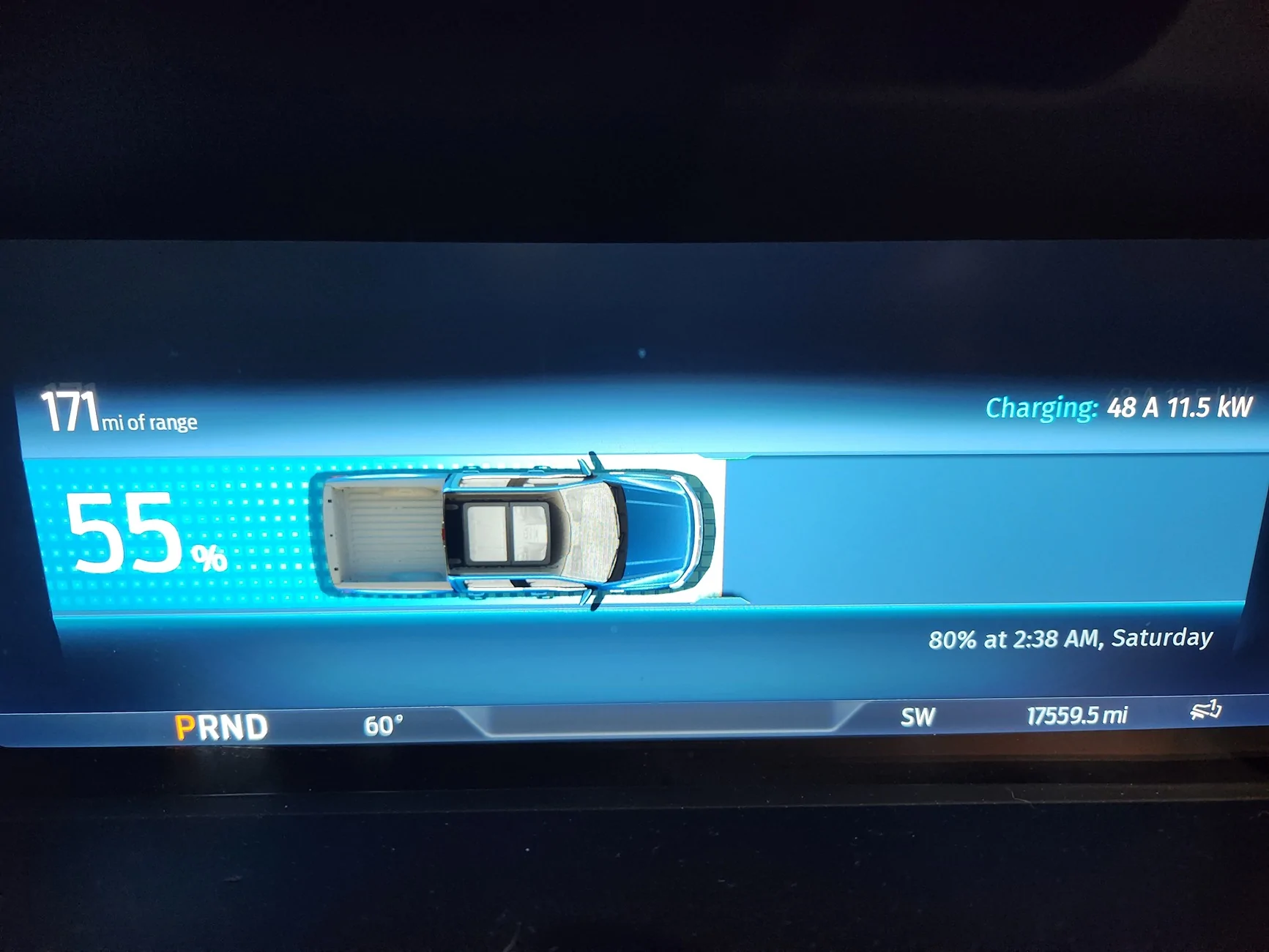

Well took about 5 hours and 20 minutes of angry bumble bees but now have charge rate on IPC. Should be noted that you need the beta Forscan to get the option to update modules. FORScan Software Version 2.4.x Releases and Information, 2.4.19 beta, 2025-09-18 - Ford / Information - CyanLabs Official Community
Power supply pulled 11.5amps from a wall outlet for that whole time and a total of 5.8kWh to keep things happy. Measured 63.5amps going from the charger on my clamp meter. Had a bit of an oh #@# moment after it was done because the dash lit up like a christmas tree and had stop safely now. Took a couple attempts but got all the DTCs cleared except one for the IPC and was able to start/move the truck.
