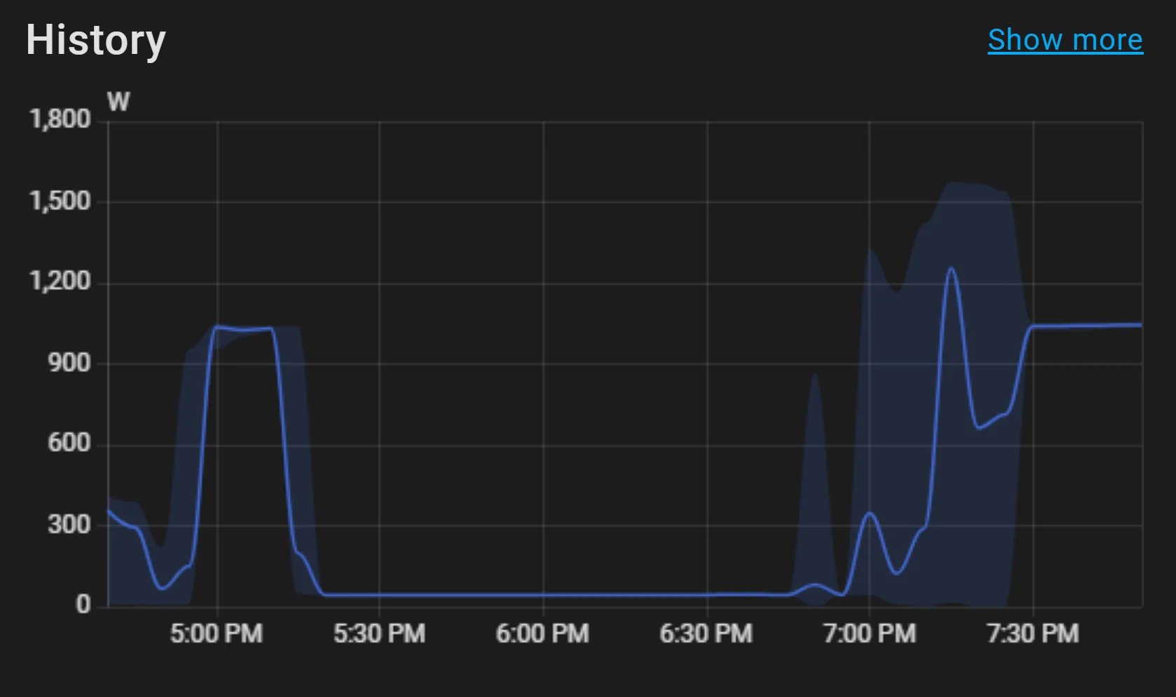

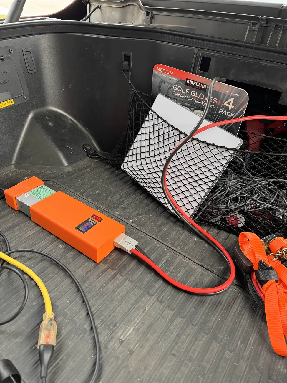

Well, got mine updated last night and it was an adventure lol. Absolutely need to make sure you keep monitoring your power supply throughout. Mine either lost connection or the truck somehow went into battery saver mode and I almost completely smoked my 12v battery down to 5v. In my picture below it shows that I started updating the truck at 5 PM, but didn't realize I was having power issues until 6:30 PM. The update failed and I was really worried I had just turned the truck into a 6500lb paperweight lol. That caused a cascade of other problems because now my power supply was trying to charge the 12v and run the truck when doing the updates and kept tripping its OCP at over 1500w output.
Ended up having to disconnect my 12v battery entirely, run the truck 100% from my power supply and put the 12v on a separate battery tender so I could hopefully revive it. Thankfully with this setup the second attempt at the update went perfectly smooth and my truck was ready to go for the drive to work this morning.
My recommendation to anyone running updates like this one is to use a ground other than the negative 12v battery lug. It really seems like my truck went into battery saver, but I can't say for certain. Once I put my power supply on the negative jumping post in the frunk it held power steady for the entire 6 hours.

yeah it's advised against using the battery itself but can be done. Just have to make sure you're on the right side of the sensor and have a good connection. The locations in the passenger frunk area are more reliable but seems I always break a clip every time I open the darn thing. I need to just add the lugs that poke through the cover like some others have done.
Yep, I'm planning on adding a nice 175a anderson connector to a good ground and right to the DCDC converter output so I can just plug in to a really solid connection and avoid the clamps all together.
