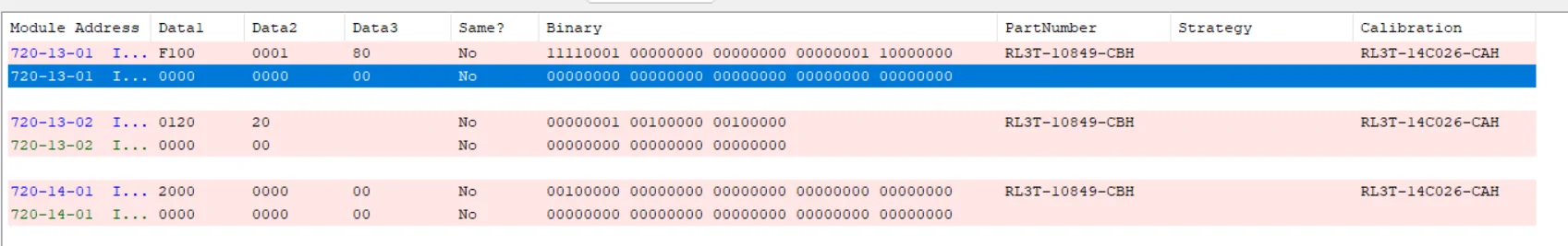

Thanks. I managed to find one on cargurus that was close. I narrowed down the issue to the below 3 addresses. Top entry for each is 2024 AB and bottom is my previous IPC values. Changing any of them results in the incompatible configuration. Now to go poke around livinitup's spreadsheet. edit: looks like all of those are seatbelt related. I already disabled the chime 720-01-01 so not sure if it's related or not.

Good luck. FWIW, your top row Data1-Data3 is consistent with values I see for 24-25 Lariats. And the bottom row is the same as 22-23 Lariats.

yeah I managed to find a 24 Lariat online and pulled the as-built from the motorcraft site to load. Problem came when I tried to restore my config as it would restore those 720-12 and 720-13s and kick out that 2101 code. Managed to narrow down the issue to those by manually updating the different blocks. Below is what I ended up changing from the 2024 ab. Some due to Forscan mods , some due to my specific truck config (e.g. power running boards, etc), and others that are above my paygrade. My truck is a 2023 ER Lariat 511A with trailer brake, power running boards and max tow so others trying may require different changes but seems you should be good to restore a backup as long as you change the 720-12 and 720-13 back to match the 2024 as built.
