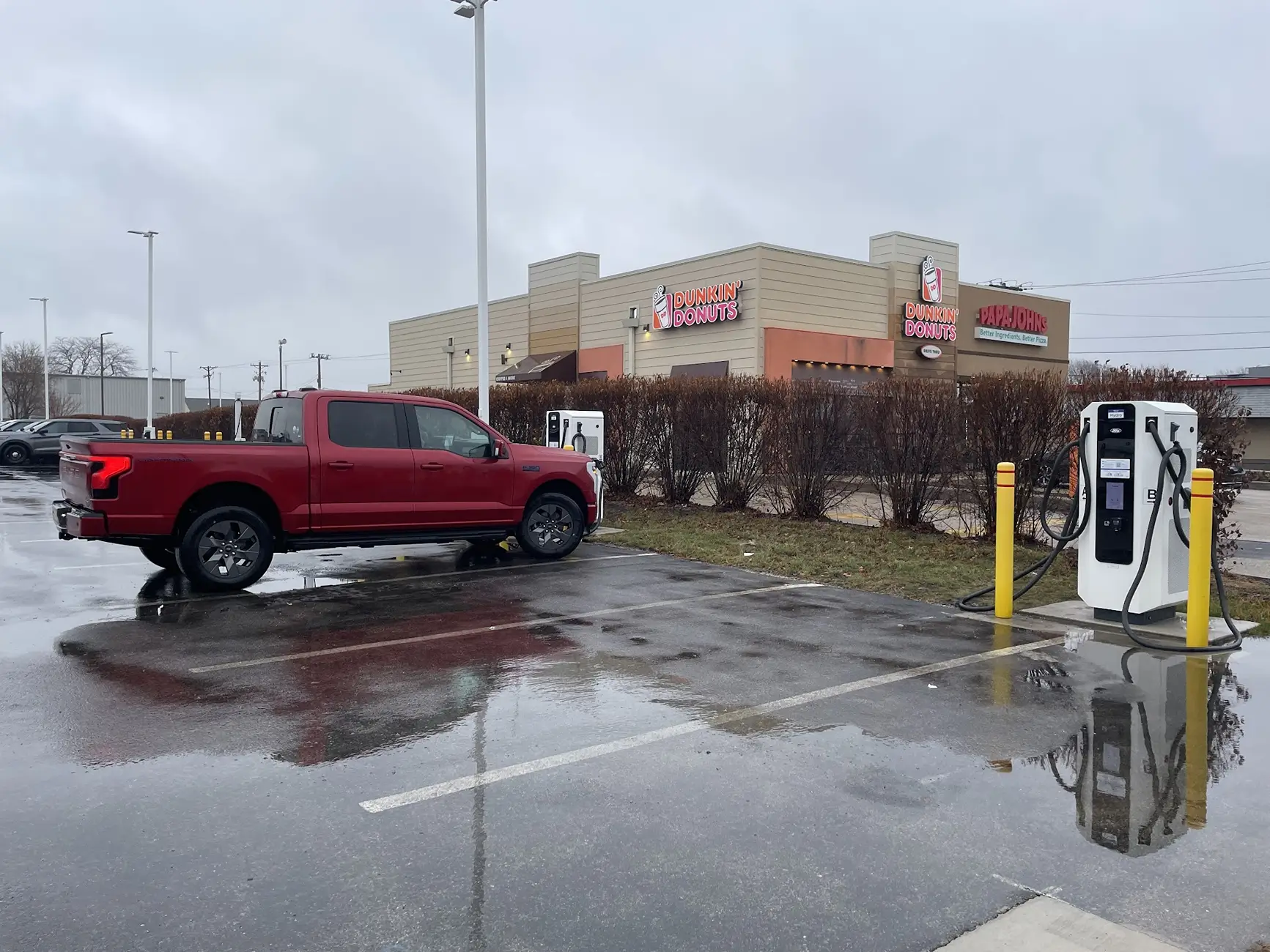

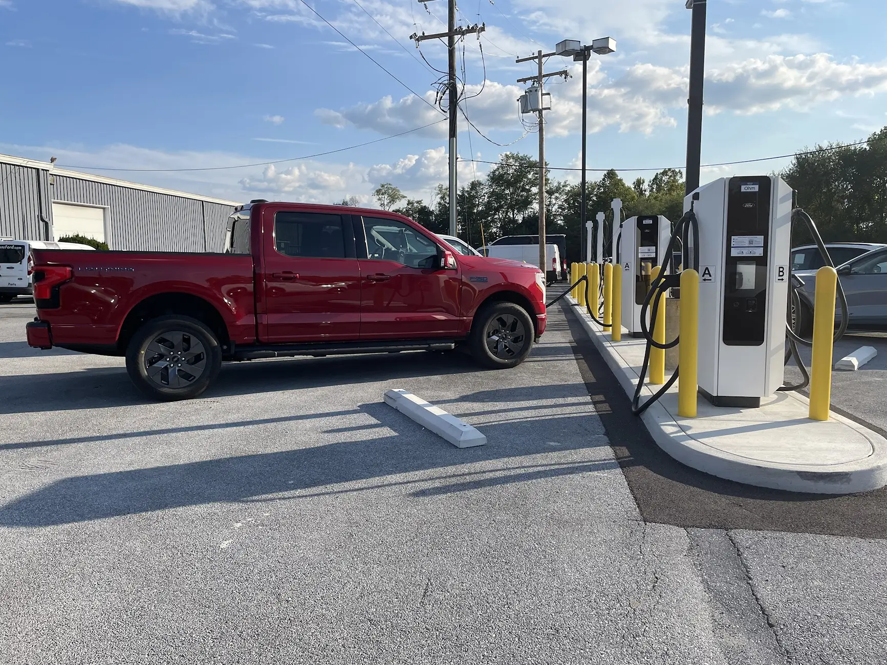

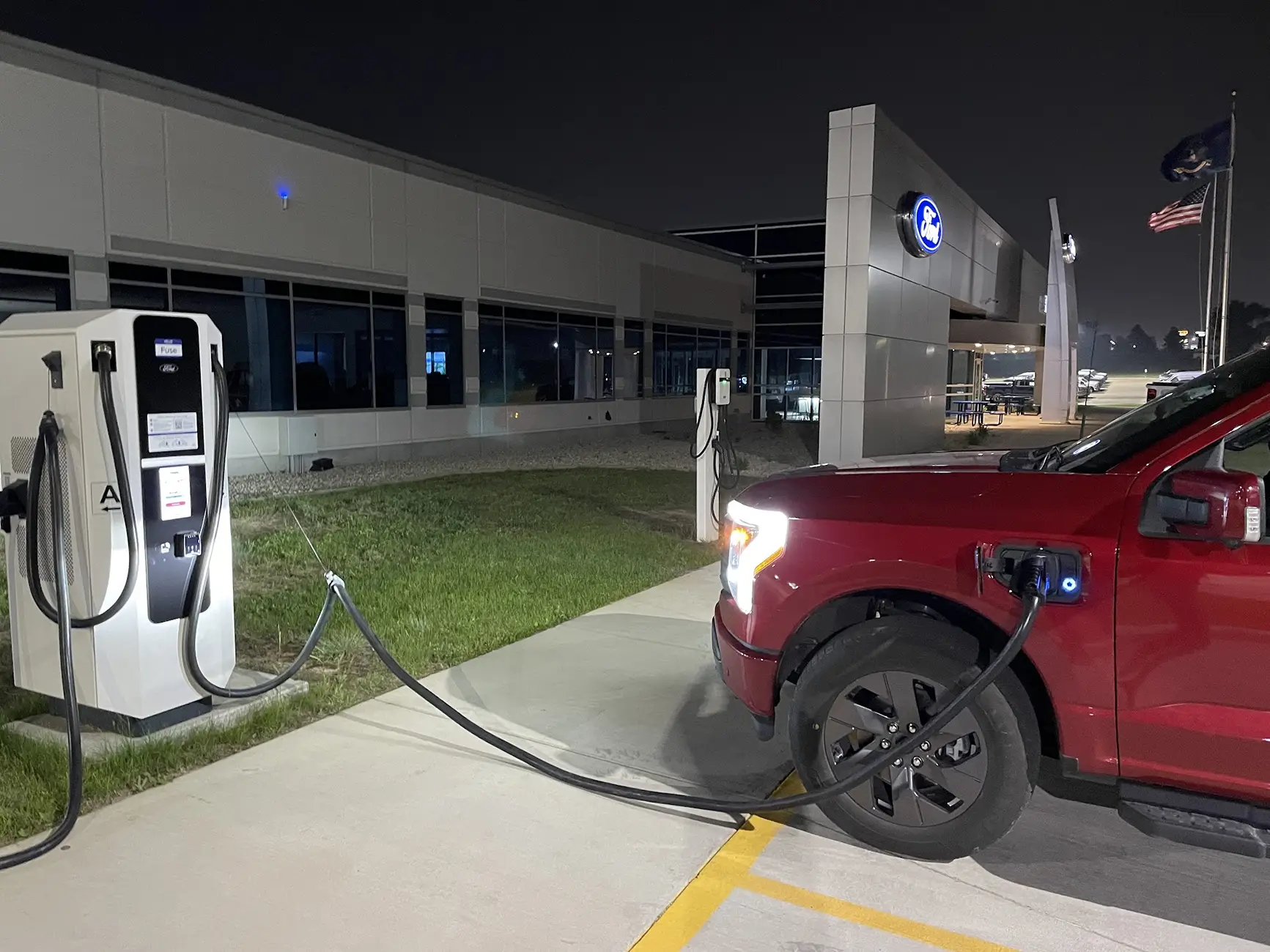

Looking at my charge logs, I've charged with Ford Charge 41 times at dealers in West Virginia, Maryland, Delaware, Pennsylvania, Ohio, Michigan, Illinois, Wisconsin, and North Dakota. I wouldn't write them off. Especially now with Plug & Charge.
Sometimes there's amenities just a step away:
Ford F-150 Lightning EV Connect at Ford dealership 1779311049893-9
Or a oasis in West Virginia:
Ford F-150 Lightning EV Connect at Ford dealership 1779311060754-x
Or cheaper than the Tesla down the street:
Ford F-150 Lightning EV Connect at Ford dealership 1779311037723-m0
