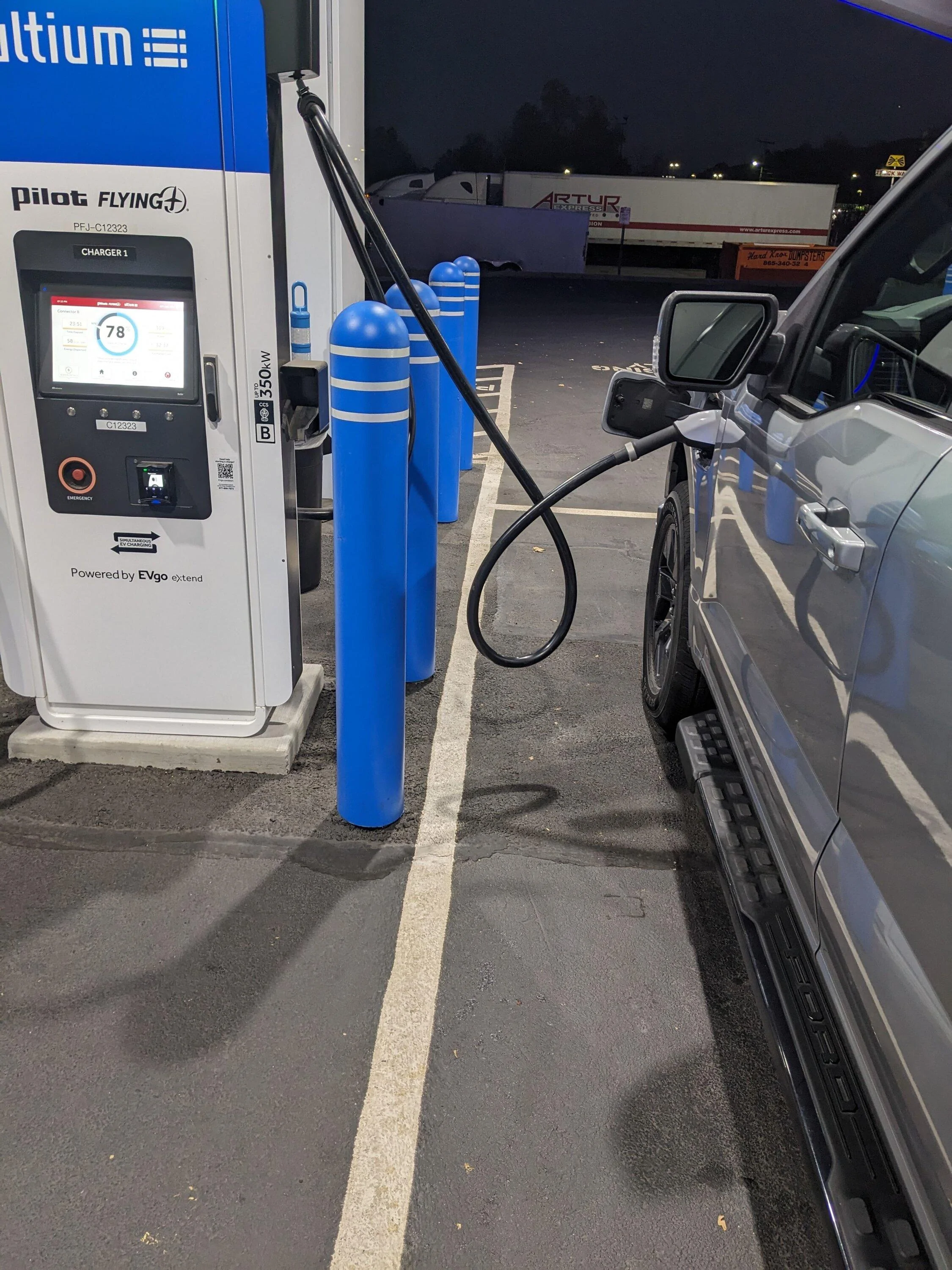

Used Autocharge+ and one of the new Ultium chargers for the first time tonight. It was such a seamless experience. The location was great too, had a canopy, trash cans, and wide spaces. If this is the future count me in!
Ford F-150 Lightning EVGo adds Lightning to AutoCharge + Plug and Charge PXL_20231103_231032934_Original
