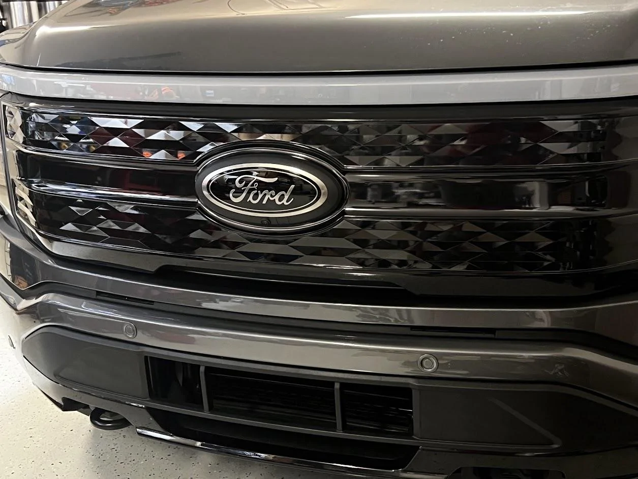

What if I just want black emblems front and back? I don't need it to light up. What are my options?
You can buy vinyl overlays, take the ones currently on your truck apart and paint them, buy them already painted off eBay or just use Plasti-Dip on them.
I tried vinyl overlays once. I thought they looked cheap. Plasti-Dip is inexpensive, and if you don't like it you can peel it off. No harm, no foul. Painting them yourself is time consuming, but doable. And buying them already painted could be expensive.

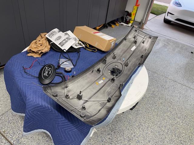

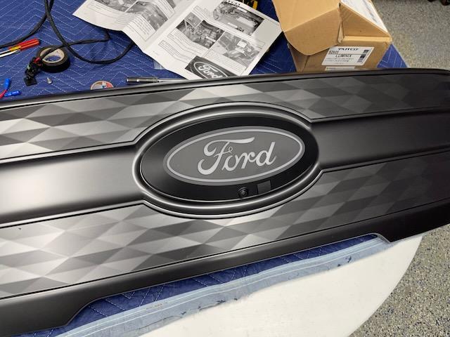

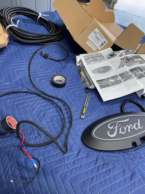

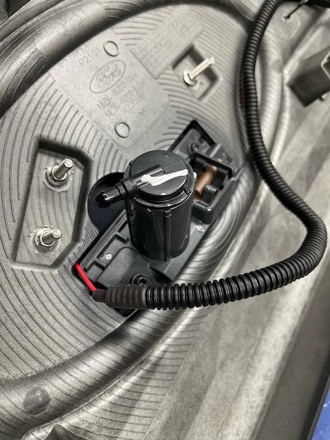

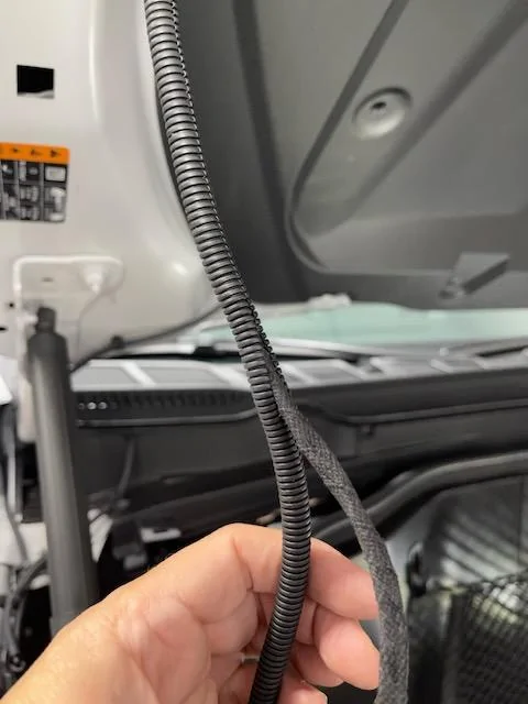

Another on installed... Super Simple. I did not disassemble as much... just popped off the grill... took it to the bench, did the emblem swap. Hardest part is swapping that cover on the camera washer (I need smaller fingers!). Cloth taped all the wires, and ran inside flex loom. Used F22 fuse.
Works great!
I did use my Dremel and sand out a little arc in the fuse box lid... made room for the wire tap. Snaps shut great now. Reassembled and it looks OEM as can be!
This may be what you're looking for.
I did this for the front of my Carbonized Gray Platinum..Also, love your Matte finish and updates. Looking forward to seeing the wheels!
https://accessories.ford.com/produc...rear-chrome-black-ford-oval-emblem-w-camera-1
Unfortunately the rear only fits the Pro and XLT, but the front looks good.

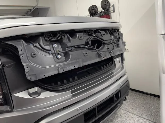

Ok folks.. here is the video of radio reception, with the emblem lit, on fuse F22, then another with the fuse pulled.
And a couple pictures of where its installed, and the ground location
WOW, this is amazing... I just pulled the plug and observed the EXACT same difference. Hmmmm... wonder what we can do to resolve this? Does the power cable running from the emblem need to be shielded? Hmmmm. That wire goes right by the antenna for sure. Maybe change the ground location??? sharing the same as the antenna system?
I'm gonna try some crazy foil wrapping that cable just to see if it changes anything.
