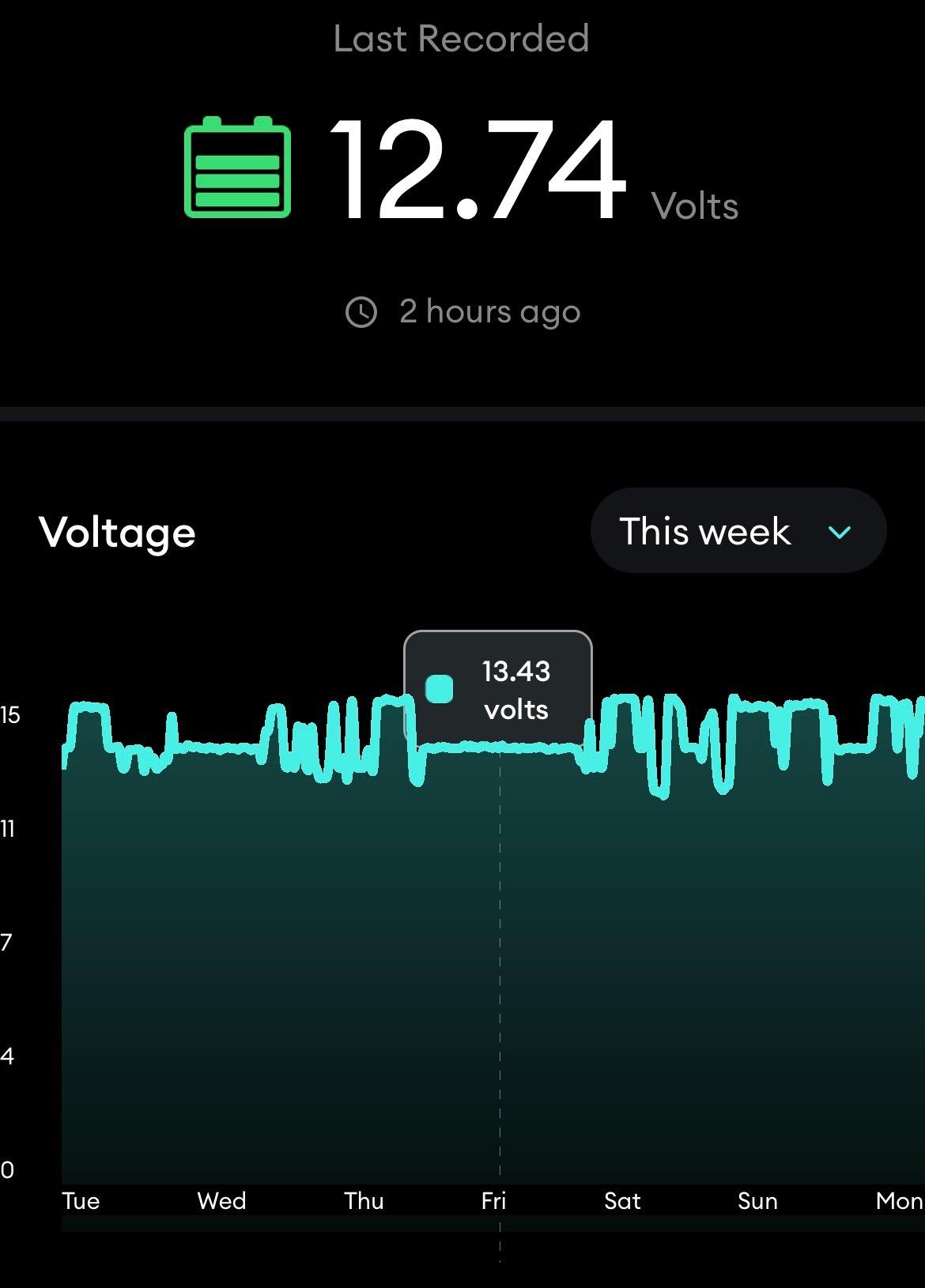

That doesn't make much sense. Any 12v car accessory should be able to handle voltage at least up to 15. When an alternator is running in a ICE vehicle there is 14.5 volts generally on the 12V circuit.
I've noticed the lightning battery is generally in the 13.5 range..

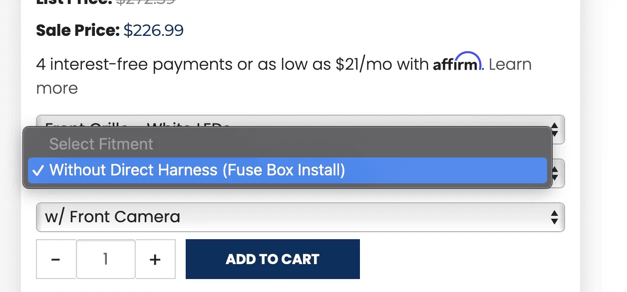

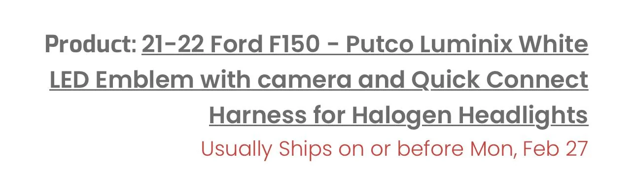

Putco has updated their web site showing a direct plug into the headlight option along with pictures. There is information on having to select which headlight type you have. However if you try to add it to your cart the only option you can choose from the selection is the option "without direct harness / wire to the fuse box". So it looks like they have an option coming, but may not be sourced with the parts/wiring harness yet or OOS.

I just ordered mine a week ago as I just got my truck. They said this is for ICE only and doesn't work with Lightning and they have none planned/coming any time soon for Lightning. I'm a bit bummed I didn't see this thread before hand especially seeing complaints about radio reception now.

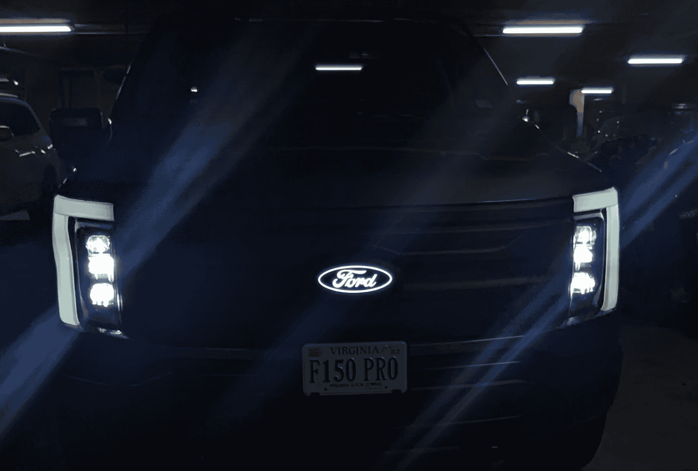

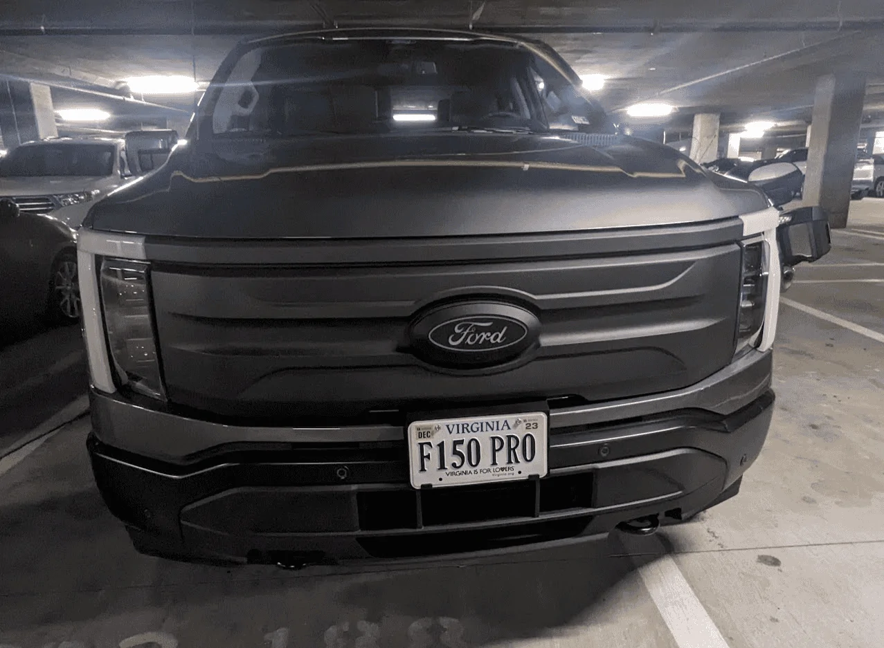

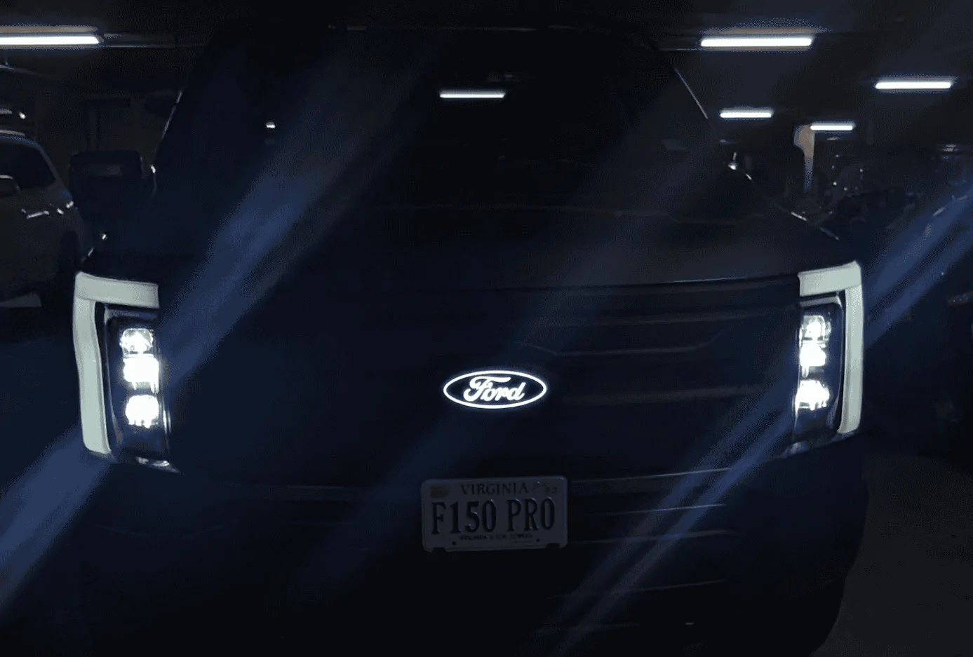

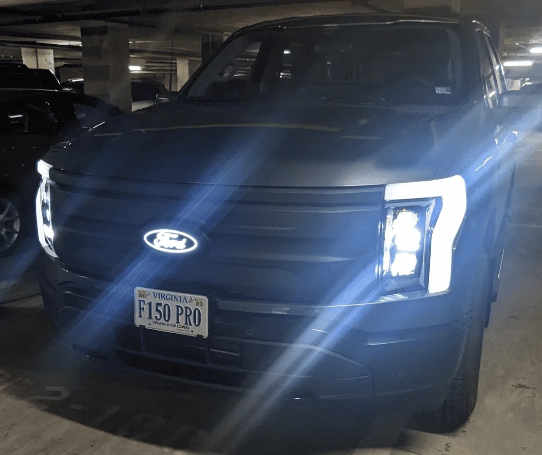

Got it installed on my Pro this morning. I really like the look. No issues with my radio as far as I can tell. At least on the radio stations I listen to all the time.
