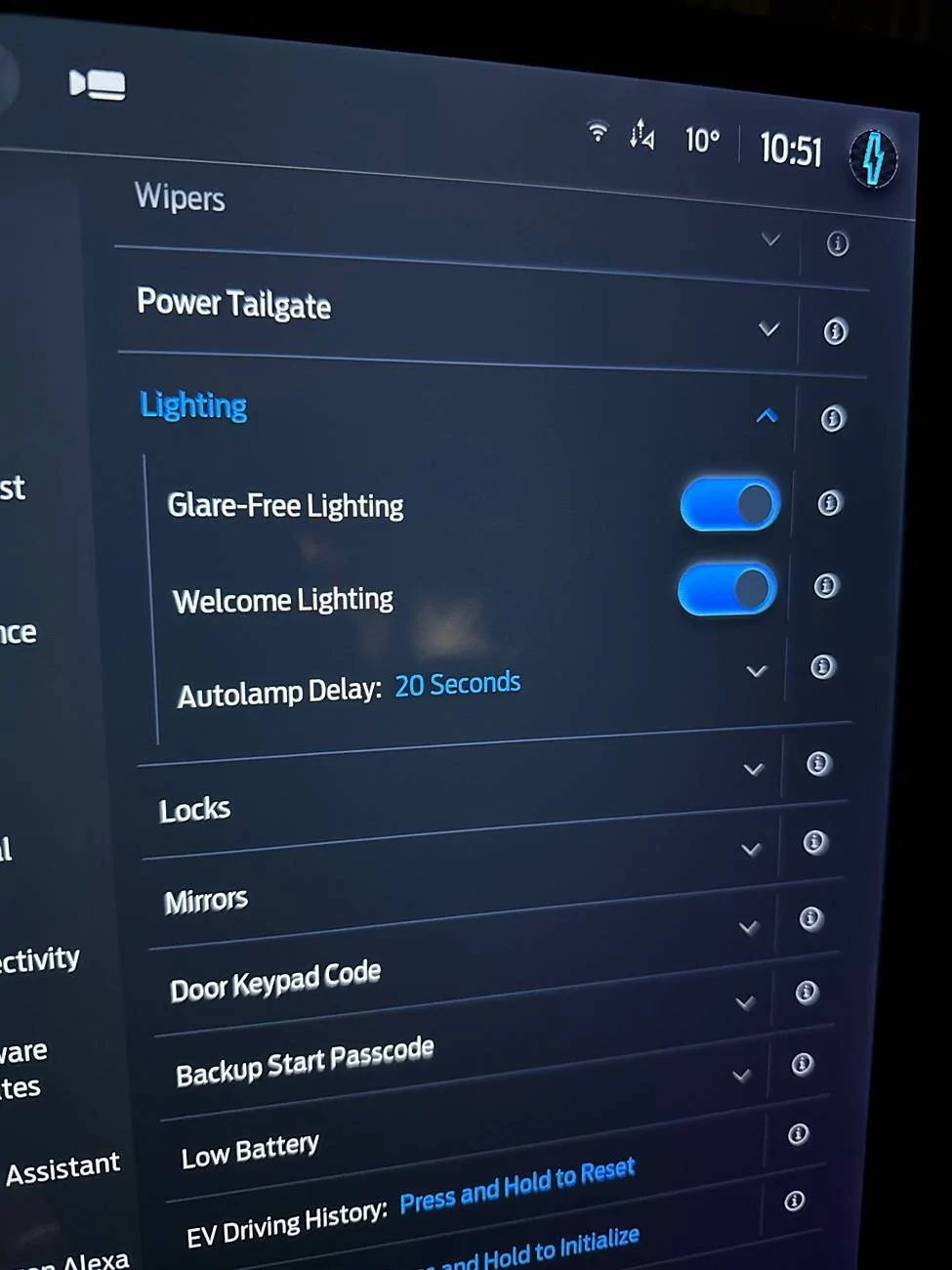

I’m trying to get glare free headlights to work but the section where you can set the direction of traffic is not there. This is all I got. Or is this how it’s suppose to look
I don’t know what you mean by direction of traffic. Do you mean driving on the left?
That pic you have matches mine except that in the US we also have a toggle to disable Daytime Running Lights.
Ya I saw some people have a setting for driving on the left or right. I’m in Canada.
yeah. Can't find the post but I also recall seeing someone with the setting. Must be some flag in FORScan somewhere.

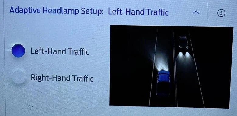

Ya I was double checking all my changes and everything seems good. I even went for a drive. The high beams do turn on in low light conditions but there was no passing cars to see if the would move or dim. Whatever it’s suppose to do lol. With glare free you can’t even tell they have turned the high beams on. It gradually turns them on which is cool. The auto high beams would just turn on. It’s weird though, I thought Canadian trucks were suppose to come with it already activated.
3,146
4,519
A member entered a wrong setting during configuration and turned that setting on. See his post earlier in this thread. There are other settings in FORScan to configure RH or LH drive. This would be done by Ford when shipping to other countries as needed.
