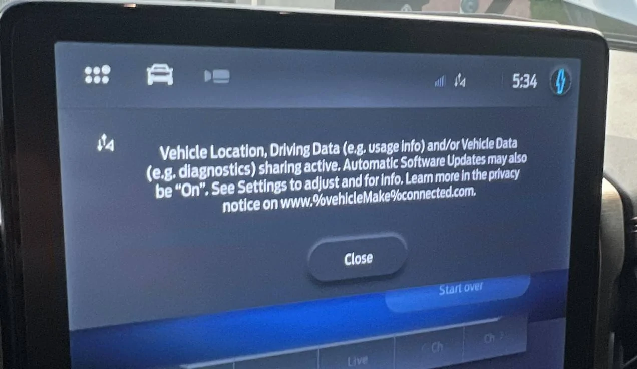

FORScan questions:
1. I know we cannot force Sport mode permanently via programming but is there a way to extend the "resume Sport" timer? I find if I'm doing anything other than full front display focus, I tend to miss it then have to go into settings.
2. Is there a way to disable this Vehicle Location, Driving Data popup from coming on-screen?
Ford F-150 Lightning F150 Lightning FORScan thread - Version 2 Disable_This
3,172
4,576
FORScan questions:
1. I don't recall anyone figuring Sport Mode timer out. I know there isn't a way to have it in stay in Sport.
2. I see the Privacy Notice only occasionally - are you getting it a lot?
Also like they want you to learn more at www.%vehicleMake%connected.com. Not typical for %vehicleMake% to make software mistakes like that. /s
