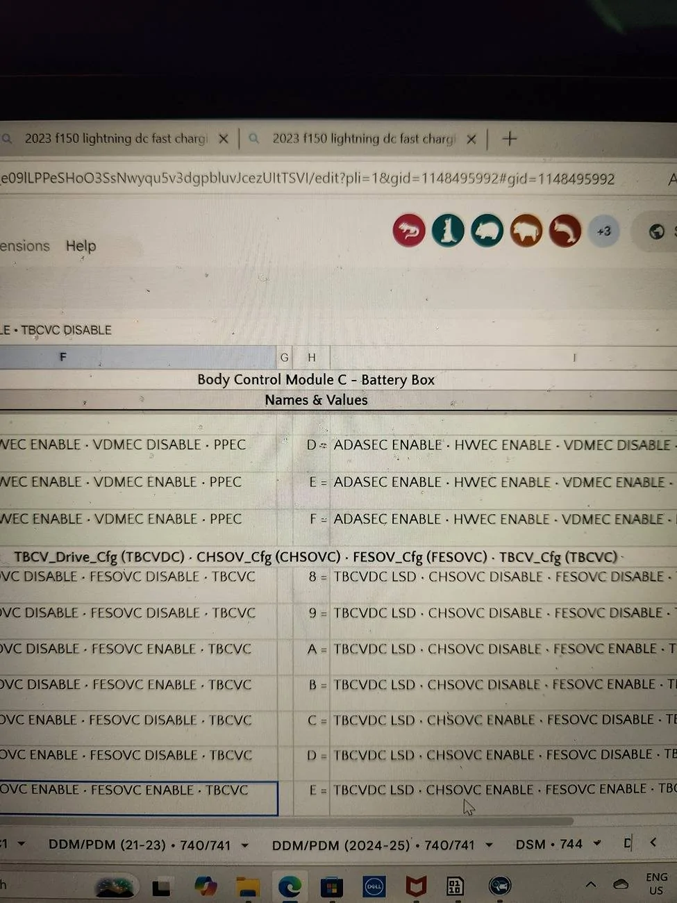

I need help with the options on the forscan spreadsheet if there is any way to understand the full name options for example FESOV interested body control module C, I'm trying fix my truck affter I corrupt the as bulit file
FEVSOV=front evaporator shutoff valve.
I figured that out by Googling "Ford fesov."
You might get further by comparing your as-built to one that isn't corrupted. What exactly did you do to screw it up?

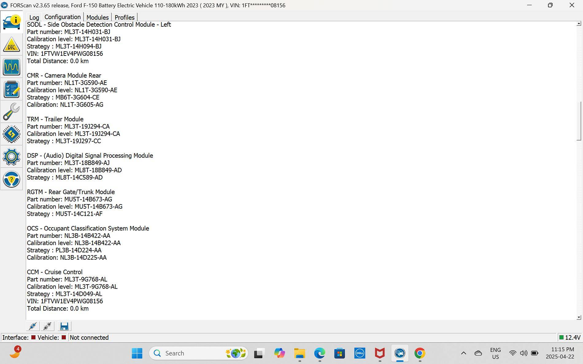

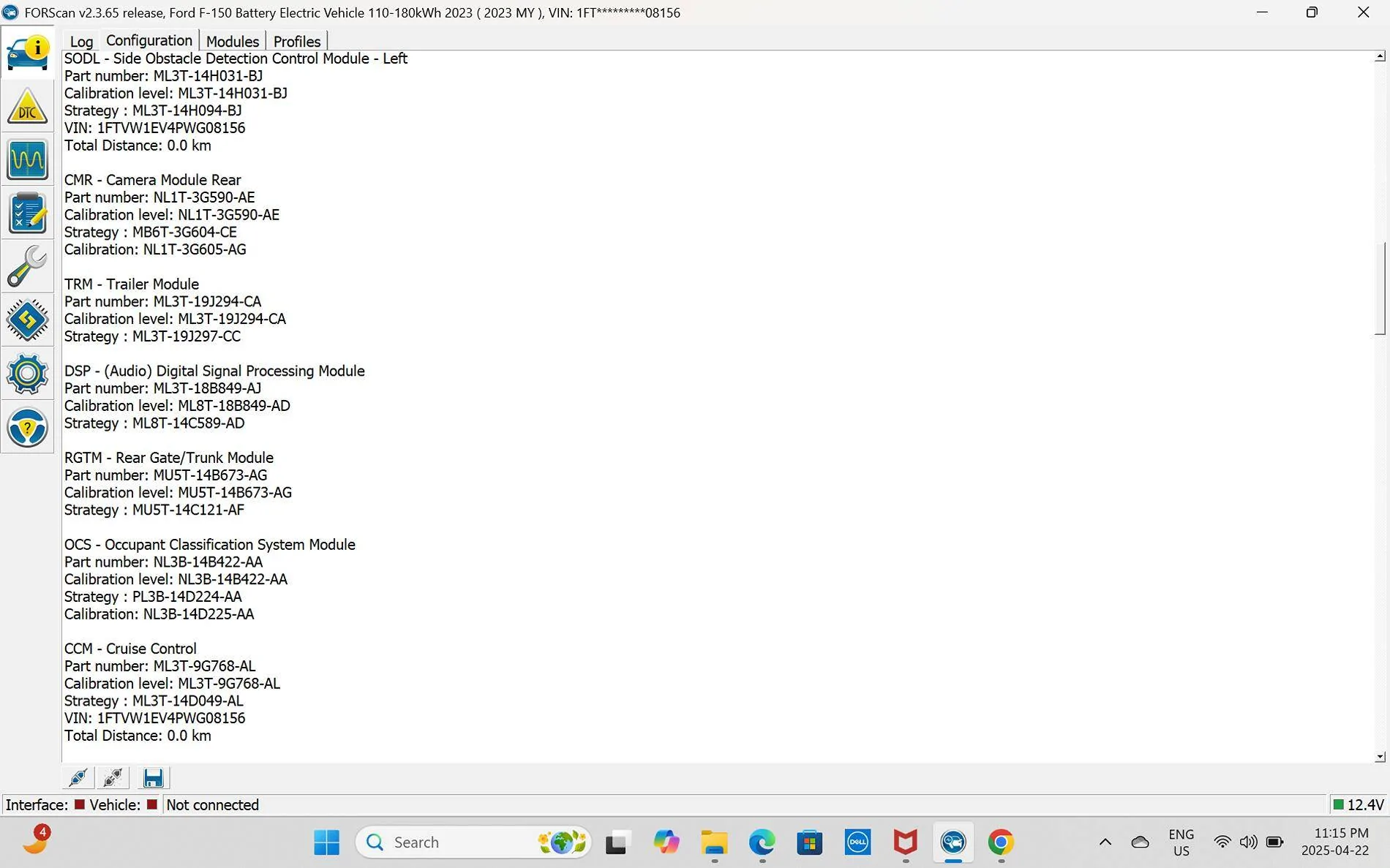

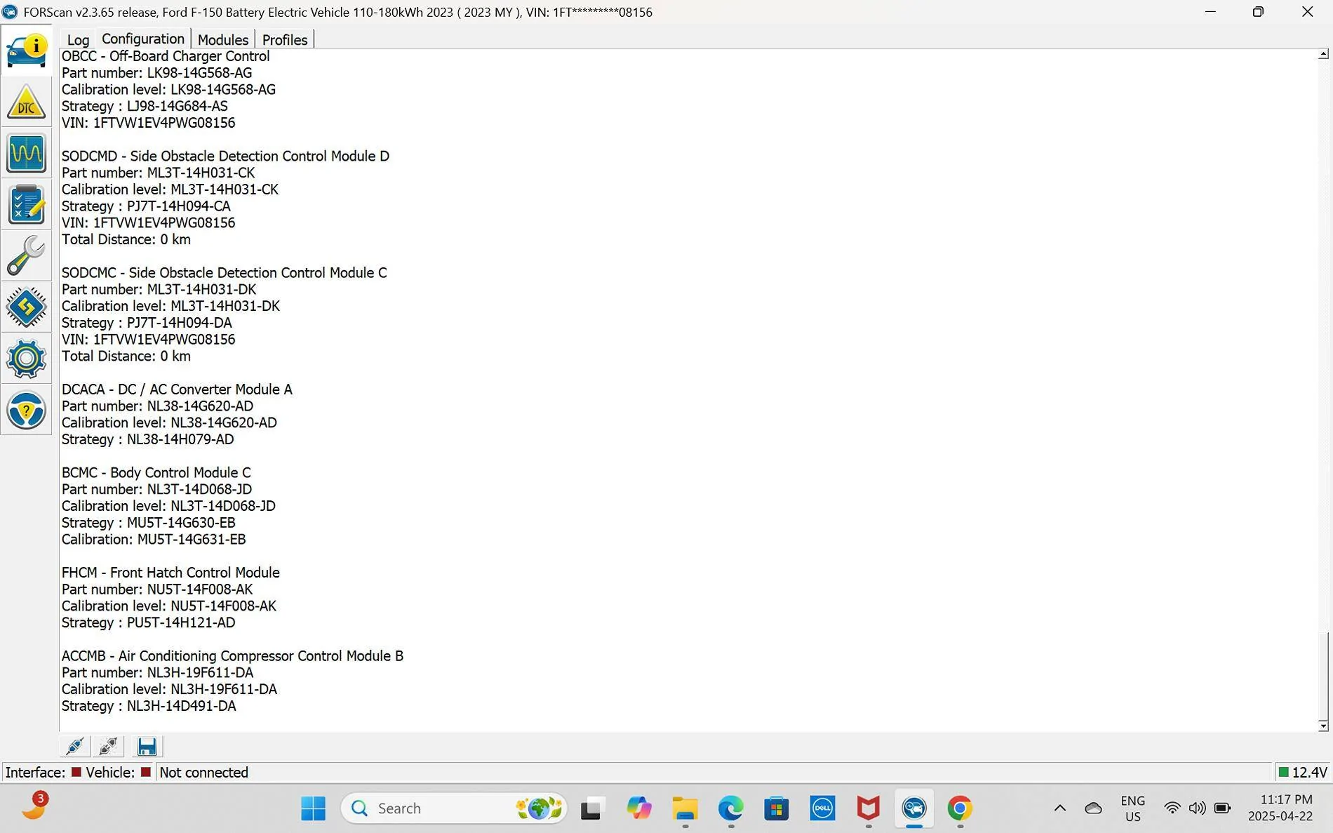

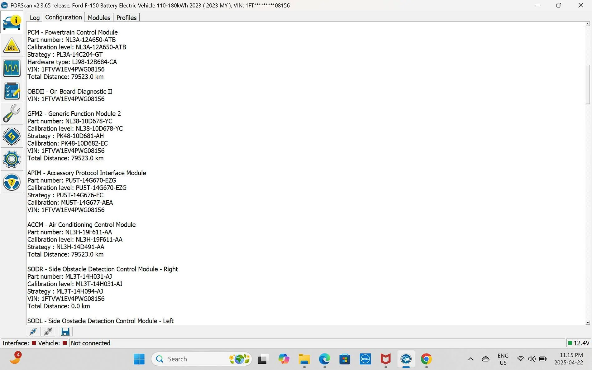

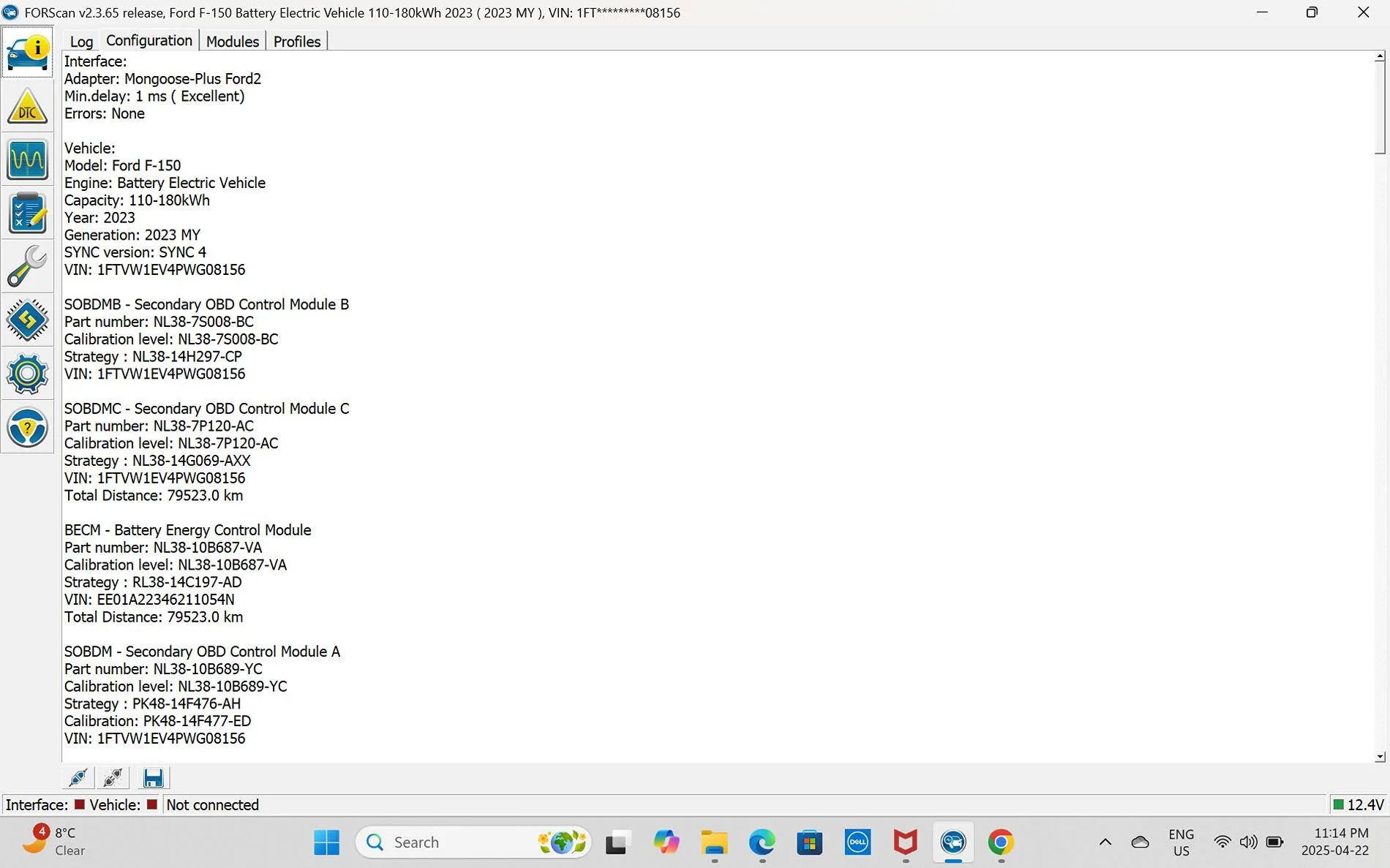

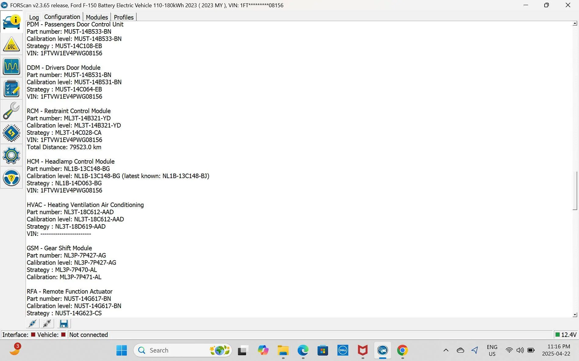

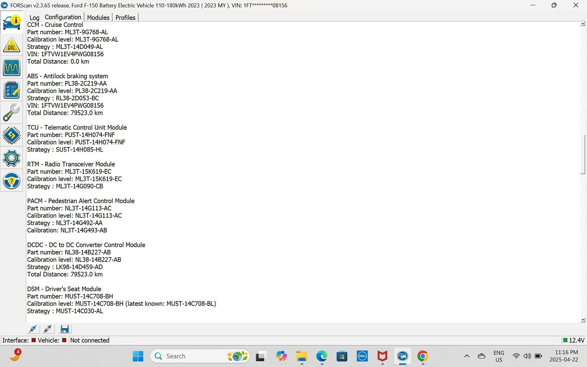

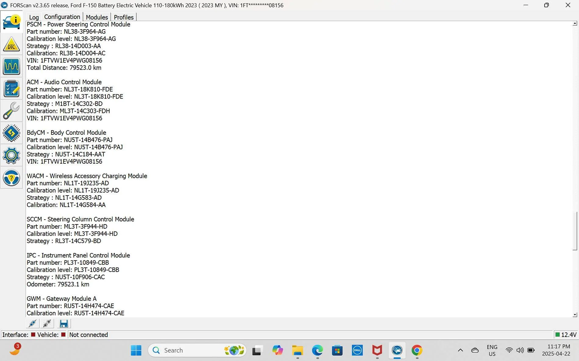

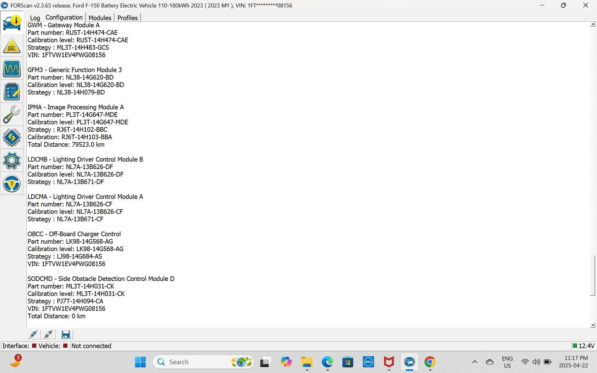

No my friend it is corrupt this is my truck bult
2023 f150 511A ER with Max trailer tow package.
275/60R-20
onboard scale and advance security package removed
My Kids accidently delated my backup last year i tried to recover it but it is in json file

I noticed you're using a Mongoose. Wouldn't it be easier to fire up FDRS and write the config to the affected modules directly from Ford?
