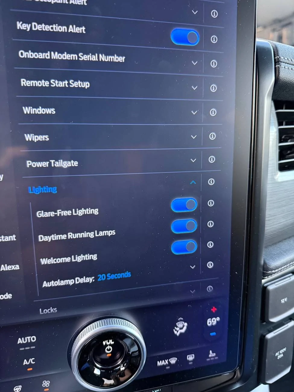

I just had a really peculiar thing happen on forscan. I went through the whole process of saving the asbuilt files, changing the codes (from this forum) for the glare-free lighting, restarting the truck, and nothing. Went through and checked my work, couldn't find any errors. Restarted the truck a few more times. Decided it was best to put back all the original codes and restarted the truck. BAM, the glare-free toggle showed up. I will check it in the morning to see if it went back to match the original codes but it was frustrating.
3,243
4,714
The notes on that mod specifically state that it may take a couple of restarts to take effect. Others have reported the same thing you noticed. There may also be a time element between the restarts, i.e, leave the truck off for a period of time.
