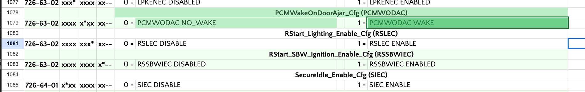

Checking these settings now on the BCM

If you enabled and turned on Silent mode you killed that animation. You should have a toggle on screen now. Turn silent mode off and see what you get
There are the changes for Silent mode:
Enable Silent Mode (AKA campground / dark mode)
Creates a SYNC toggle to turn on/off Silent Mode. Silent Mode turns off cluster lighting, welcome lighting, courtesy lights, and SYNC screen when opening doors; also silences the horn when locking doors. See this post for more info, pics, and how to enable using easy mode.
BCM 726-25-02 0101 0101 01--
BCM 726-28-02 01xx xxxx xx--
APIM 7D0-09-02 *xxx xxxx xx-- if C, change to D. If E, change to F.
