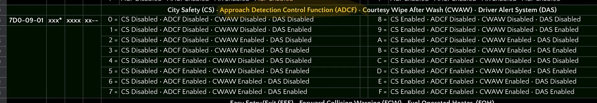

I played around a bit and was able to enable Approach/Welcome Lighting on my Flash. In the BdyCM easy mode, I enabled all of the Approach Detection options and set BdyCM 726-45-01 to xxxx xxxx x1--. The toggle is still not present in the Lighting menu, but the feature is functional.
There should be a setting in the APIM to enable the toggle. That’s probably all you’re missing.
Maybe check this setting.

That was it. I changed mine from xxx3 to xxx7 and now the Welcome Lighting toggle is available.
So this appears to be unique to Job 2 2025 Flash. I have a database of 100 Lightning As-Builts. Approach Lighting is enabled for 24-25 Flash except the 2025 Job 2 Flash with the 123 kWh battery (8th character of VIN is "U").
Enabled: 22-23 XLT 312A. all Lariat and Plat, 24-25 Flash w/131 kWh battery
Not enabled: All Pros and XLT 311A, 2025 Job 2 Flash.
