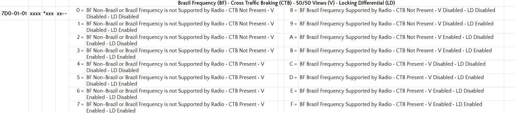

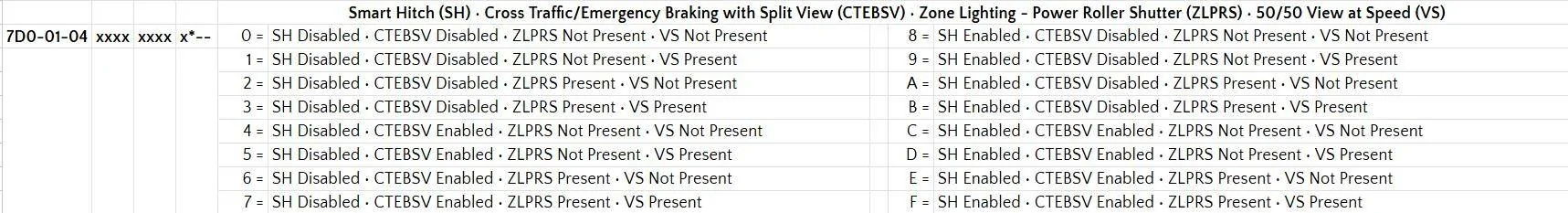

The side cameras are viewable while moving with the 50/50 enabled.
I have a 2023 so ymmv but below are the changes I made along with my factory values. If yours are different then the updated value will change. You're basically enabling 50/50 views for the APIM values. I also have Cameras At Speed enabled and the Full View Not Available box removed.
APIM 7D0-01-01 xxxx *xxx xx-- 3 (factory setting 1)
APIM 7D0-01-04 xxxx xxxx x*-- 1 (factory setting 0)
@bmwhitetx, this mod is worth putting in the first post. 50/50 View and 50/50 View at speed. You definitely need to reference @Livnitup spreadsheet to make sure you keep current options.
So I checked my database of F-150's and here's what I found:
for APIM 7D0-01-01 xxxx *xxx xx--
All '22 and '23 Lightnings have a 1 there so they would change to a 3
All 24's Lightnings have have a 3 there already so no action needed.
for APIM 7D0-01-04 xxxx xxxx x*--
All '22 and '23 Lightnings have a 0 or an 8 (Smart Hitch) there so they would add 1 to make it a 1 or 9
All 24's Lightnings have have a 9 there already so no action needed.
So it looks like 24's should already have this feature. I'll add it to post 1 and take pics once I test on my truck - when it warms up!
Note ICE vehicles have completely different values so they should not follow this advice.

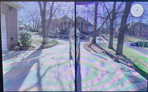

Added the changes to enable the 50/50 camera view button to post 1. Thanks to @PJnc284 .
Note this is for 2022 and 2023's. I believe 2024's should already have this view.
Here is a pic of the button that gets added before and after:
Ford F-150 Lightning F150 Lightning FORScan thread - Version 2 1737581028083-wo
Ford F-150 Lightning F150 Lightning FORScan thread - Version 2 1737580902563-ax
And the new view (will try to get this while actually on a highway):
Ford F-150 Lightning F150 Lightning FORScan thread - Version 2 1737581107760-rl

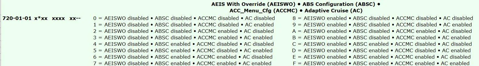

Here's one from the original thread from @dingmah that wasn't put on the master list. Whenever you start your truck, the Vehicle Power Down Timer is always enabled. This shuts the truck off after 30 minutes.
Ford F-150 Lightning F150 Lightning FORScan thread - Version 2 1737588820590-zi
This mod will default that toggle to Off on start. Can be useful if you are using Pro Power or doing FDRS programming a lot.
Clearly you want to use this with caution. If you leave your truck on and in Park accidentally, it will stay on presumably until the battery dies. You can set a reserve when you turn Pro Power on but doubtful that applies when the truck is just on and Pro Power is off (let me know if otherwise and I'll edit).
IPC 720-01-01 x*xx xxxx xx if F then change to 7, if C change to 4.
Note that 2022-2024 Lightnings with ACC will have a "F" and trucks without ACC will have a "C". As always, let me know if you see something different.
Ford F-150 Lightning F150 Lightning FORScan thread - Version 2 1737594970795-ud
