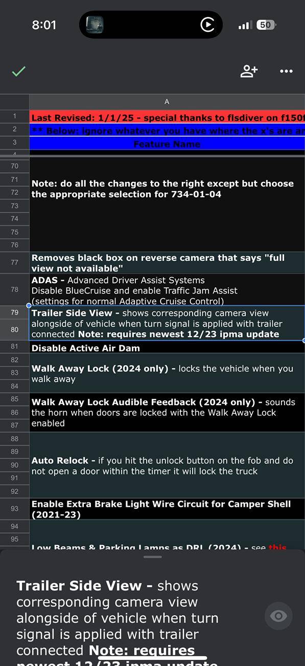

Does anyone have trailer side view working?

I do. Love it!
Thanks I have added this to post 1. This should not be needed on 2024+ since it appears they already have this enabled.
NOTE: This is one of those that it is important to know what you are doing. Livinitup's spreadsheet just says
IPMA 706-01-02 3xxx xxxx xx--
APIM 7D0-02-03 xxxx x8xx xx-- adds Trailer Side View toggle under Driver Assistance
But that is for ICE F-150's. Our trucks have additional/different features. And blindly putting in these values can disable some of those features. I always research the actual spreadsheet and provide Lightning specific values in post 1.

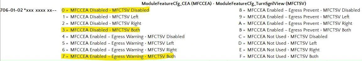

For example changing IPMA 706-01-02 first value from a 0 to a 3 does enable trailer view (MFCTSV Both) and is appropriate for 2022-2023. But 2024's have a 7 there not a 0. This means trailer view is already enabled AND so is CEA Egress Warning. So if you change it from 7 to 3, you disable CEA Egress warning (whatever that is).

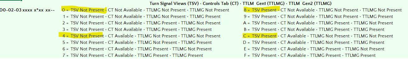

Same with APIM. Looking at vehicles, they have a 0,4,8 or C in that position depending on year, trim, ICE or not. 8 or C already has the Sync feature enabled, 0 or 4 do not. But the difference between 0 and 4 is that 4 enables Controls Tab. This is your Drive Modes screen (Normal, Sport, Tow/Haul, etc.). That is why you read some folks loose their Drive Modes selection on the Sync Screen. It's because they changed this value to an 8 instead of an C by blindly following ICE advice.

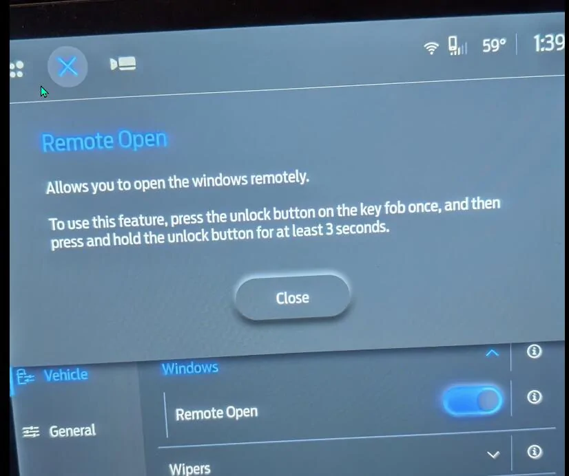

Global window open/close using keyfob: only works on the front windows because one-touch is not enabled in the back windows.
Just sharing, this is an option in the menu on my 2024 Flash now.

This is my Sync screen with no Forscan changes made.
