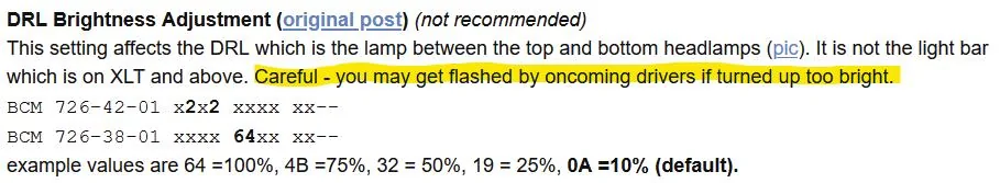

Why are we saying (not recommended) for the DRL brightness adjustment?
PJnc284
Sep 30, 2024
1,226
1,396
Garner, NC
Some have noted recently that they were getting flashed more by oncoming drivers after they had increased the DRL brightness. I never did see any difference in any of the lights between the default 10% or changing it to 100%.
3,209
4,647
Because they become too bright and many folks who made the change said other drivers were flashing them and so reversed the change or lowered to 25%. It looks like you have your brights on. Posts 6-22.
astrand1
Alex
Dec 16, 2021
774
822
Studio truck driver
Ahh that makes sense. We should maybe clarify that in the description. I’ve not tried it yet.

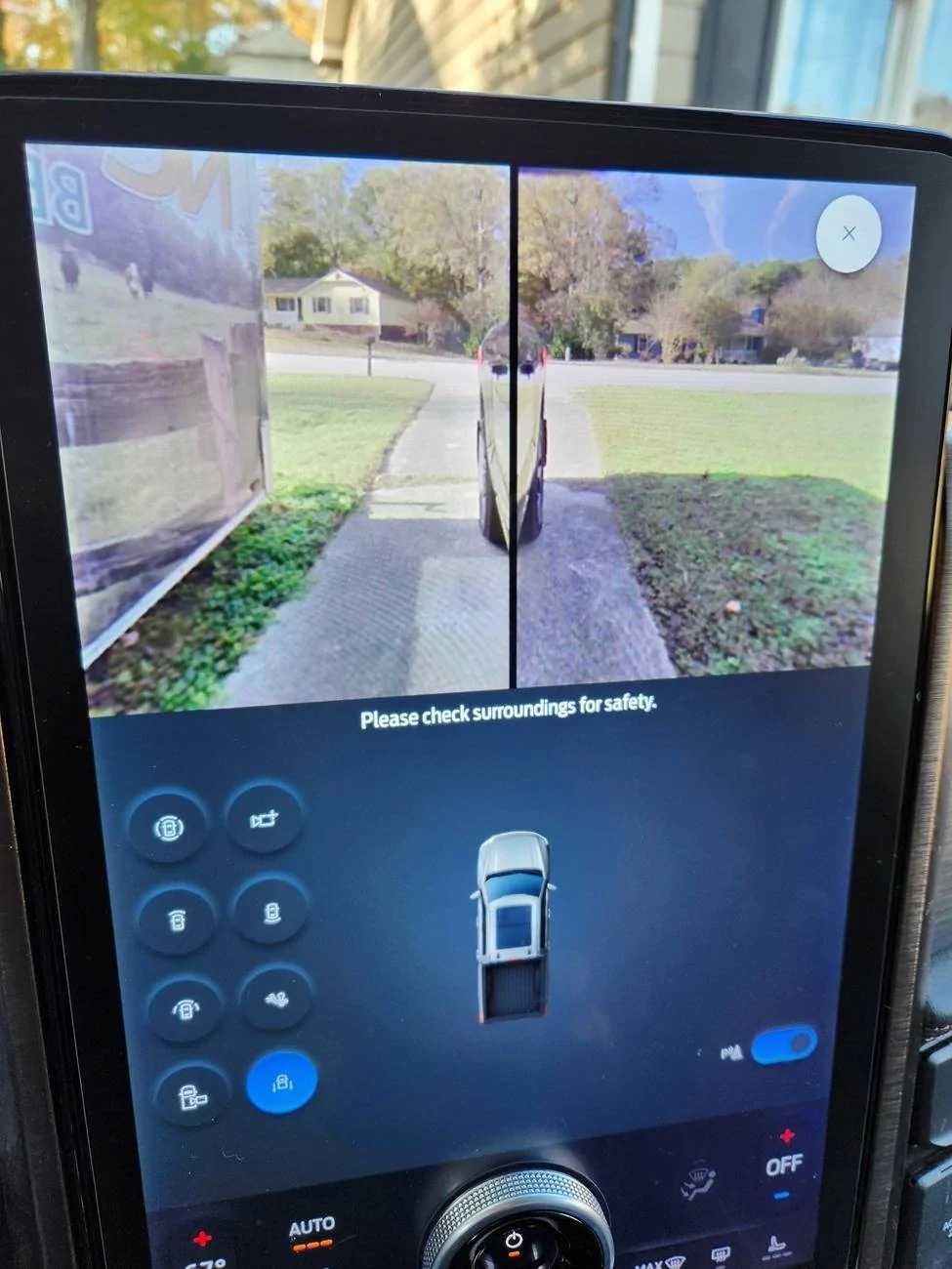

Do you get the extra camera options while driving if you do the turn signal camera mod?
The side cameras are viewable while moving with the 50/50 enabled.
This would be great to have until Ford gives us turn signal cams without a trailer. Do you have the Forscan codes to enable 50/50 view? I couldn't find them specific to Lightnings.
I have a 2023 so ymmv but below are the changes I made along with my factory values. If yours are different then the updated value will change. You're basically enabling 50/50 views for the APIM values. I also have Cameras At Speed enabled and the Full View Not Available box removed.
APIM 7D0-01-01 xxxx *xxx xx-- 3 (factory setting 1)
APIM 7D0-01-04 xxxx xxxx x*-- 1 (factory setting 0)
Ford F-150 Lightning F150 Lightning FORScan thread - Version 2 1737425440431-9y
Ford F-150 Lightning F150 Lightning FORScan thread - Version 2 1737425281788-5i

@bmwhitetx, this mod is worth putting in the first post. 50/50 View and 50/50 View at speed. You definitely need to reference @Livnitup spreadsheet to make sure you keep current options.
Ford F-150 Lightning F150 Lightning FORScan thread - Version 2 1737425440431-9y-jpg
Ford F-150 Lightning F150 Lightning FORScan thread - Version 2 1737425281788-5i-jpg
