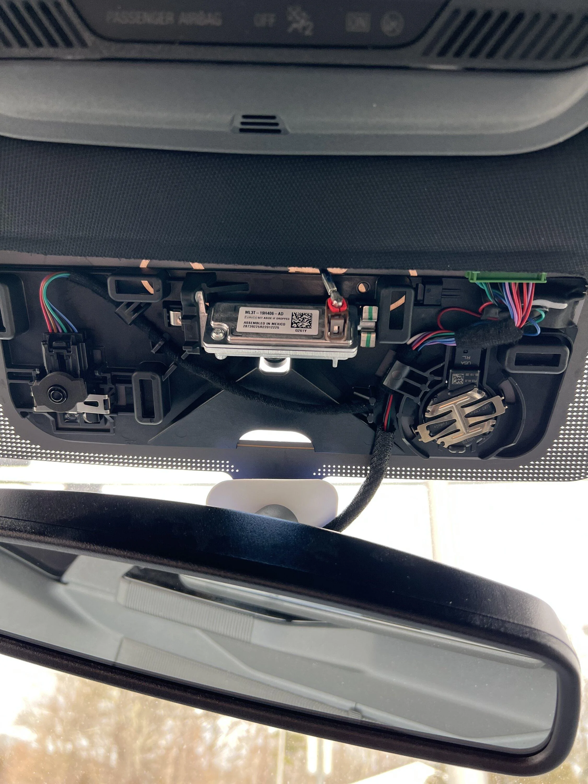

Decided to take a second look and pulled the whole cover off. My 22 Pro does have the wire there, it was just tucked up there nicely. $40 auto wipers, here we come!

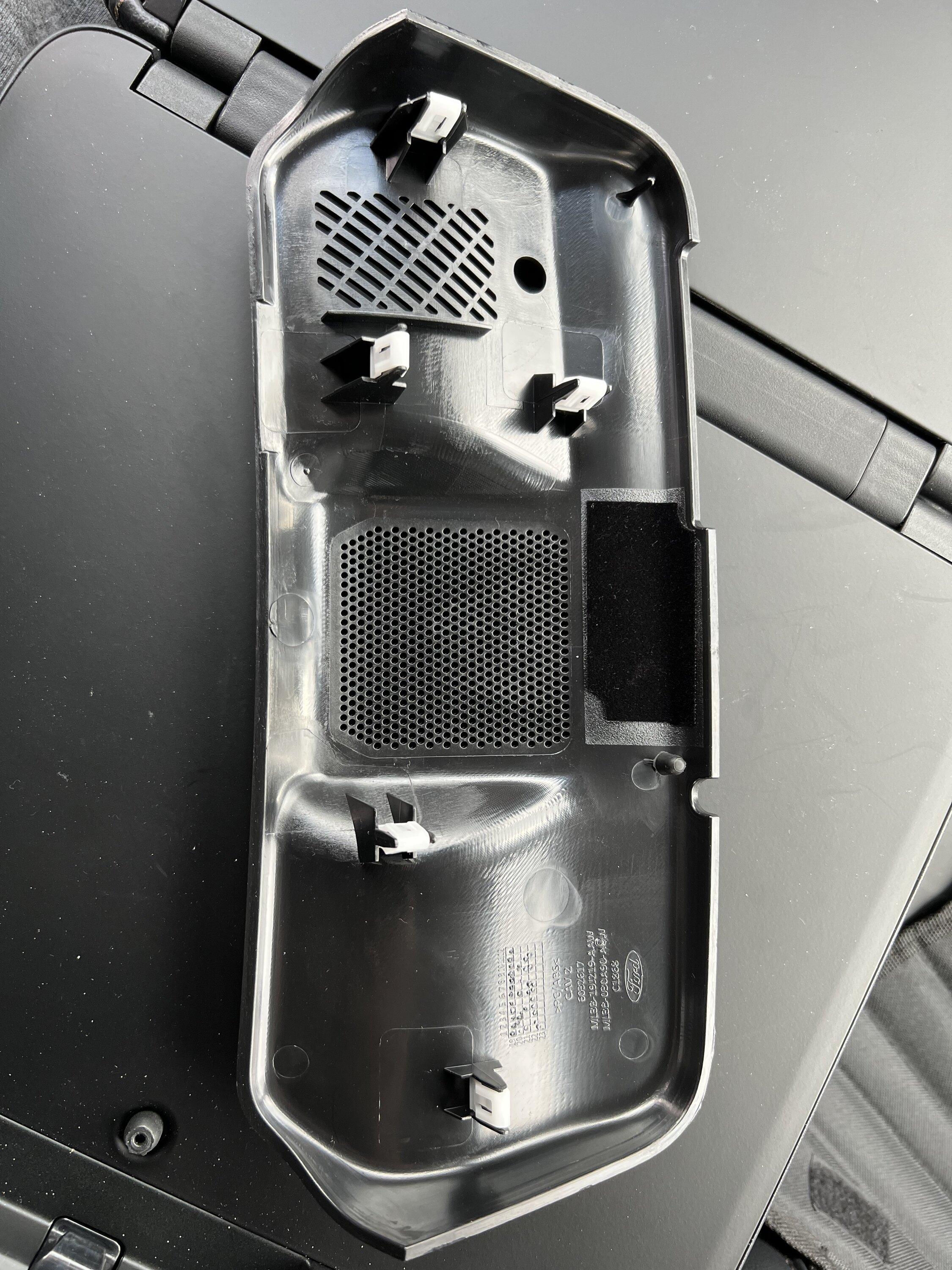

Are we doing the four line change or the three in Forscan i saw some debate? Also how many clips holding the cover on the mirror?

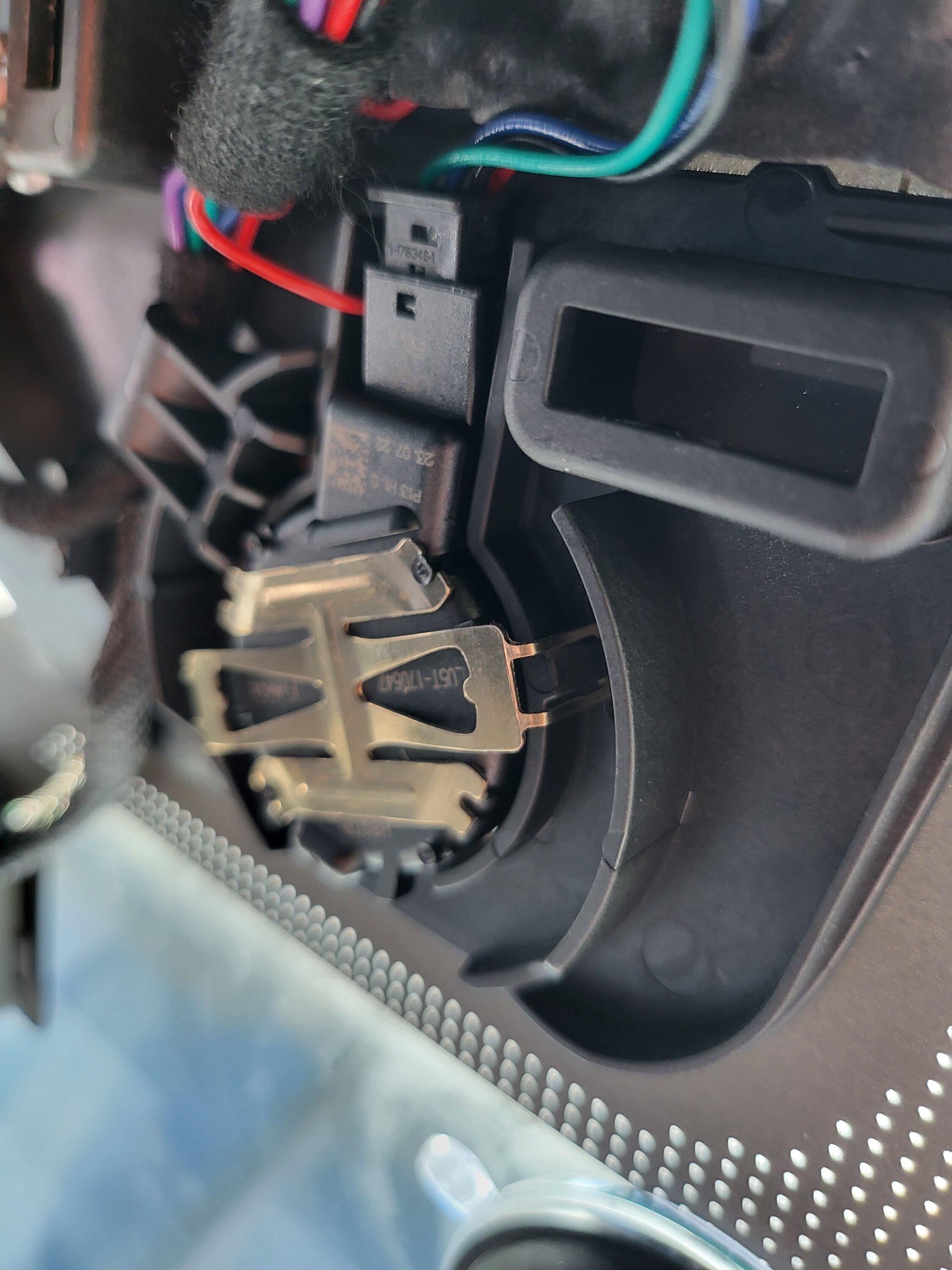

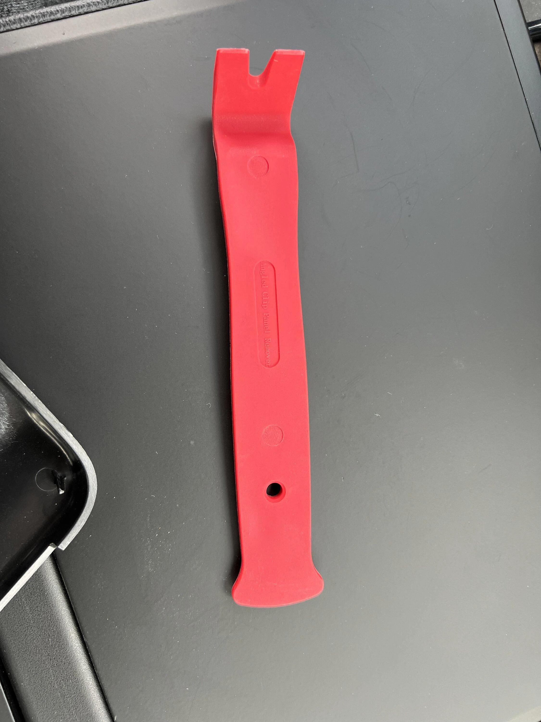

installed. Seems to be working I will update after a rainy day. I’ve attached more pics. Of location, The tool I used, where clips are located on the back of the cover and the option to enable on the infotainment. I changed all four lines in Forscan.

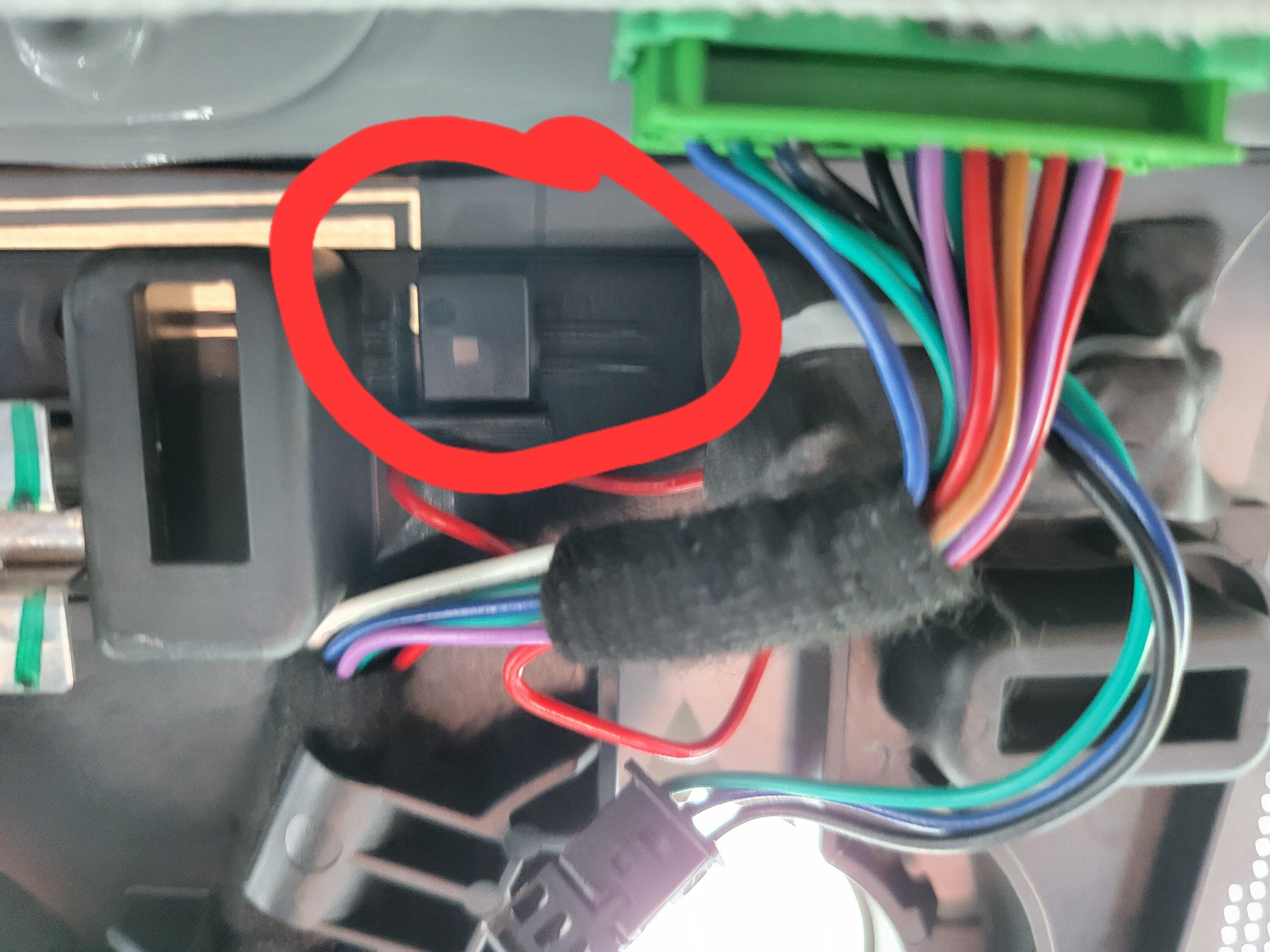

I installed the part today. On my MY23 Pro the cable was plugged into the area circled in the attached photo. I thought I was going to snap the plastic getting the cover off, scary.
