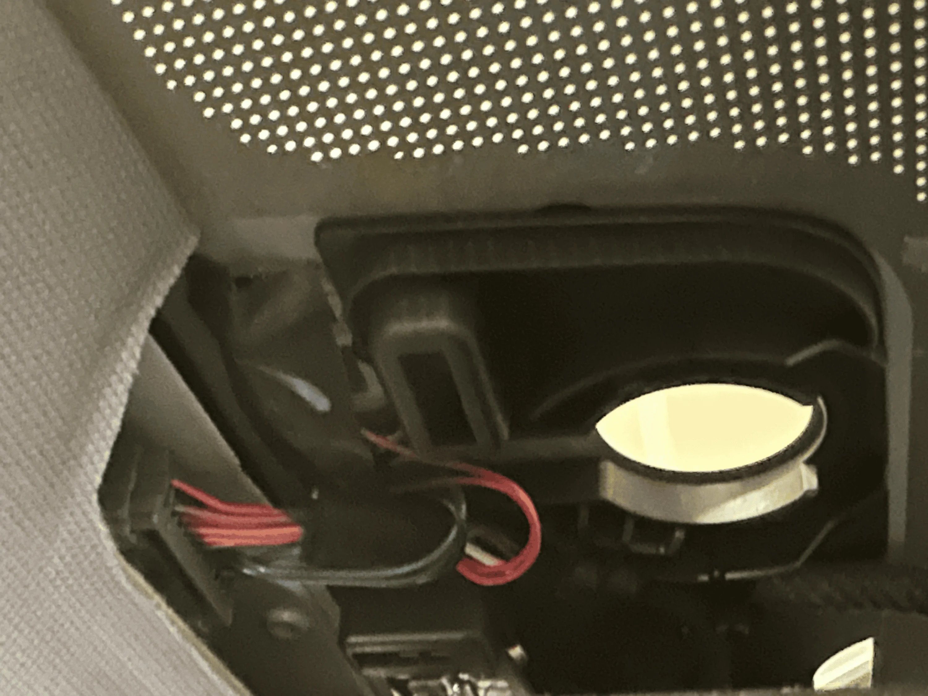

This is what I've got under the cover of my 2022 Pro... looks like I dont have the wire for the rain sensor, can you confirm?
Correct I don't see it, attached what i have and circled the factory connector
