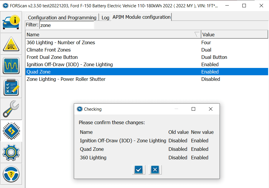

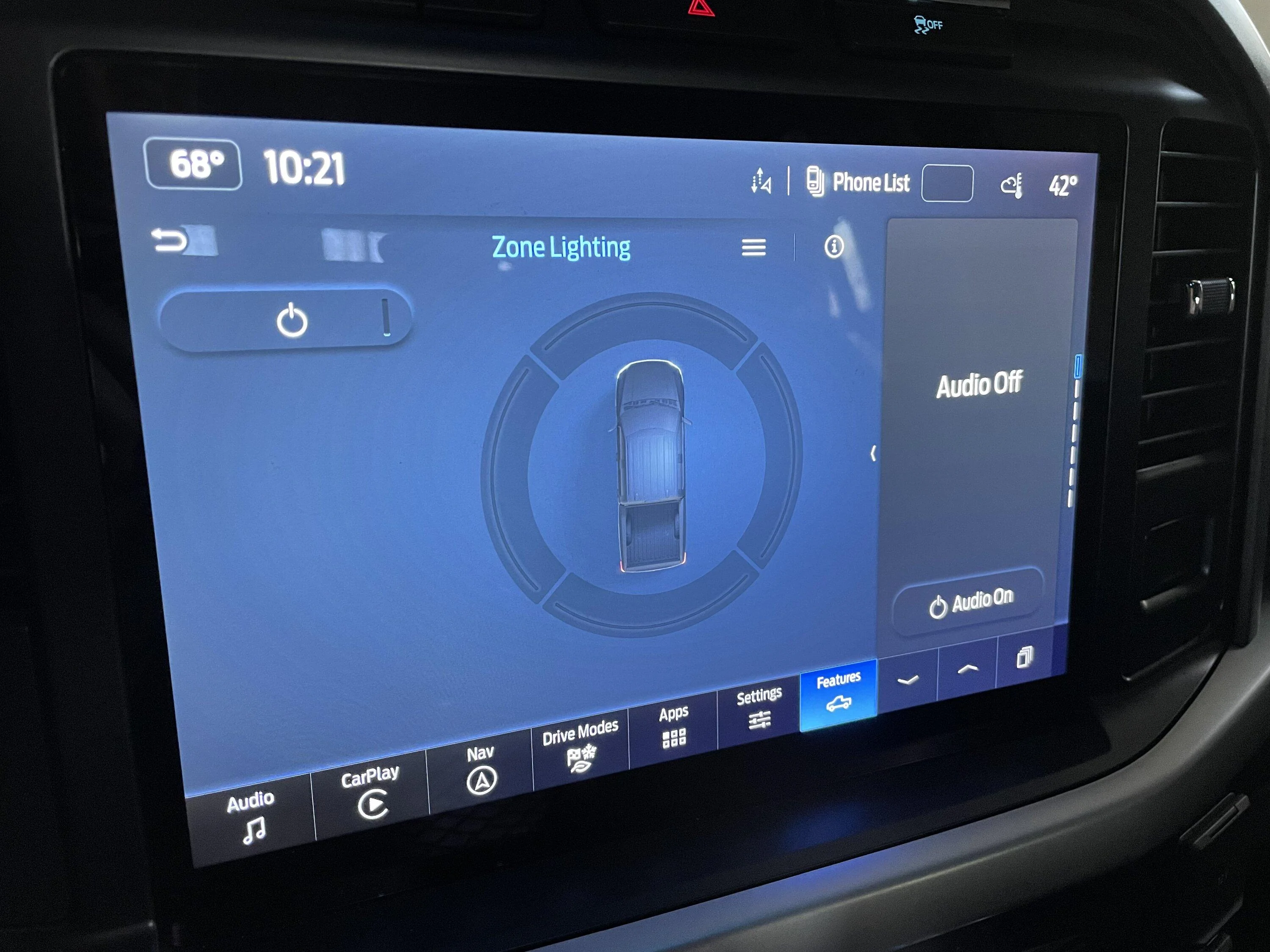

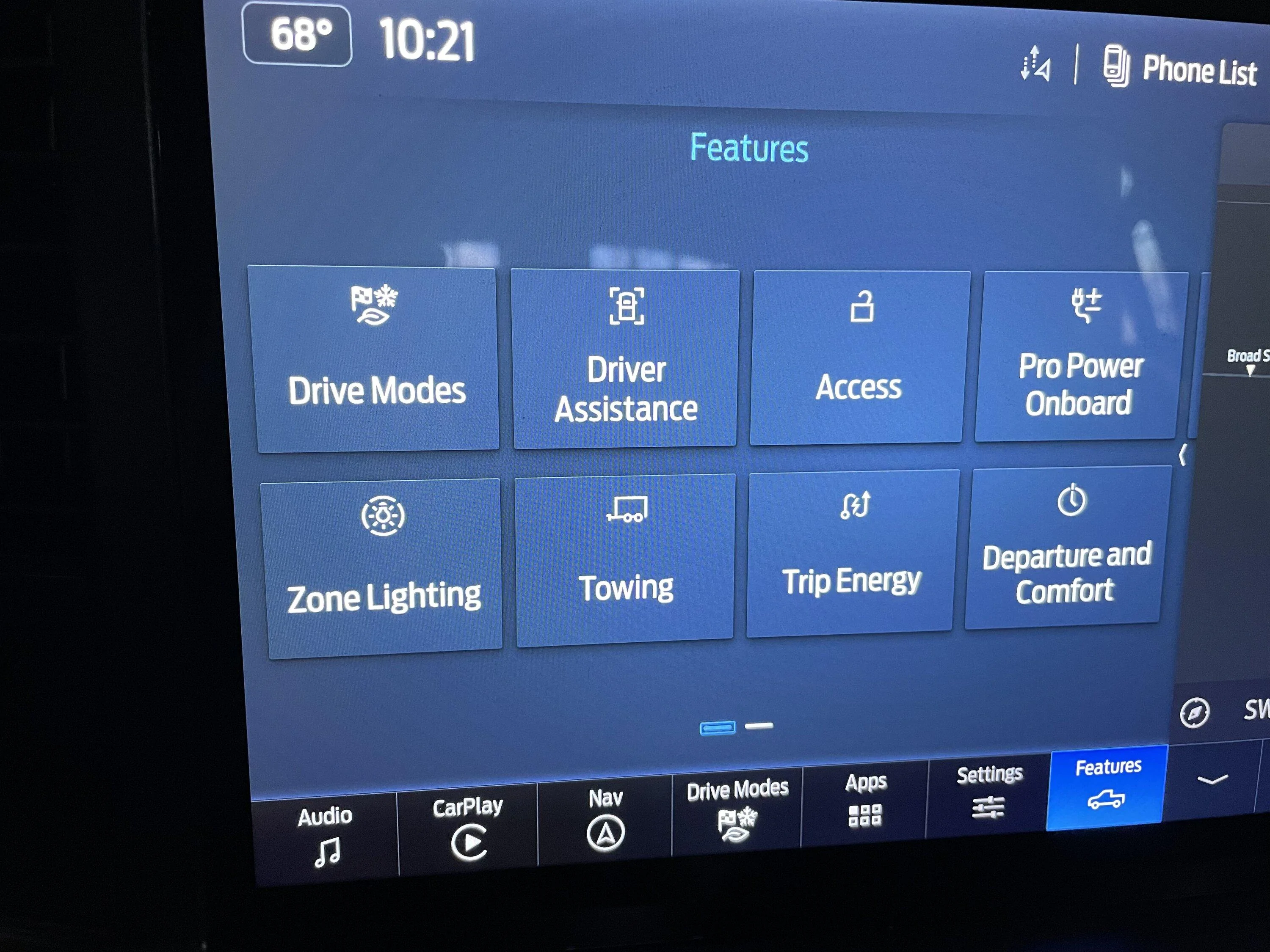

Does anyone know a way of enabling zone lighting through FORscan? Looks like the 2023 Pro has this already enabled but my 22 is missing it.
Sorry, i've been busy and without my truck some days so I haven't been able to respond. I can enable it in the as built sections, but it doesnt turn on once shown in the truck. If someone can send me a vin with a base Pro or XLT with zone lighting I can look through the as built codes better to compare.
Thank you. I was able to enable the menu option but mine is also not working either.

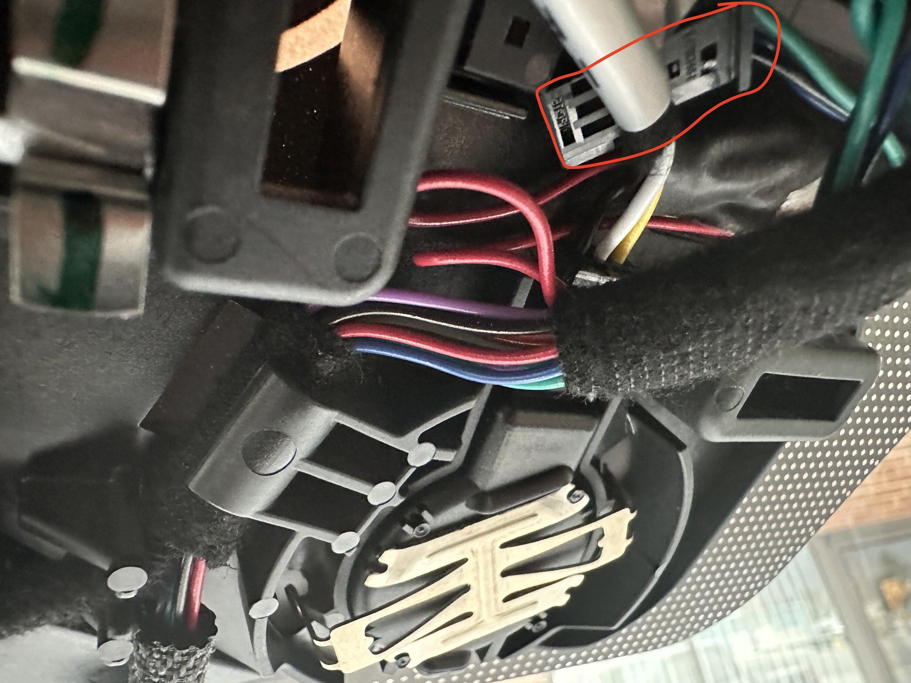

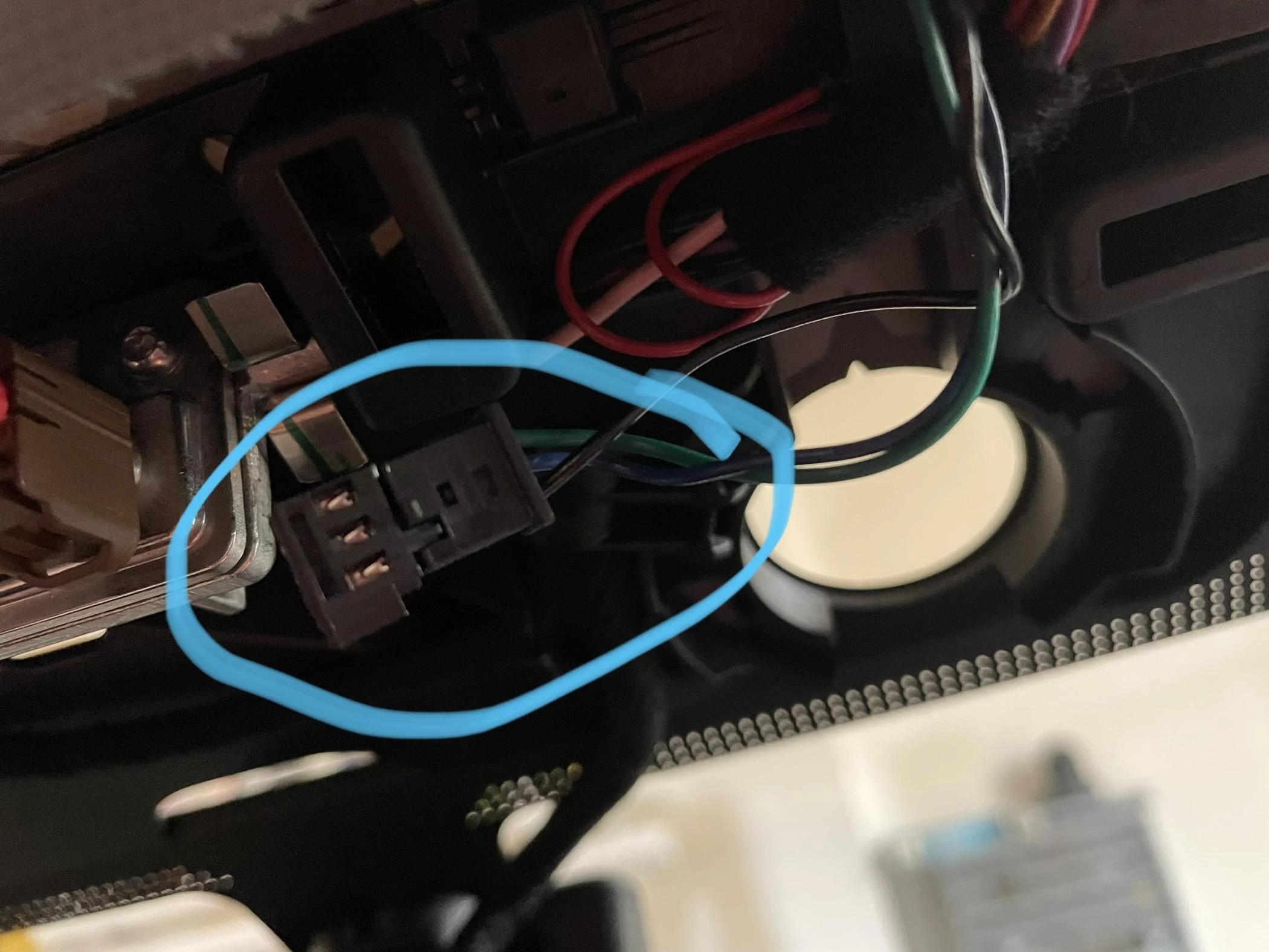

Correct I don't see it, attached what i have and circled the factory connector
Ford F-150 Lightning F150 Lightning FORscan thread Screen Shot 2023-02-04 at 10.11.41 PM
Decided to take a second look and pulled the whole cover off. My 22 Pro does have the wire there, it was just tucked up there nicely. $40 auto wipers, here we come!

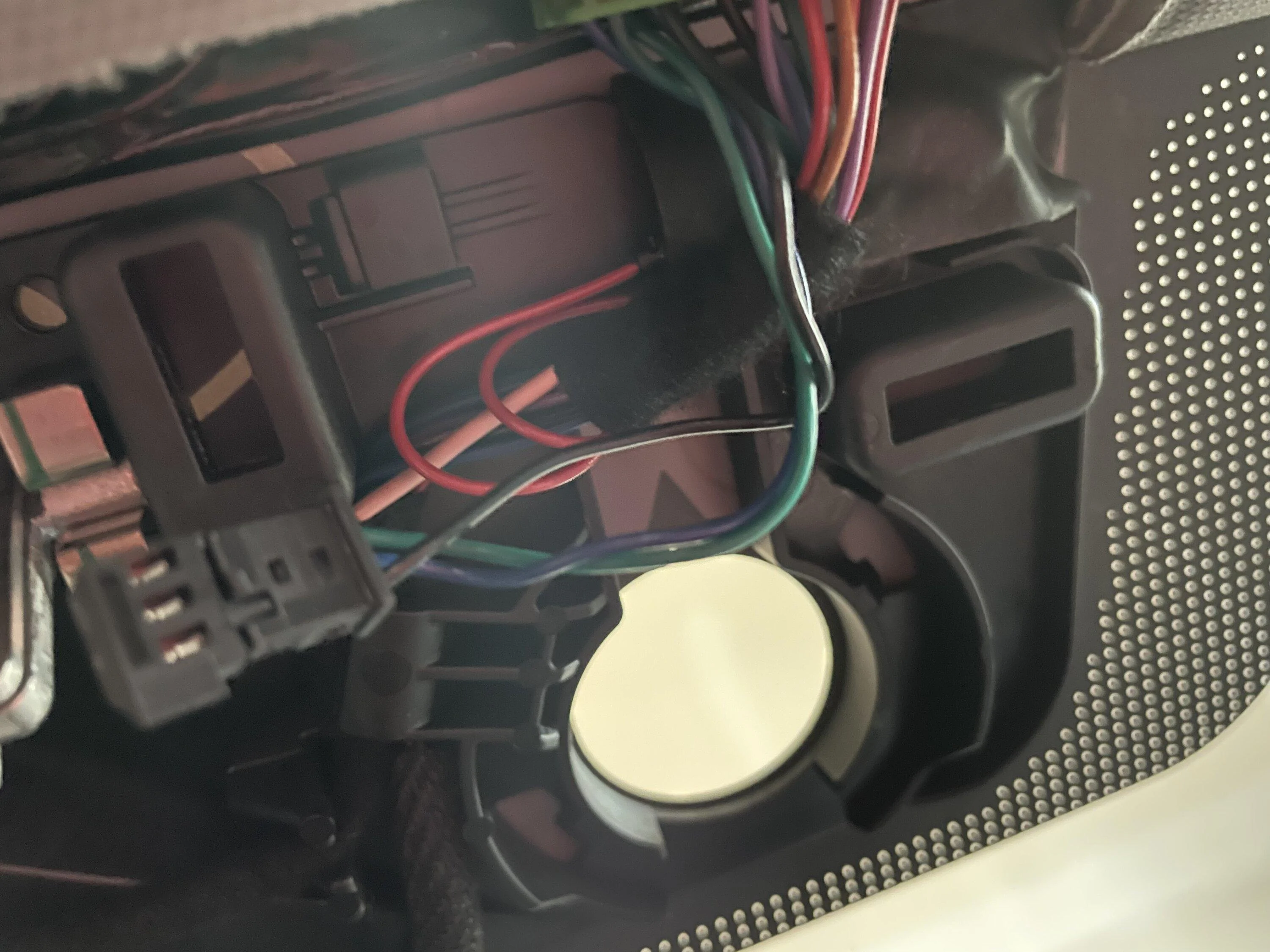

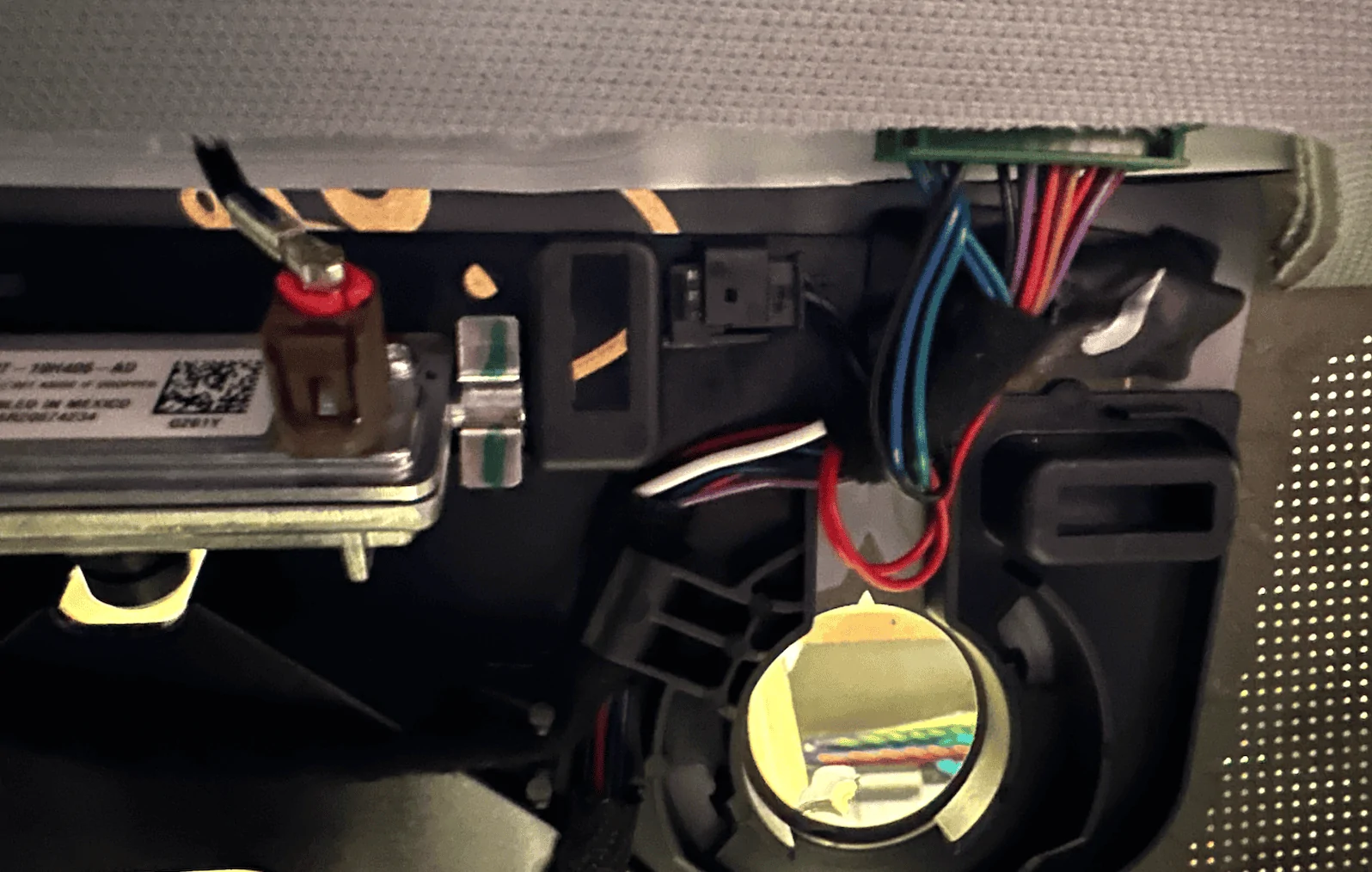

You guys are talking about this small clip with the green/blue/black wires for the rain sensor correct?
Ford F-150 Lightning F150 Lightning FORscan thread 6D25A7E7-BD6A-4388-A03D-C82BD2FC34BF
Ford F-150 Lightning F150 Lightning FORscan thread B312CF0F-422B-4668-96E0-78474D4DE119
Jeffgtx
Jan 1, 2023
Ca
22 lightning
believe so. there is a three prong wiring connector up there sitting in a clip connected to nothing.
