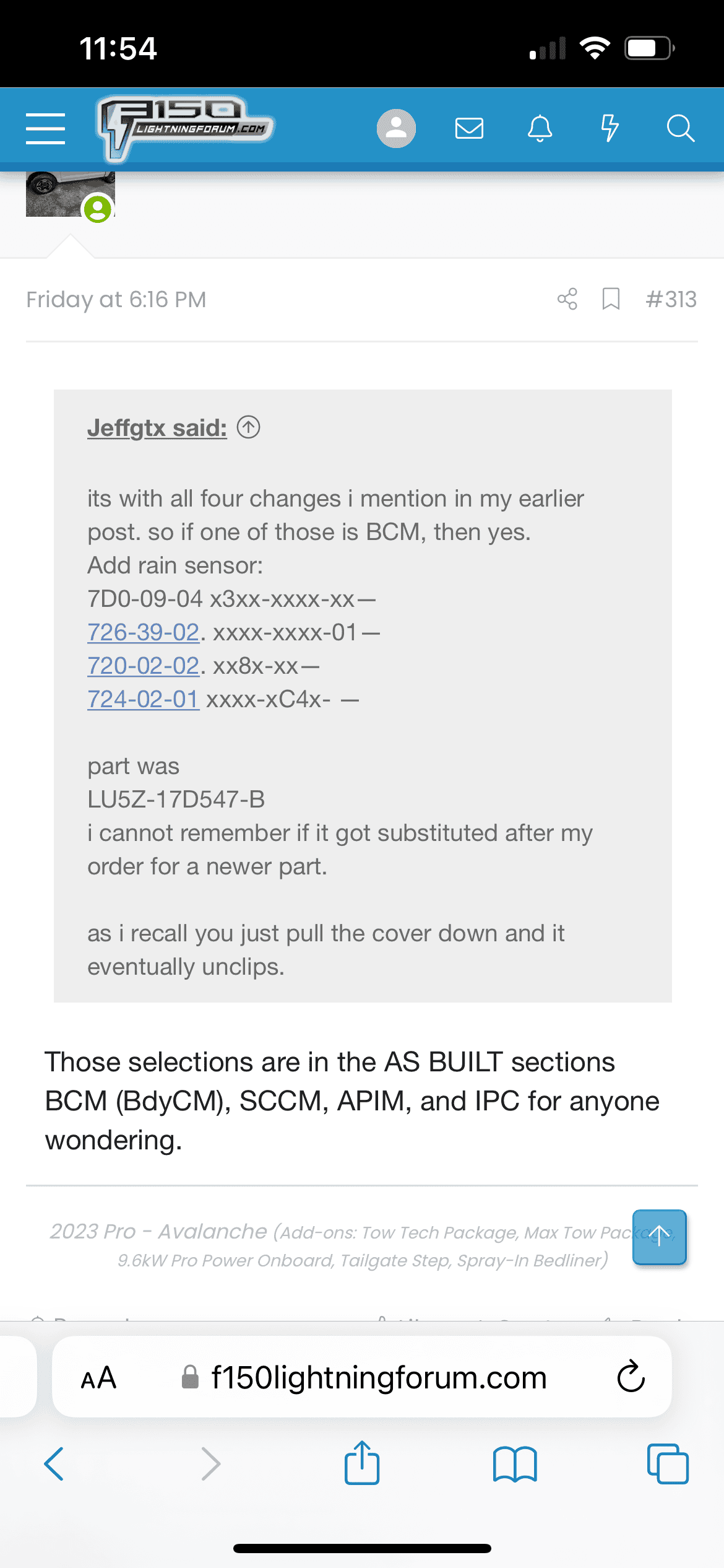

Well guys, did the battery reset as well as the module resets. Any other thoughts?
This is the list I used….
Ford F-150 Lightning F150 Lightning FORscan thread A6BAB84E-8E7C-4A5A-85A0-12EAB439E4E2

Did you double check the changes? I had changed one incorrectly
I just did. Everything looks right….
Double check me… the ONLY changes are the Numbers or Letters shown…leave the x and - alone. Correct??
Correct.

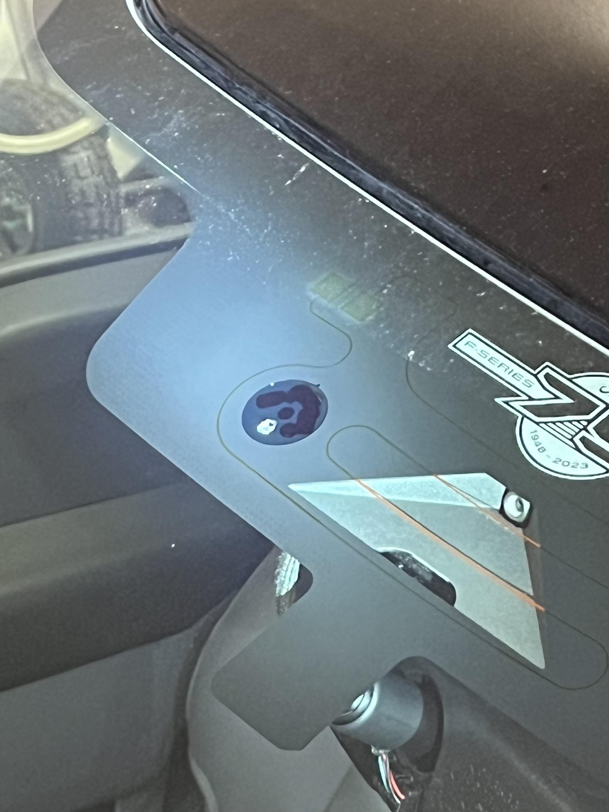

All right guys, one more on this.
Took a look at the sensor through my windshield and it looks like this. Is this normal?? I took off the plastic/rubber cover that was protecting the “eye” side but honestly never looked at it. It’s a gummy adhesive surface. When I pulled it back out, it had the same look even when not pressed up against the glass.
Anyone else’s look like this?? Defective?
Thanks again everyone. I don’t think I really care about the rain sensing wipers at this point. I’m more mad at myself on how much time was spent on this with no result!!
