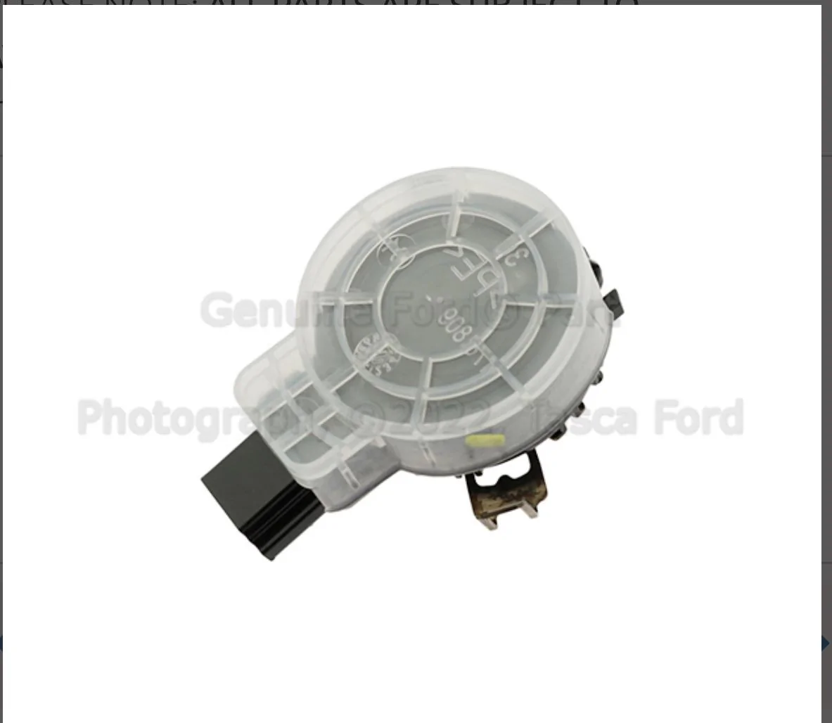

All right guys, one more on this.
Took a look at the sensor through my windshield and it looks like this. Is this normal?? I took off the plastic/rubber cover that was protecting the “eye” side but honestly never looked at it. It’s a gummy adhesive surface. When I pulled it back out, it had the same look even when not pressed up against the glass.
Anyone else’s look like this?? Defective?
Thanks again everyone. I don’t think I really care about the rain sensing wipers at this point. I’m more mad at myself on how much time was spent on this with no result!!
Is anything covering the sensor?
Mine had a plastic cover. I made sure not to touch the sticky part.
Yeah, the discoloration/weird pattern is below the level of the clear jelly-like adhesive. Who knows…guess I’ll give it a few days and order another one. Luckily they are only $40!
Thanks again for your help!
[/QUOTE]
Nope, that part looks crystal clear. The discoloration/weird pattern is elsewhere on the sensor and below the level of the adhesive.

My sensor didn't have the discolouration

I’m
Just making super sure here…..the plastic cover comes off before install…correct????
yes there should be a metal clip on the back to clip into the spot on the windshield.

Decided to take a second look and pulled the whole cover off. My 22 Pro does have the wire there, it was just tucked up there nicely. $40 auto wipers, here we come!
Sweet!
