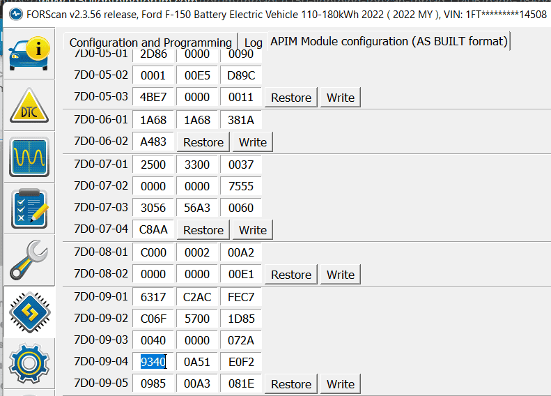

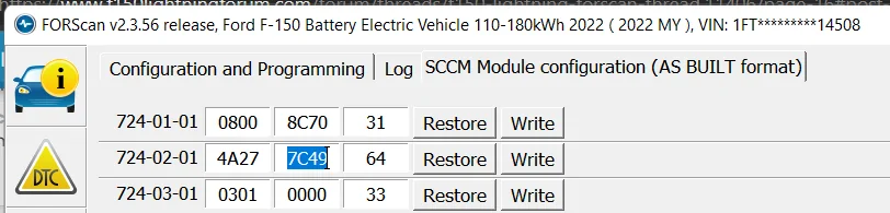

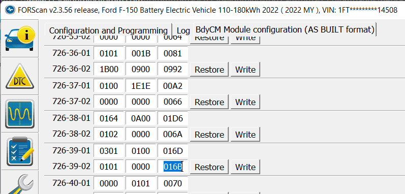

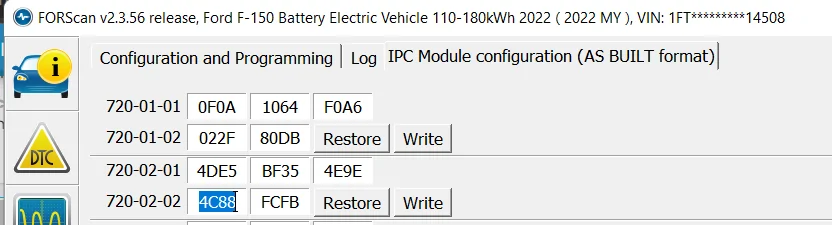

Hi, i am hoping to add rain sensing wipers to my lariat SR. I have added the sensor to the windshield (the connector is present above the mirror).
I received this info from a helpful f150 member who did this to his ICE lariat. I have checked it against livinitups spreadsheet and it looks like the lightning tabs show similar values to what he used. can anybody help out and let me know if they think this is right? this would be my first forscan attempt, so i don't want to mess anything up.
Thanks.
7D0-09-04 x3xx-xxxx-xx—
726-39-02. xxxx-xxxx-01—
720-02-02. xx8x-xx—
724-02-01 xxxx-xC4x- —

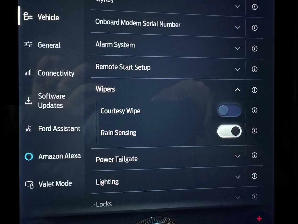

I have made these changes, reset all the modules, nothing seems to work. I have the option in the settings -> vehicle -> wipers -> rain sensing (enabled) but when I flip the first wiper mode on using the stock, it doesnt actually start working, instead it just does a wipe and then some time later does it again (i.e. its just on intermittent mode).
I installed the rain sensor but could it be bad? I would think if it was that it the truck wouldnt downgrade to intermittent mode it would just not wipe.
Can anyone give me some gudiance on what I should try next?

I believe you have enable the rain sensing for every driver profile, including the guest profile.
