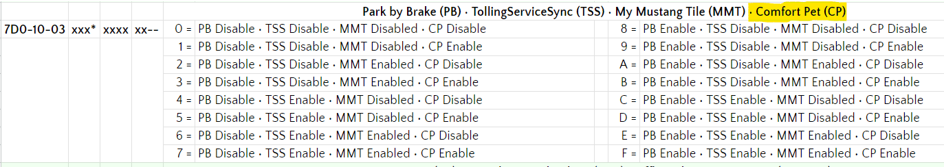

Just saw there were some new updates to the Forscan excel sheet. I haven’t been able to test them yet but knew there would be some interest.
Remove "full view not available"

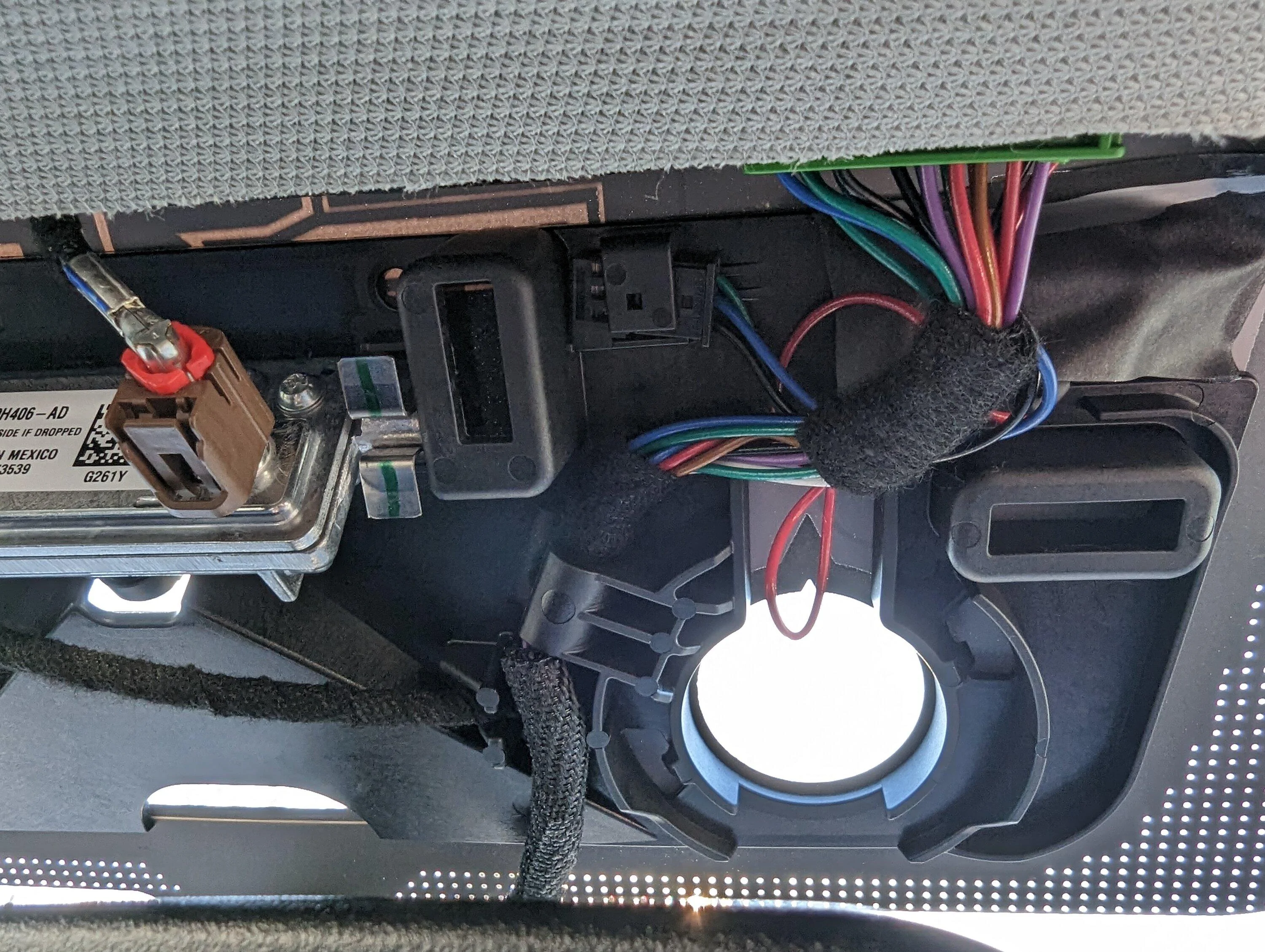

It's locked in with two or three clips. So you can just kinda pop it off.
Don't have a good picture of it but you can see two of the clip bosses here:
EDIT: Actually, this pic shows exactly the area you need to work in lol. The connector for the rain sensor is that little 3 wire tucked into the plastic clip in the center.

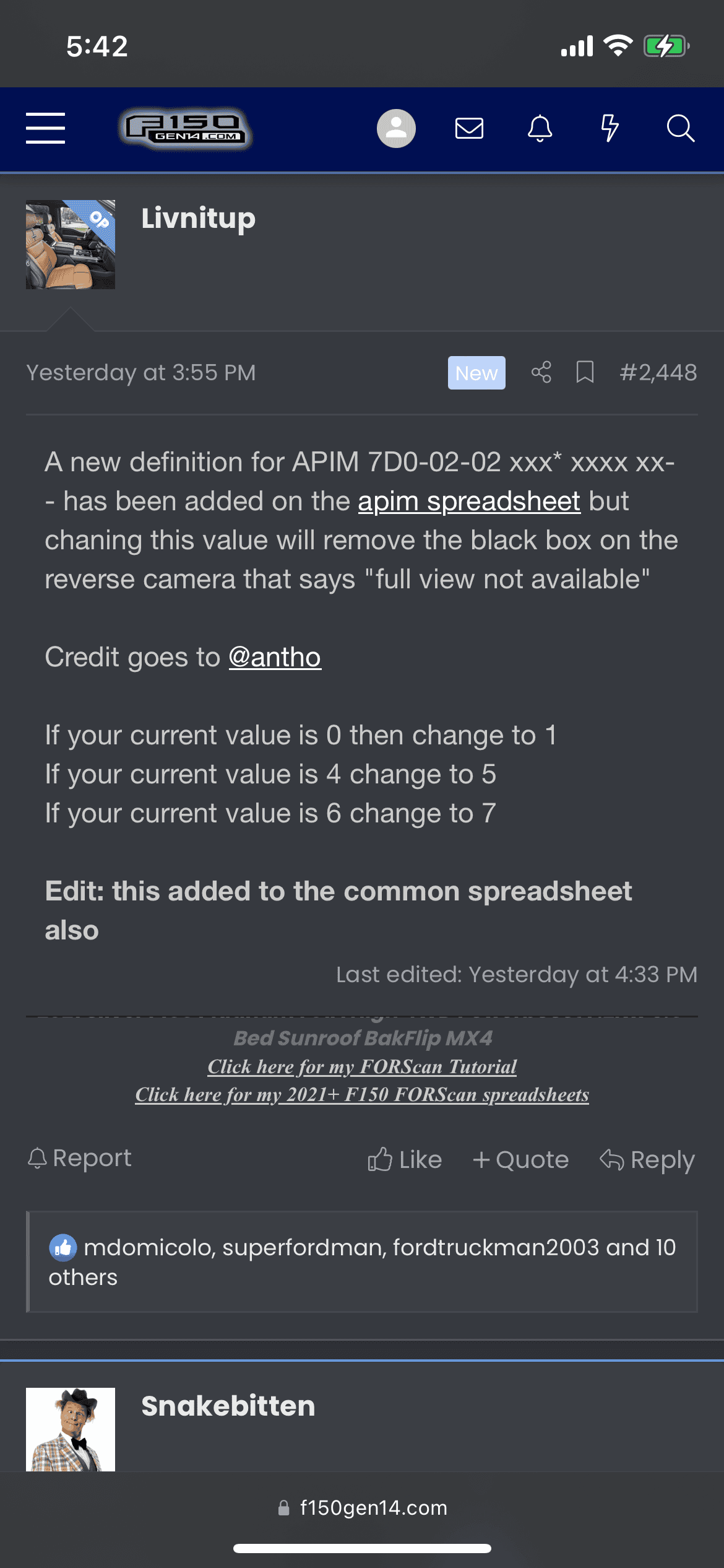

Pet mode?
Has anyone with a Pro (no options) tried this APIM change to remove black box? Tried it today (current value 4 changed to 5) and I received error messages when attempting to write. My other ForScan changes have gone fine. Not sure if I’m doing something wrong…or not working on a no option Pro.

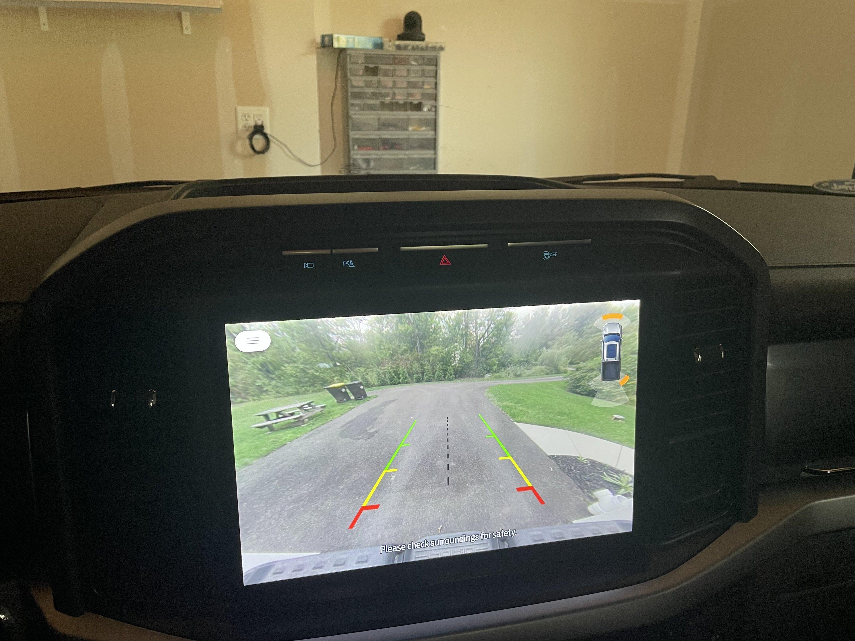

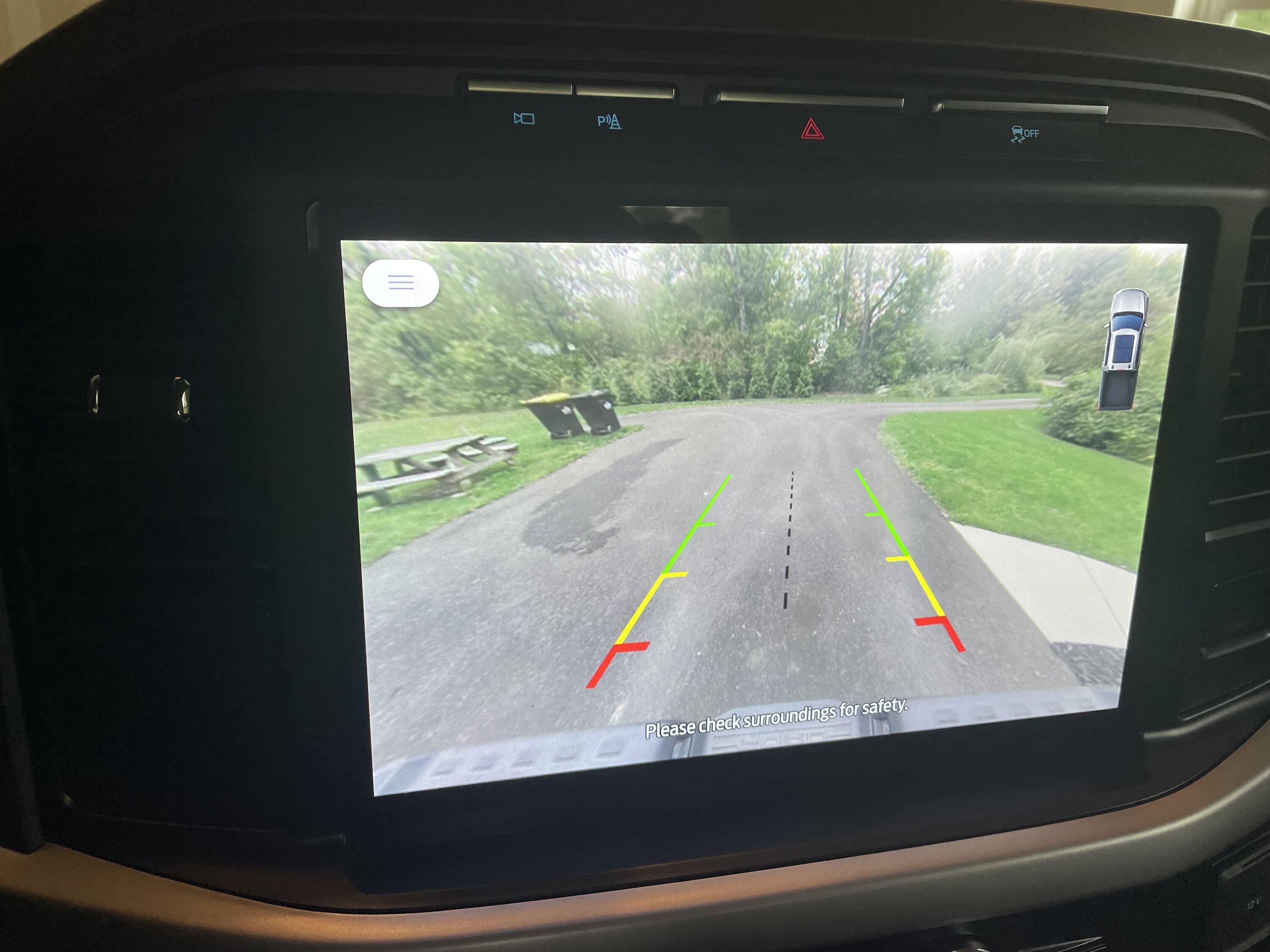

I just enabled it on my 311 XLT. Did you force reset the apim module? I also cleared all dtc’s after the reset. Worked fine for me.
Removes black box from the rear view when in drive.
Ford F-150 Lightning F150 Lightning FORscan thread IMG_5890
Also gives the radar warning for the front in the corner view until you switch back to the 360 view.
