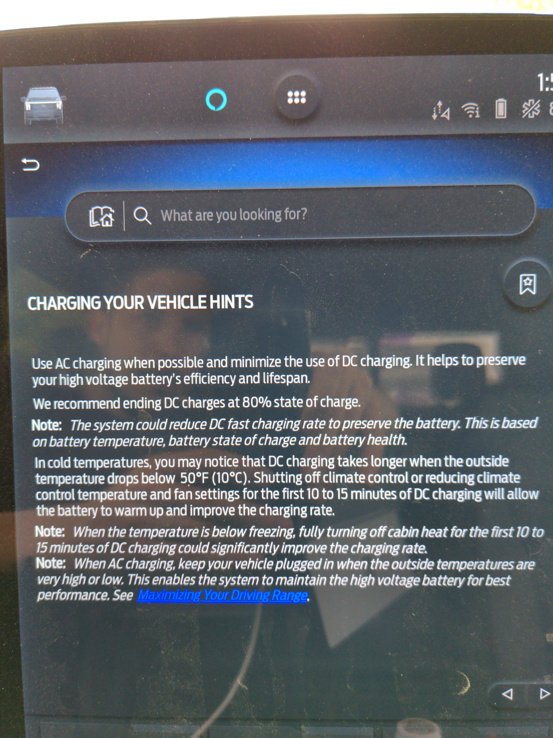

Thanks for the replies. I saw the "80%" notice in the Fordpass app, but now I cant find it again. In the digital owners manual it shows this.
I still havent figured out how to limit the daily charge limit. All i see is the one-time max charge limit. Do you need to set that everytime you plug in at home?
You should see charging locations (places you’ve previously charged). Find the one that corresponds to your home and assign a limit to it.
Do not choose “Charge when plugged in.” Doing so will cause the truck to ignore other settings.

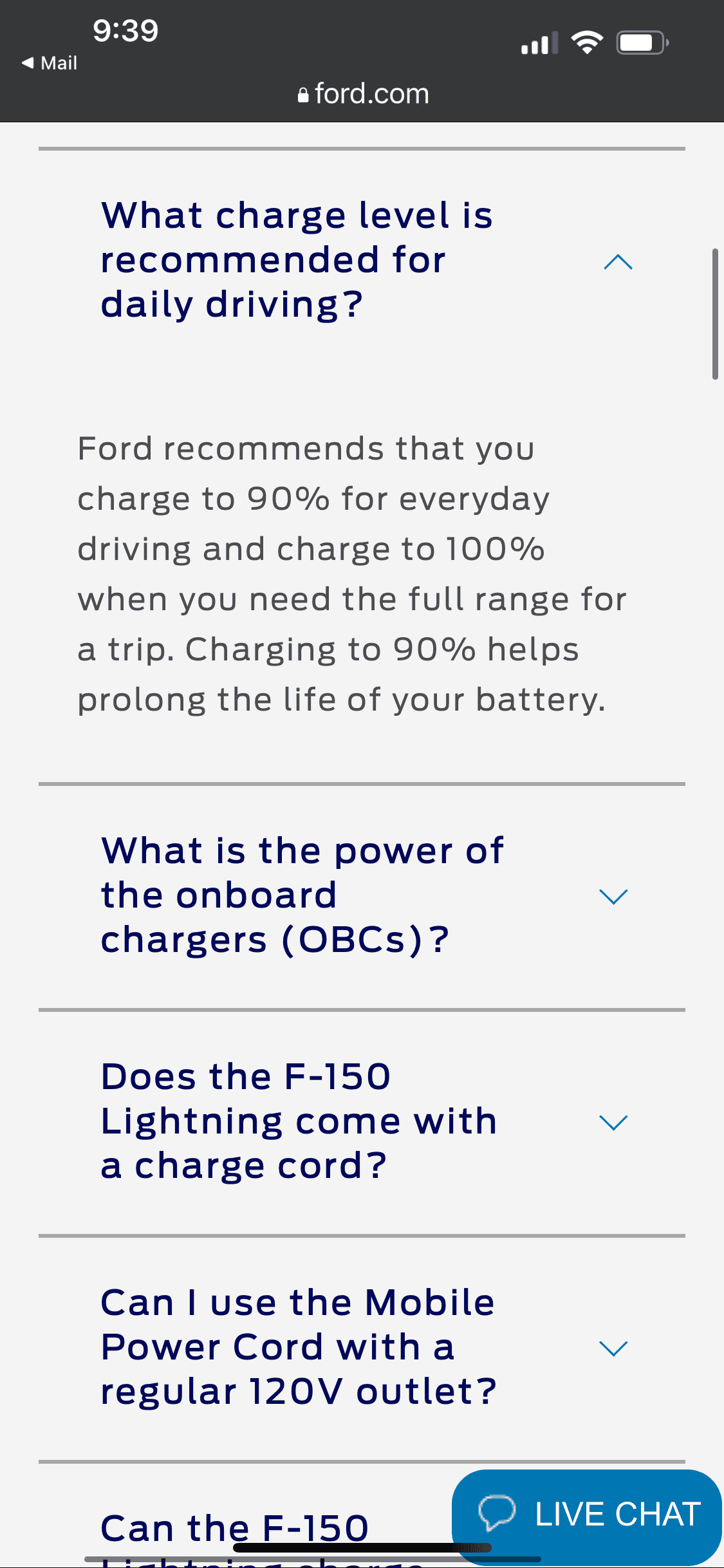

Yep. On the FAQ for the Lightning it says for everyday driving to charge to 90%.
https://www.ford.com/support/how-to...ightning-charging-frequently-asked-questions/
I see here that with regular AC charging and everyday driving, it is recommended to charge to 90 percent. I've been charging to 80 percent while using my 80A FCSP charger. I usually wait until I get down to about 55 to 60 percent before I plug back in. Should I just set charger to 90 percent? There are so many supposed proper ways of charging, I get a little confused.
If 80% covers your needs, I’d stick with it. I limit to 80% unless I know I’ll need more.
I charge my Mach-E to 90% because it’s the daily driver and if something unexpected comes up, that’s what we take.

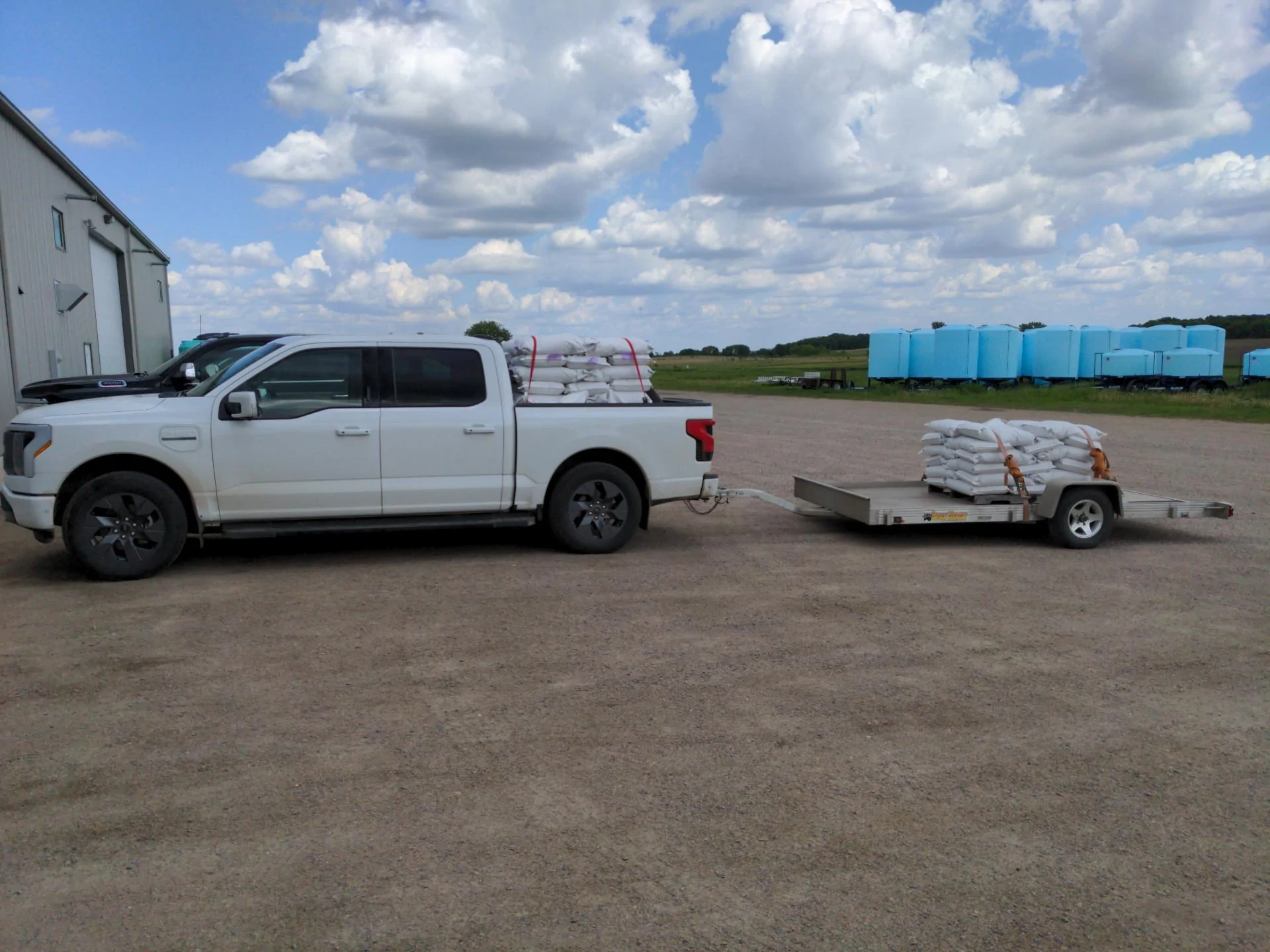

The trip was a success. I started the 140 mile return (loaded) trip with 90% charge and had 40-50 miles to spare when I arrived. There may have been a breeze at my back. I got 1.8kwh/mile with 2600lbs in the bed and towing 2000lbs. External temp about 85 degrees and using low AC in the cab.

You might want to learn more about your truck's capacity limits. You were dangerously overloaded.
Read the payload sticker on your door jamb. Subtract weight of any mods to the truck, and all passengers. Now subtract 300 pounds for your tongue weight. Now 2,600 in the bed. I suspect you were over 1,000 pounds overloaded.
Does your truck have the scales?
