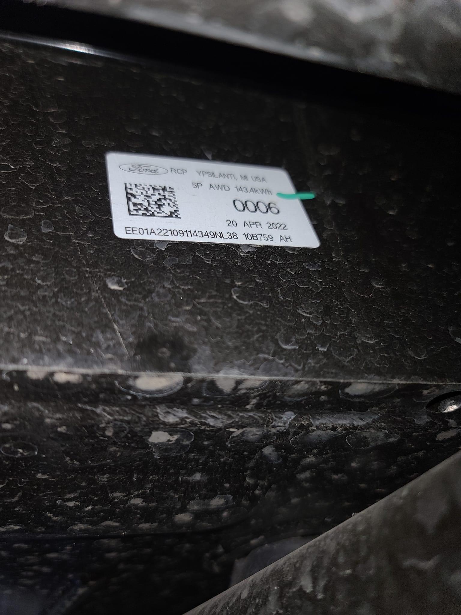

Saw this on FB. According to OP, he saw the truck up on a lift today and was able to see the number. This is for ER battery.
So Ford keeps close to 8% capacity reserved.
Ford F-150 Lightning 2022 Lightning Extended Range (ER) battery real capacity (not usable) = 143.4kWh and Standard Range (SR) =  107.6kWh 8C615C1F-604C-439A-88BD-9A411572E30A

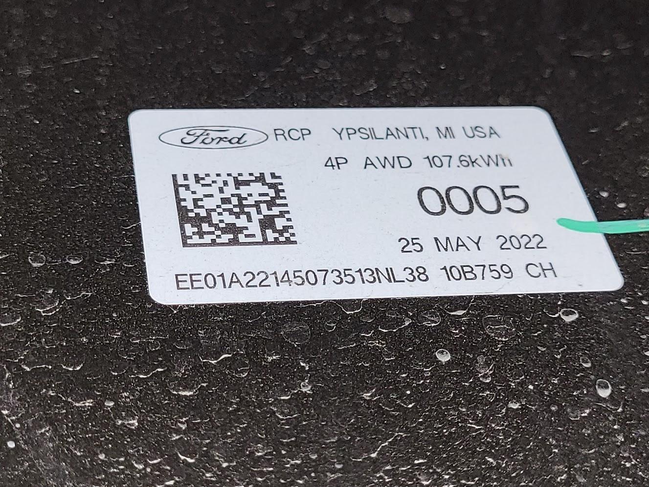

Update: We have a number for SR battery: 107.6kWh real capacity.
That's why I charge mine to 100%.
Good to see that the SR battery is actually 107 kWh total capacity with 10% buffer built in.
Now I know it's safe to charge to 100% which in reality it's actually charged to 90%.

Most, if not all, reserved capacity would be used for below 0% situation. Completely zero is more harmful to Li-on battery, especially for long period.
Keep it on 100% is not good as well. I still suggest you to keep it at 90% unless you have a road trip coming. Don't think you really need that 20 miles range for everyday driving.
