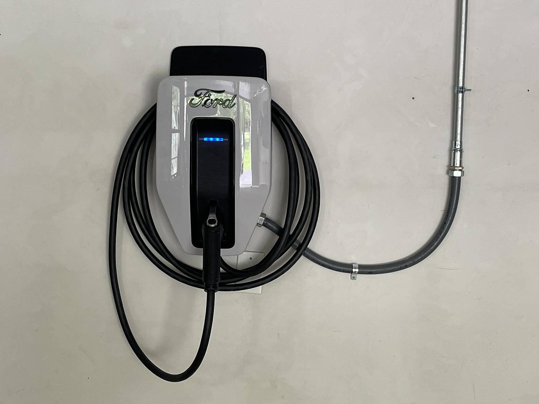

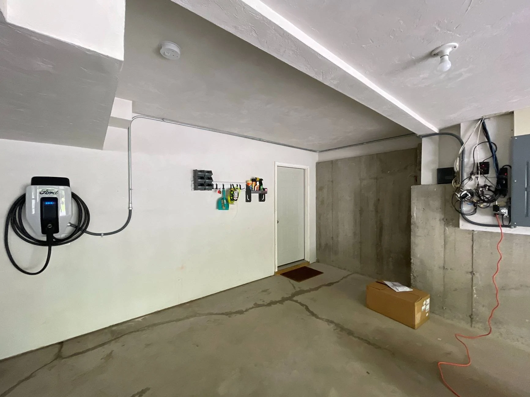

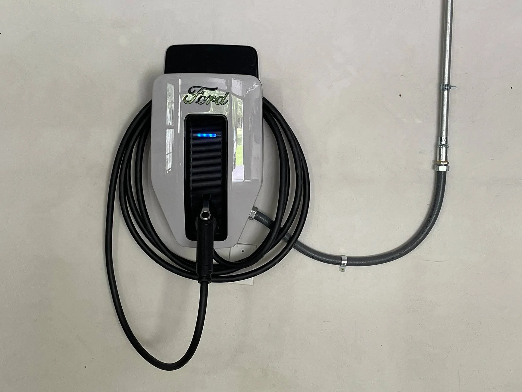

So, the EVSE is installed. The physical installation went with no issues. When they went to connect it to the WIFI the SSID for the FCSP wasn't showing up. Took them about 20-30 minutes, some power cycles, and a hard reset, but it finally showed up. (I think the solution was just a little patience while waiting for everything to start up the first time.)
While they were trying to get the software side of things connected it popped into my head about the permitting/inspection, so I asked how that was being handled. They were surprised/unsure... when I said I was being charged $325 for permitting they said something like "oh, well, they'll take care of it". I figure if I don't get some paperwork, I just won't pay the $325.
The other thing I learned was that my installer's company is owned by QMerit, and not just a contracted company.
The Lightning was already at 84% when we plugged it in, so I bumped the charge percentage to 100% and it said completion by 4:15pm (EST), which was a little less than 4 hours from that time.
I'll drive it around and let the charge run down and do a real charge session and see what I get for numbers (40A EVSE/50A breaker).
(There is a shelf to the right of the EVSE and some other stuff over in the alcove by the door. It's not "messy" but it's not this clean either. I just moved everything so they could do their work.)
