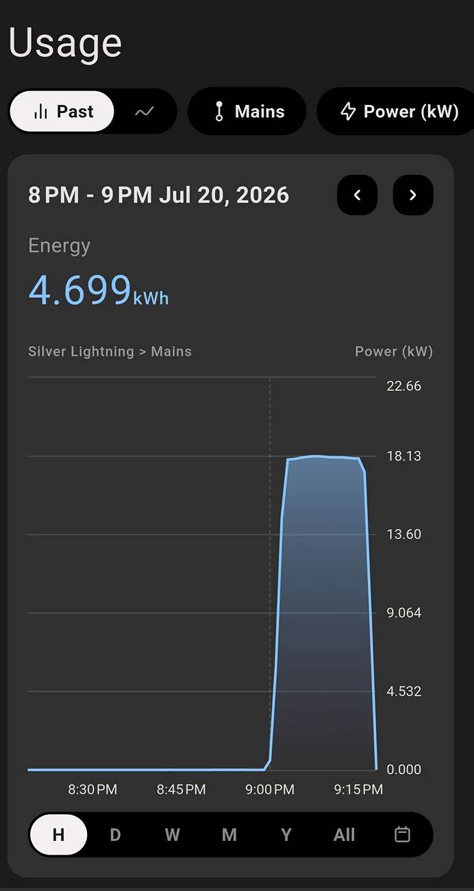

My deferred charging session worked with no issues this evening, I was only at 87% so I set up the session to start at 2100 hrs and charge to 90%.
It ran for 17 minutes at the 80 amp setting, actual throughput was ~75.5 amps.
