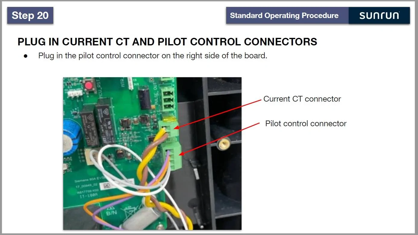

Might also check the connectors on the circuit board that plug in for the J1772 control signalling.
Ford F-150 Lightning Ford Charge Station Pro FCSP steady amber error light when plugged in. control circuit plug in

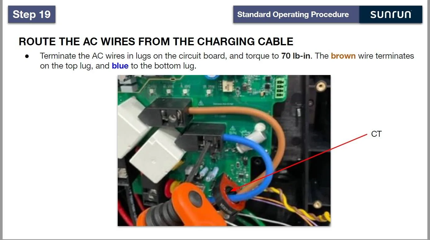

By the way, you use a 5/32 Allen wrench on the "brown and blue AC Wires from charging cable" according to FCSP information documents and "torque to 70 lb-in. The brown wire terminates on the top lug, and blue to the bottom lug."
Ford F-150 Lightning Ford Charge Station Pro FCSP steady amber error light when plugged in. ccs charge cable wires
