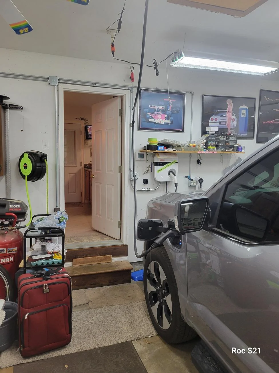

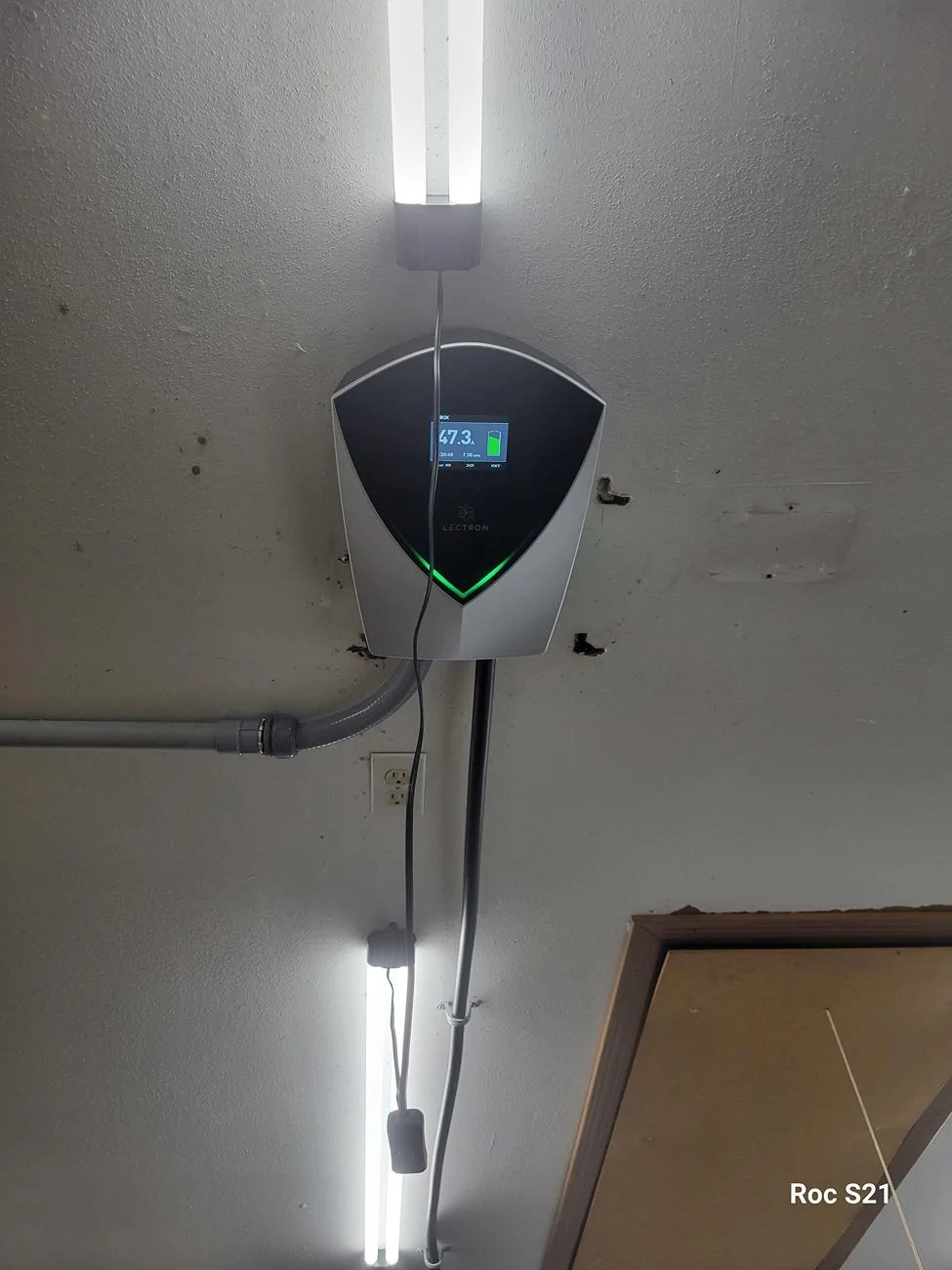

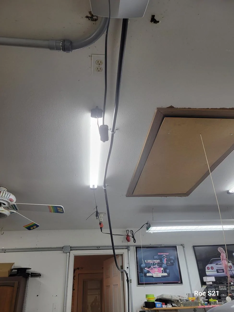

It is a great Idea. This is a Lectron mounted to my ceiling. I used a tool balancer for the cord end, and mounted the plastic plug holder to the wall. Love it. This unit has an on off switch, I can reach using the Lightning running boards.
Ford F-150 Lightning FCSP on Ceiling? 20240614_235844
Ford F-150 Lightning FCSP on Ceiling? 20240614_235852
Ford F-150 Lightning FCSP on Ceiling? 20240614_235841

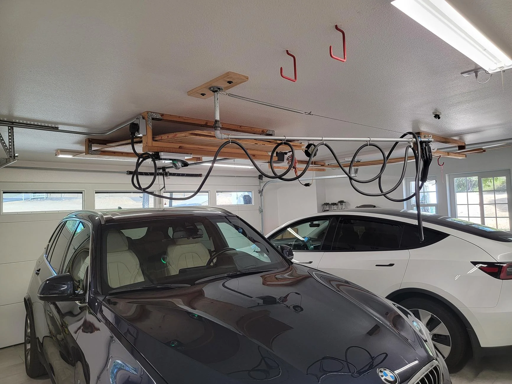

My situation was a bit different....I have 3 EVs in my garage and need charging access for all of them (my Lightning is in my workshop that has its own charger). Because I needed to get to all 3 vehicles, I mounted my charger (a ChargePoint in this situation) in the center and built a rotating arm that pivots to each vehicle. I really wanted to have, as you have suggested, a reel if some kind to take up the extra cord. That part was a bit challenging as you'd also have to have rotating contacts that would carry 40 amps! I gave up on that idea and just left the excess cord coiled up on the rotating arm. It works quite well as it is, so dropped the reel idea. But yes, mounting to the ceiling worked well. Here I mounted the charger to my plywood storage rack on the ceiling and ran power to the 14-50 outlet I mounted on the side of the rack. It may look a bit strange, but I never have a cord on the floor and can easily charge all 3 cars!
Ford F-150 Lightning FCSP on Ceiling? Charging cord
