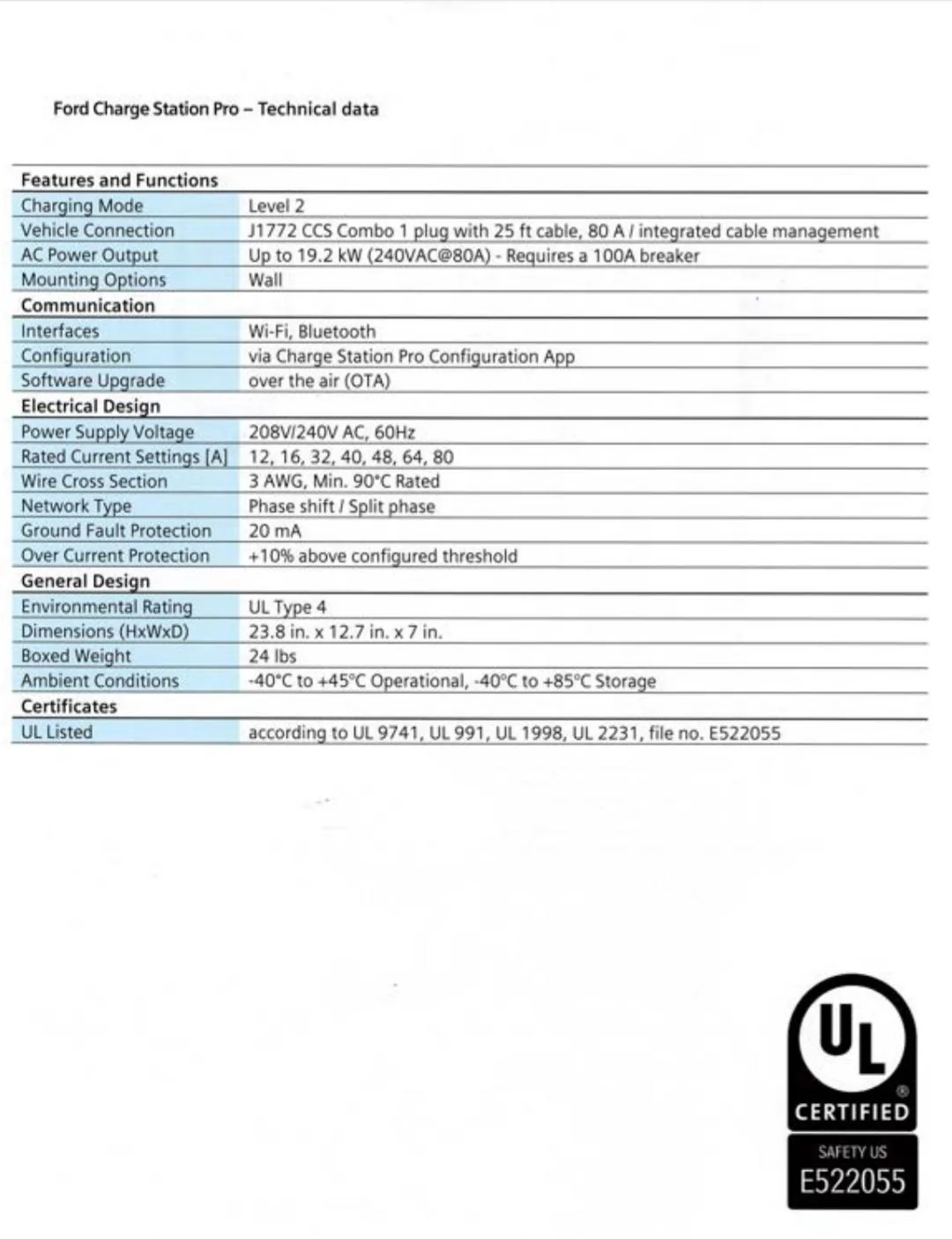

As per the install guide:
Ford F-150 Lightning FCSP on less than 220v (208) Screenshot_20240318_130210
It will work just fine on 208v
The maximum power advertised is at 240v 80a (19.2kw). At 208v 80a you'll get 16.6kw max.
My house puts out about 220v and I'm set to 48a, so I get just over 10kw.
