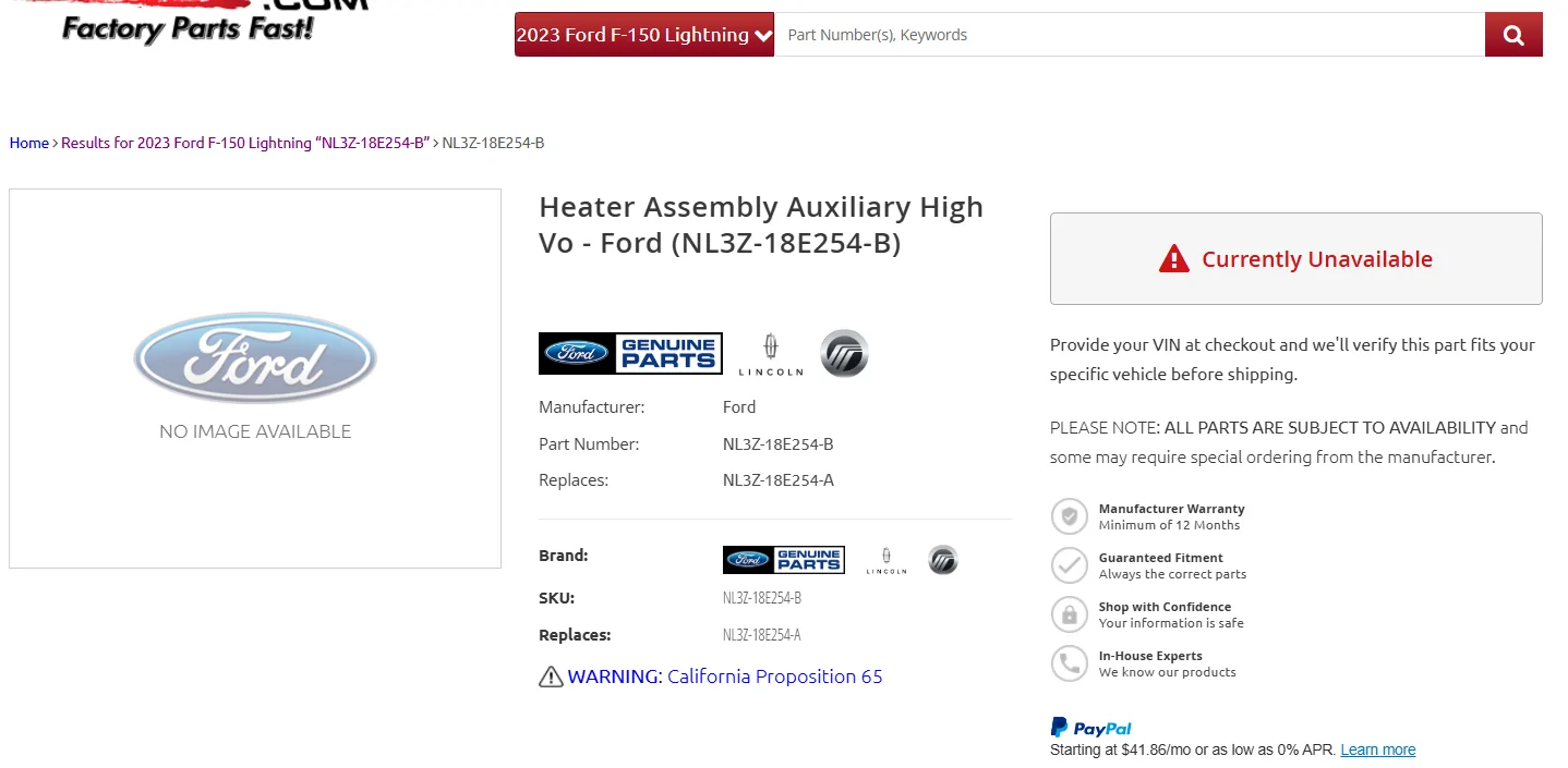

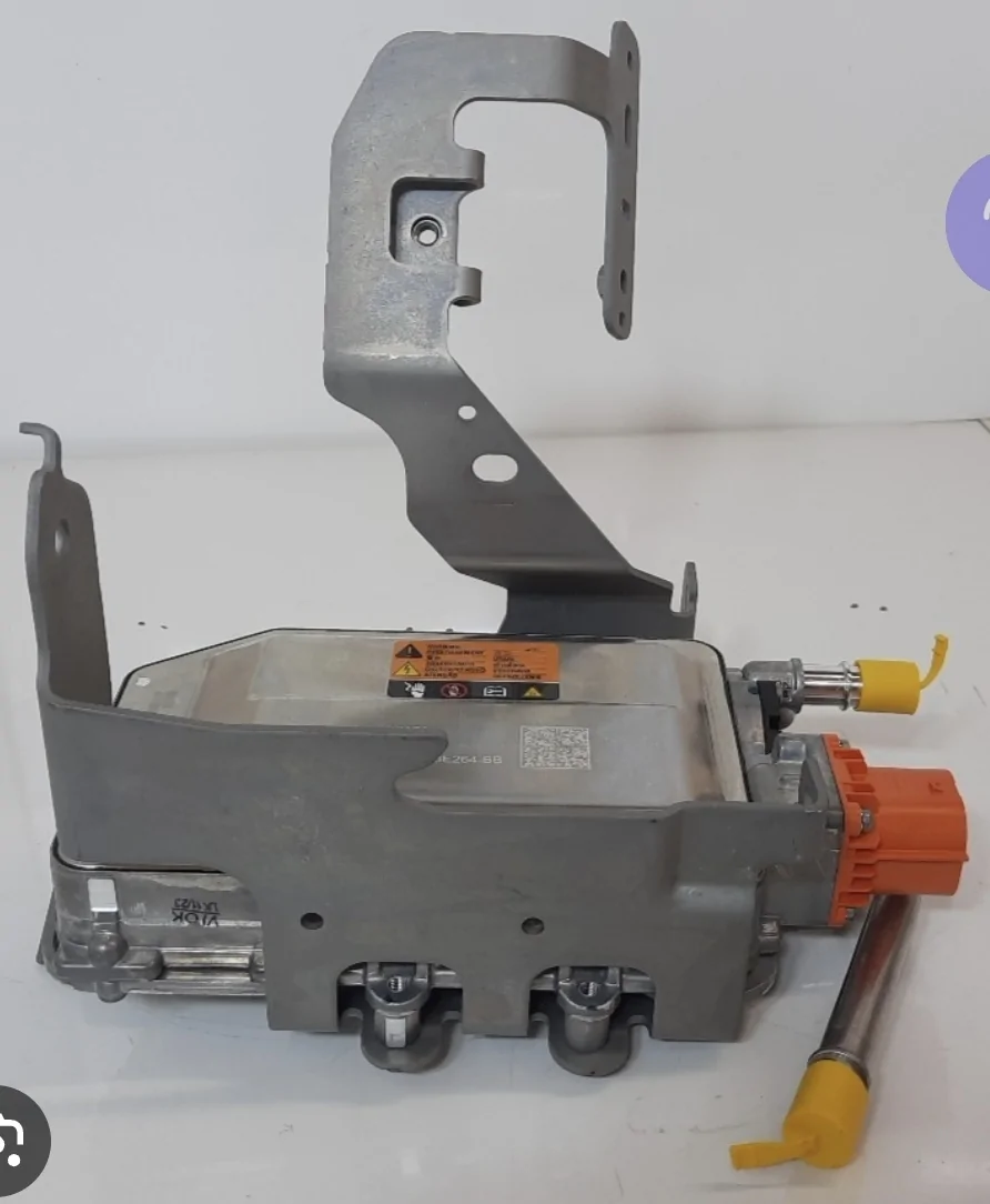

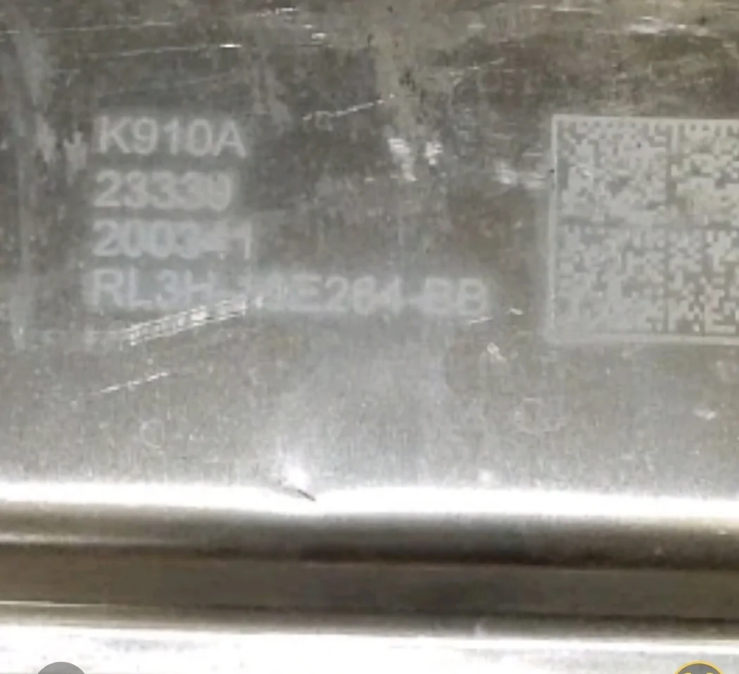

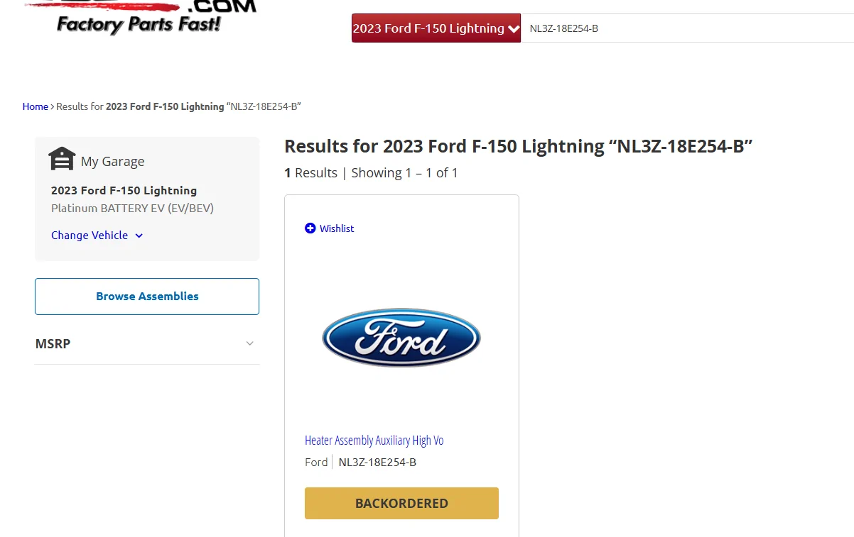

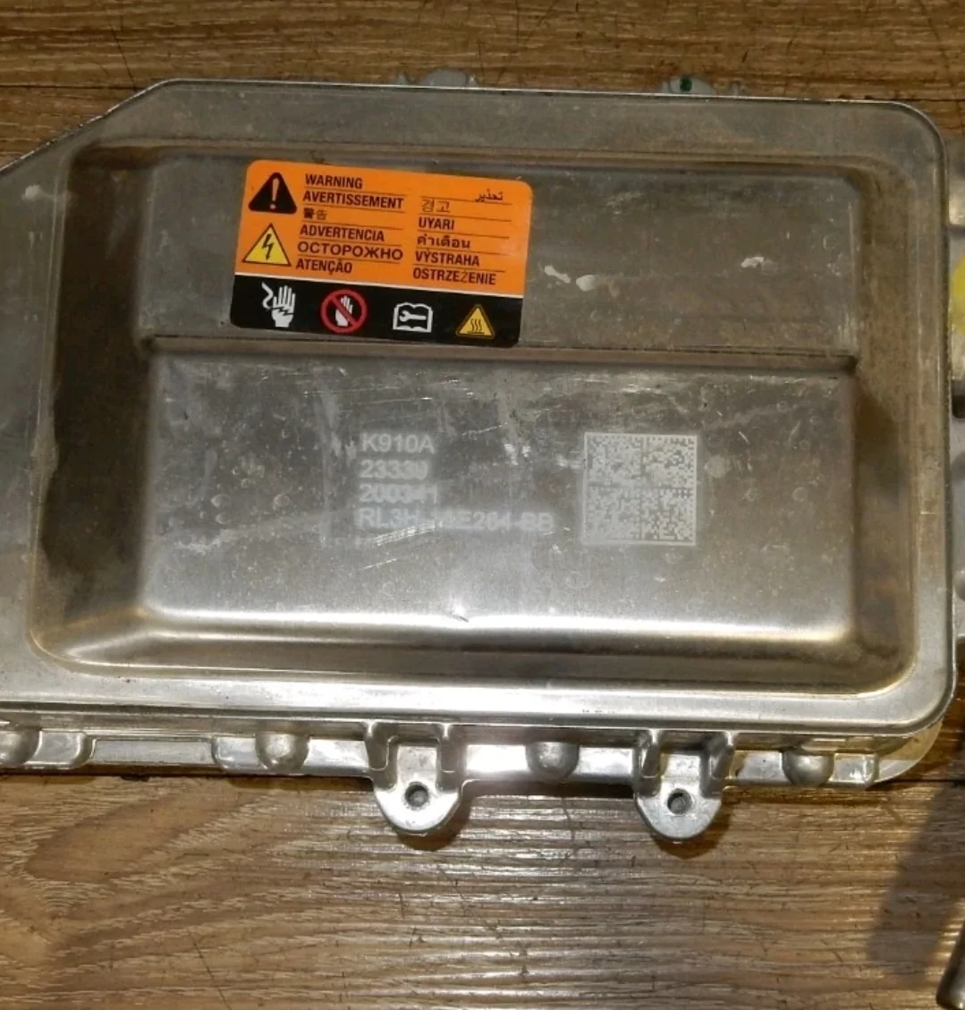

The reason I'm dubious of the part they're quoting me is everything says '25 Mach E. I know newer Lightning have a heat pump, but I can't imagine all lightnings went to a new mach e part and Ford just didn't update their part #'s.
The fact that you know of the exact issue and reference a different part ID makes me wonder if somehow this one got glanced over in the recall. I bought it used.
It's also worth saying it was -26 at the time of failure (which also sucked being a human with no heat availability on the side of the road)
The PTC heater for an early Mach-E is 5KW. The one for the Lightning is 7KW. Later Mach-Es went to 7KW so it’s possible those are the same.

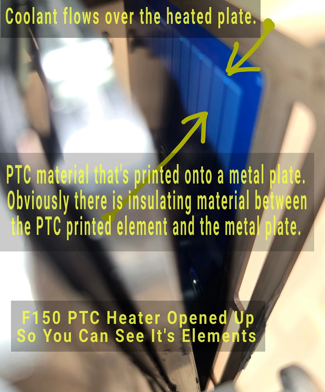

That's the Cabin Coolant heater, PTC heater, and I gues some are calling it an auxiliary heater. It's odd that it stranded you. Mine went out and I could still drive my truck... my windows would fog up and I used a small space heater to heat my windshield and the cabin. It could be dangerous to drive with a fogged up windshield.... we need to see what's ahead. I wonder if a new software update causes the trucks to not drive when the PTC heater goes out for safety reasons? If it's warm outside they should allow you to drive home. Call Ford customer service and ask for the BEV division. Mybe they can activate your Truck to get you home. They can diagnose over the air.
