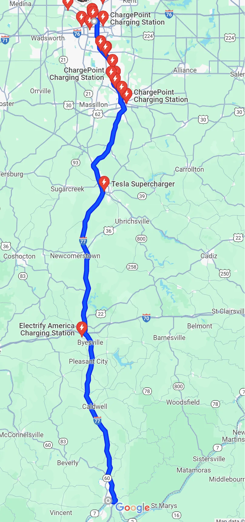

We planned a short road trip yesterday, from Akron OH down to Marietta, 130 Miles on a chilly 14F day. I figured with my GOM showing 190 miles that should be no problem to shoot down, charge up again L2 on a 220V at my in-laws place while we hang out and come back with lots to spare, right? But just in case, there is an Electrify America DC fast charger about 50 miles outside of Marietta. Money! No worries! It turns out we did not, and could not possibly have, made it to Marietta on my 190mi range/90% charge. I ran pretty quick, about 75 on cruise, and we did have the heat on. You know, like normal people do? We hit that DC charger with a 3% SOC after 85 miles of travel and I had to slow it down to get that. Oof! The 350KW EA did the job real nicely for us, 40 minutes at the Wal Mart was kind of pointless but we had fun.
We drove the truck around Marietta and burned up most of the juice down there. I went to the FIL's garage and unplugged his welder hoping to find a NEMA 14-50 plug, but nope! He has a Nema 6-50P three-prong plug. I've gotta look that up, we may be able to find an adapter but it has no neutral. Very slowly charged up to 55 miles range on 120V and then a freebie Level 2 at the library, see previous issues, and very hesitantly drove at 60MPH with no heat on the 45 miles back to the fast charger. Guys, it was that or sleep at my in-laws. Not gonna happen.
I'm new, this is the learning curve for me still, but I would say my experience was two out of five stars, do not recommend. I'm not very certain that my wife will agree to travel in this truck anymore. Other than running at 55MPH with no heat is there something I'm missing? What would you have done differently?
Keep track of your current consumption, by resetting Trip 1 every 10mi or so. Multiply that consumption number (miles/kWh) by your SOC (%, find it on the Calm Screen), and THAT’S your range-to-zero (SR makes the math easier). You’ll know in the first 10mi, whether you’re driving efficiently enough to reach your planned charge stop. Get in the habit of doing the mental math (mi/kWh x SOC% = range-to-zero) every 10mi or so, and you’ll never wonder where your range went.
Example: 1.8mi/kWh x 49%SOC = 88 miles-to-zero

For a second there, I thought you meant Akron OH to Marietta GA (just outside of Atlanta). Having driven from Atlanta to Toledo to visit my sister-in-law and her family for Christmas, I can say that it is not an easy, short trip. ;-)
There are a few few take-aways, though. First, if you're planning on doing Level 2 charging at someone else's house, do a "site survey" first: check out the plug you plan to use and the distance to where you're likely to be able to park. Get any plug adapters you might need -- in your case, a 6-50P to 14-50R dogbone would have saved the day. I carry this one, and a couple of other useful adapters, in a small duffel bag tucked into the "cooler" part of the frunk.
I was already thinking about the Christmas trip when we visited my wife's sister last summer, and checked out their charging situation. It turns out that none of their exterior or garage outlets work. So from the get-go, I knew I had to plan a trip without being able to charge at my destination.
The other is to run your planned route through ABRP (A Better Route Planner, the app or the website) to sanity-check it. ABRP suggests that an SR truck can't comfortably make that trip without a charging stop at the EA in Cambridge. The stop doesn't have to be particularly long if you have charging at your destination. Alternatively, the trip is do-able without charging in Marietta, if you charge to 80%+ on the way down and charge again at Cambridge on the way back.

The spacing of the chargers wasn’t absolutely perfect, but it was close. Unlike many others, the chargers weren’t really the issue. It was truck versus interstate. 75 mph is not kind to the lightning.

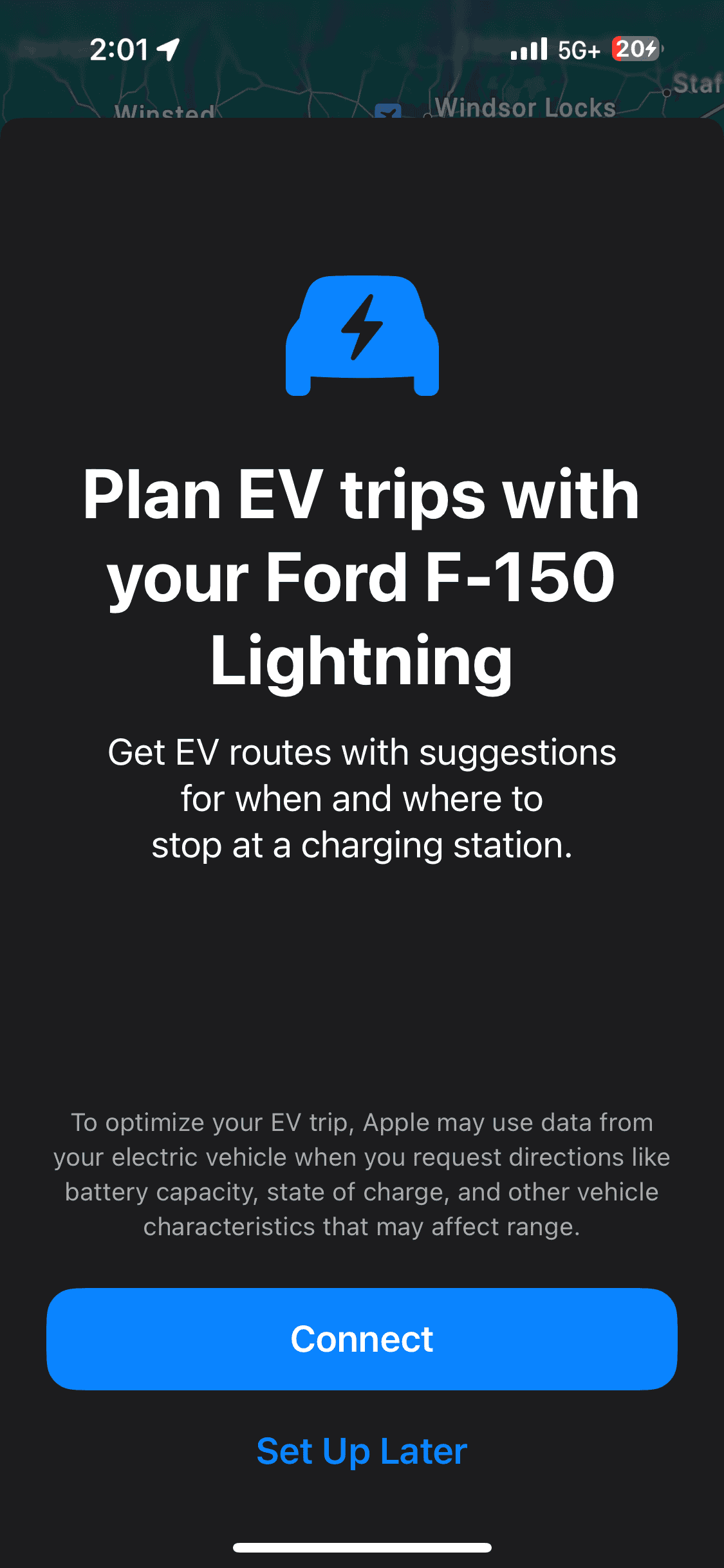

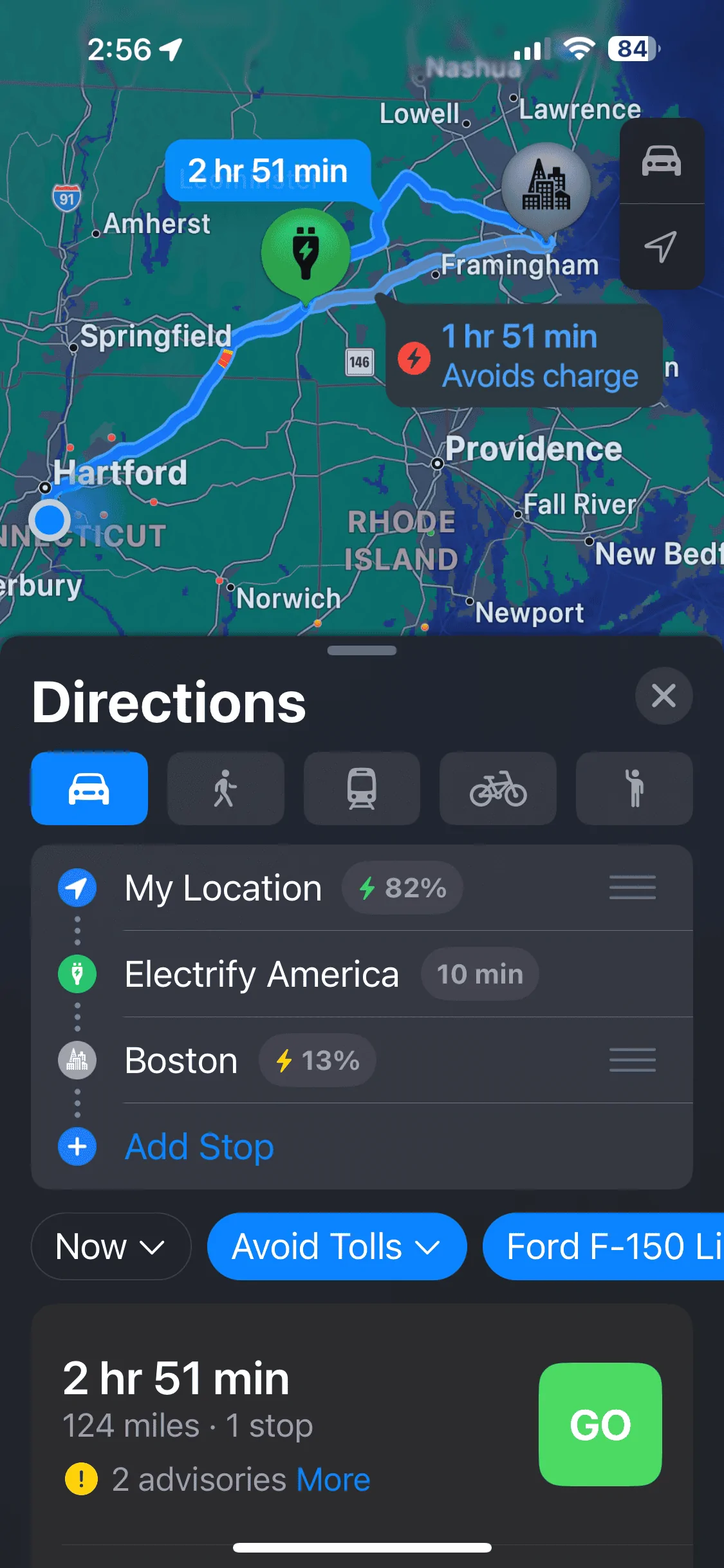

I would use Apple Maps with EV routing. It will continually track the SOC to your destination. I ignore the GOM. I track my efficiency with the current trip meter (miles per kWh). The SR has a 98kWH usable battery so it makes calculations easy. I start all trips with a preconditioned battery and cabin. I drive 67mph and try to use only heated seats.
