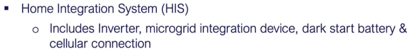

My current guesstimate is that the inverter being referenced is in regard to for this system is simply a small inverter that performs a grid-forming (voltage-forming) output for the truck to feed AC into. This would be a smallish-inverter dedicated to the "dark start battery" now being referenced to come with the HIS.

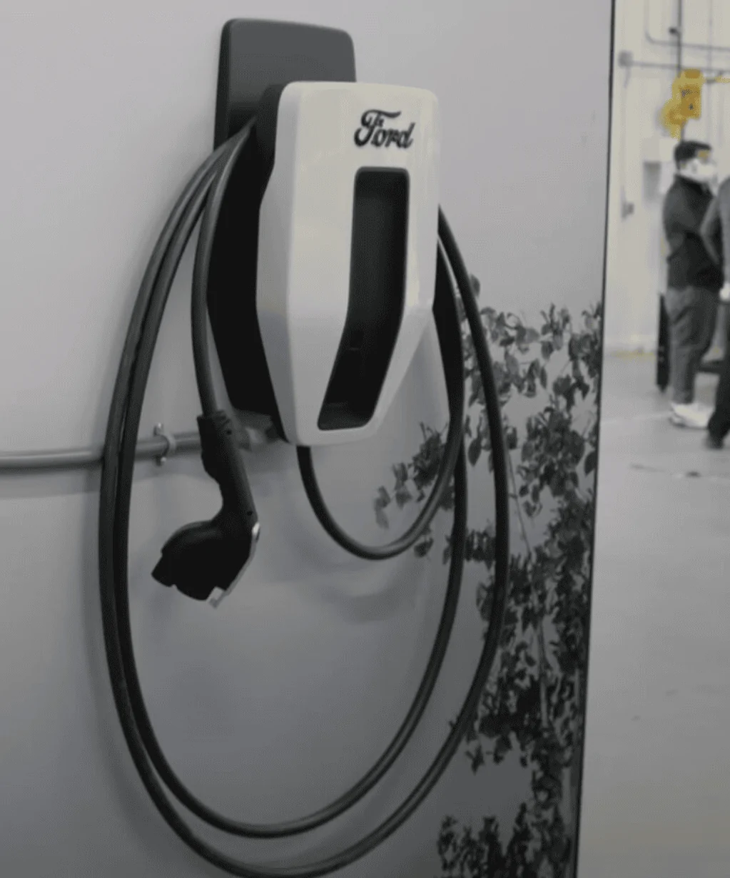

One other piece of potentially supporting evidence here is that a retention slot can be seen in the center of the image with a CCS connector that has been produced (I have never seen the video by Car and Driver this is said to be clipped from). Clearly the end was not placed back in that opening which in this environment surprises me and suggests the CCS end on this cable might not actually fit into the opening. Again, there has been no other indication the end will be CCS other than this photo apparently obtained during a Car and Driver journalist visit.
