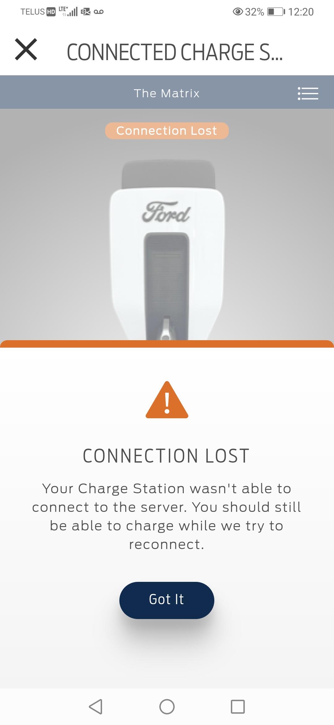

I think a lot of connectivity issues are coming right from the Ford servers as I've had this message pop up in the last week or so:
Ford F-150 Lightning Ford Charge Station Pro not connecting to Pro Charger app for initial set up Screenshot_20230511_122018_com.ford.fordpass

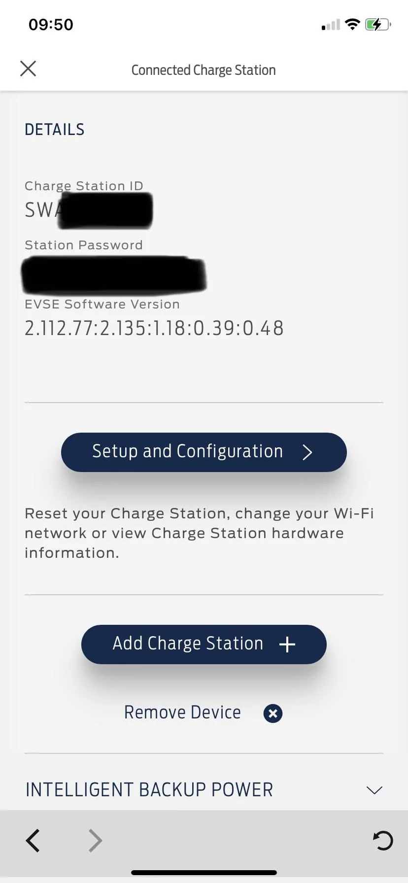

What firmware version does your charge station have?

Ford F-150 Lightning Ford Charge Station Pro not connecting to Pro Charger app for initial set up IMG_3423

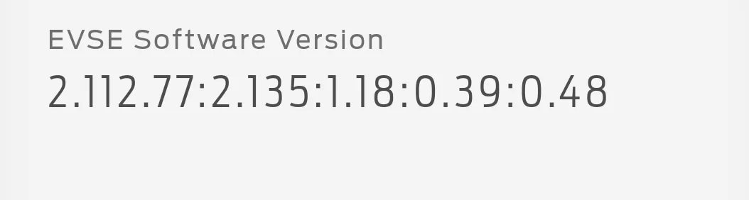

Once you receive the updates, this is what it should show
Ford F-150 Lightning Ford Charge Station Pro not connecting to Pro Charger app for initial set up 1684805531756

That's the base software that the units ship with. Mine took about 5 days to update the first time. Like @TaxmanHog said 39:0.48 seems to be the current one.
Supposedly they're working on a other update to assist with those of us still getting the overheating notifications when attempting to charge at the full 80a rate.

Ford F-150 Lightning Ford Charge Station Pro not connecting to Pro Charger app for initial set up IMG_3429
Each morning, do a power cycle of the EVSE (off then on), then wait 15-30 minutes before checking the connected charge station tile on the Fordpass app, hopefully you will see it update soon.
The power cycle worked! Firmware updated after cycling the power. I’ll monitor the overheating issue that others have had now that I can monitor the charge rate… hadn’t noticed it before when charging. Running firmware version 2.112.77:2.135:1.18:0.39:0.48 now. Thanks for the recommendation @TaxmanHog
