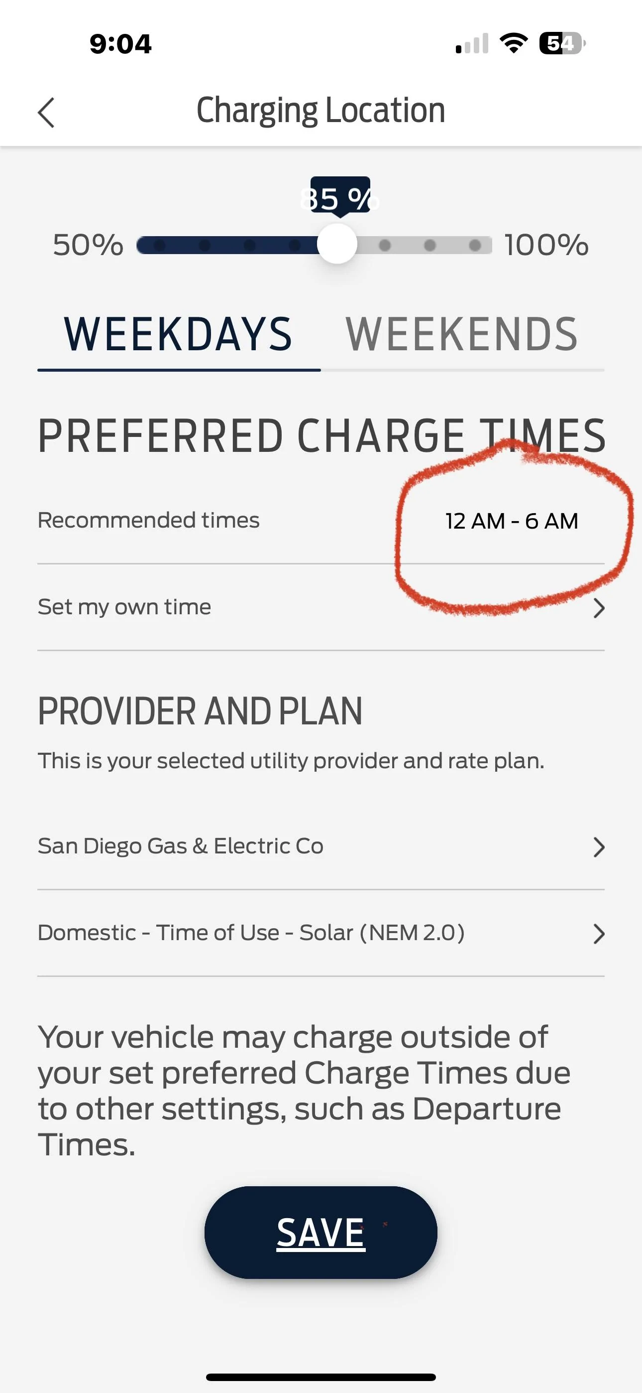

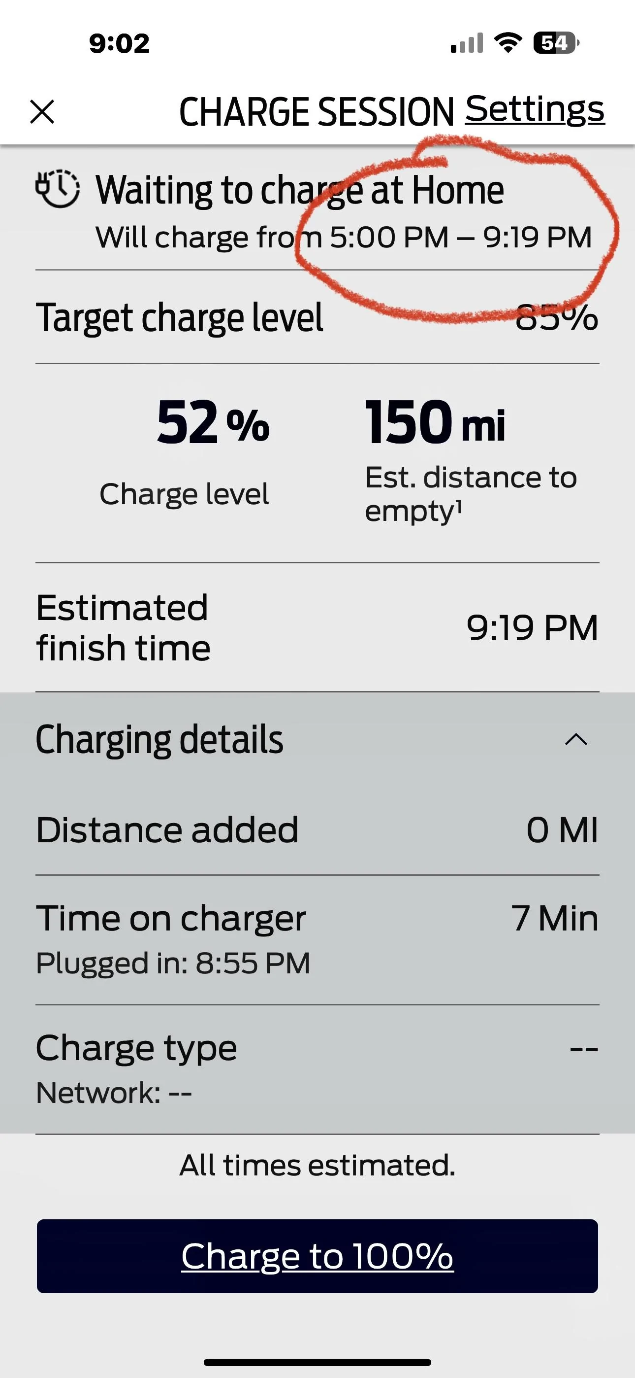

The charging times are set at 12-6am but the charger says it was going to start at 5-9:15pm. It was 9pm when it said that and wasn't charging.

Do you have a Departure Time set? It will charge outside of Preferred Charge Times in order to stop charging right at the Departure Time.
Theory: you have a Departure Time of 9:20pm because you mixed up am and pm?
My suggestion is to turn of Departure Time. You live in San Diego so your truck's batteries will be happy all the time. I live in Michigan and I turned it off because I got sick of it charging outside of my Preferred Charge Times.
I'm making some assumptions here so I might be off.

Version 4.27 for iOS was pushed on Tuesday and I experienced the same issue. Charging still occurred during the preferred time, so it seems it was just a glitch. I haven’t plugged in since.
This^^^
