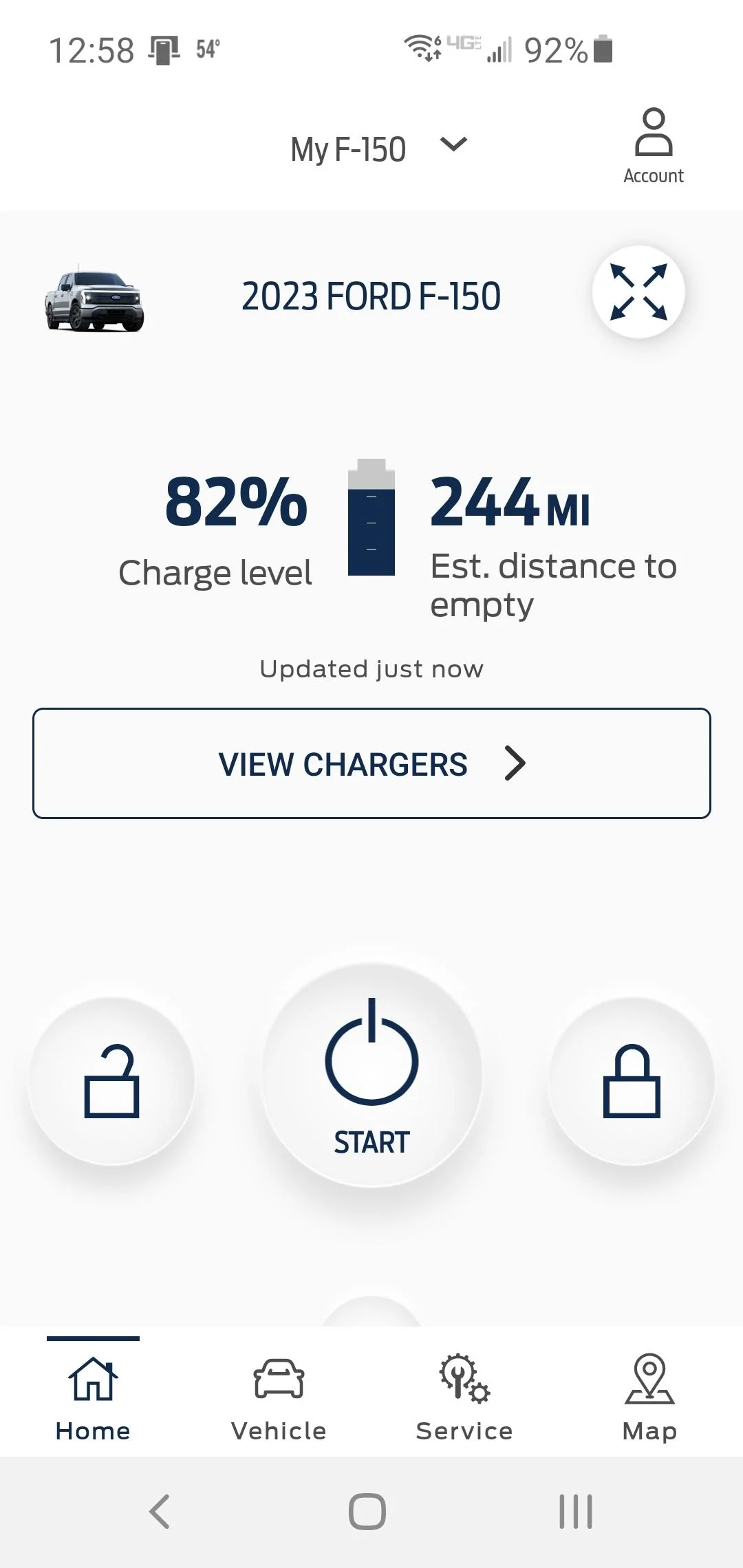

So I wanted to follow-up on this. As I write this, the truck is charging, but I see no indication in the FordPass app that it is charging nor do I see a blue banner at the bottom of any screen. This is what my home screen looks like in FordPass (remember, the truck is plugged in and charging via FCSP):

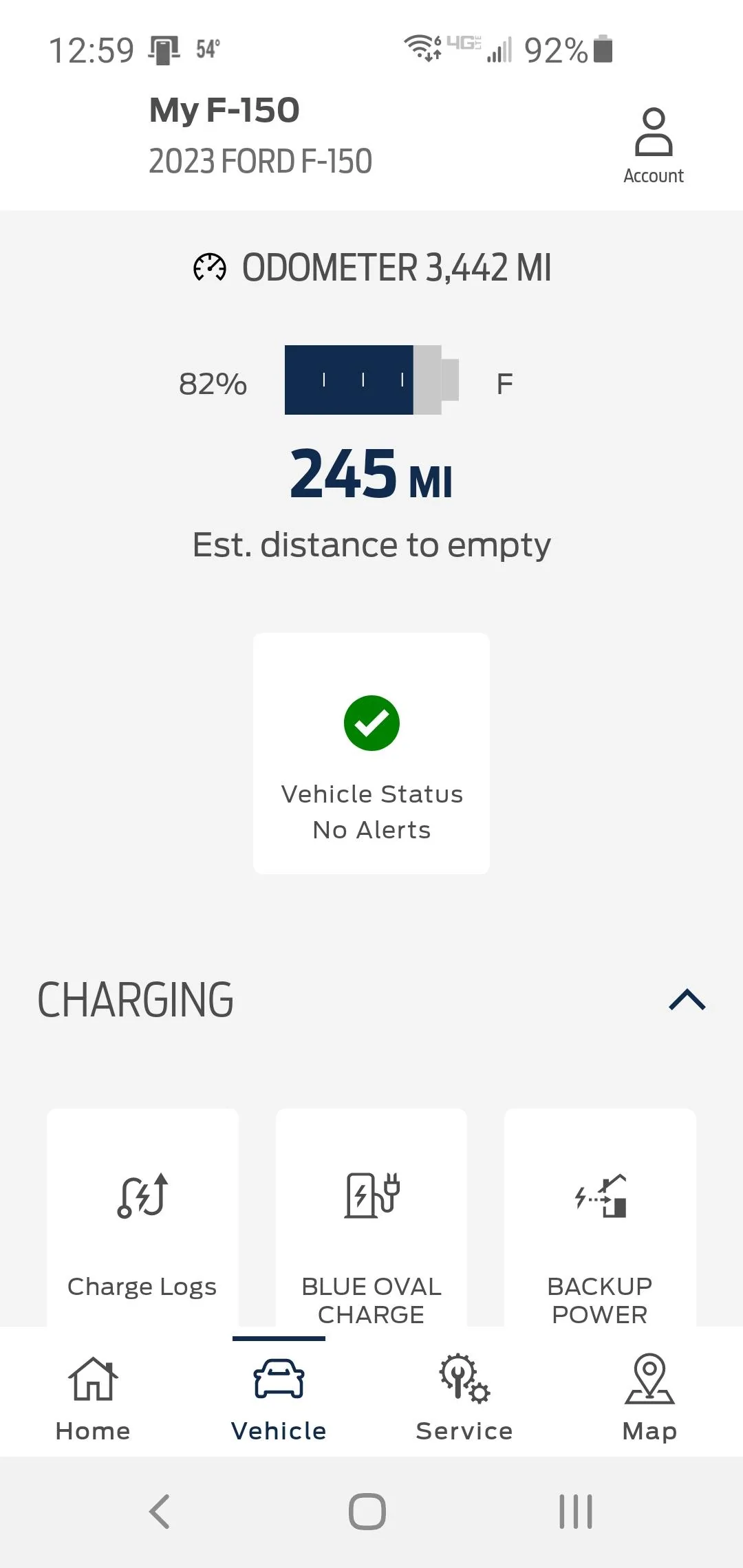

If I go to "Vehicle", this is all I see (I scrolled it to hide my address):

If I go to "Charge Logs", it's completely empty. I will also note that despite my best efforts, I cannot tell my truck what my home address is. It assumes the long/lat of its position on my driving is associated with the home address across the street, not mine. I park it in the same spot in the driveway each time I return. It seems like despite being plugged in and charging, the add refuses to acknowledge the truck is charging. Over time, the SoC value does increase so I can see an update as to the SoC, but no details as to charging rate, ETA, etc. What a crappy app. Any thoughts or ideas what could be wrong?

Do you have all the data sharing approvals ON in the sync screen in your truck??
Check your data sharing approvals on the trucks Sync screen.

When I set up my location based charging profile, it was in the tight confines of my garage with very little room for variation, as I built that profile, I left the automatic GPS coordinates it picked up as my precise location, configured the maximum SOC and weekday / weekend time frames, then save the configuration.
Once built, you can then edit the name as Home, Garage, work, etc..... without overruling the GPS coordinate, ignore what it associates as a street address, mine associates my location as my neighbors house 150 feet away, just leave it as is other than a friendly name change.
But you still need to approve data sharing otherwise you won't get the details posted to Fordpass.

Your issue is 100% due to you turning things off to protect your privacy. Turn them all back on, verify everything works.
Regardless of being "home" or not, you would see the charging data.
THEN, if you for some reason see a need to do it, turn off ONE thing. Now, go verify if all the things you think should be working still are.

I wanted to do a final follow-up to this thread. After some experimentation, I discovered that when the setting "Share Vehicle Analytics" is enabled, it restored the Ford Pass charging functionality. I can now see the blue bar indicating charging status and the instantaneous power being delivered. Additionally, the app notifications when the truck is fully charged started working. Thank you to everyone that pitched in to help with the solution.
