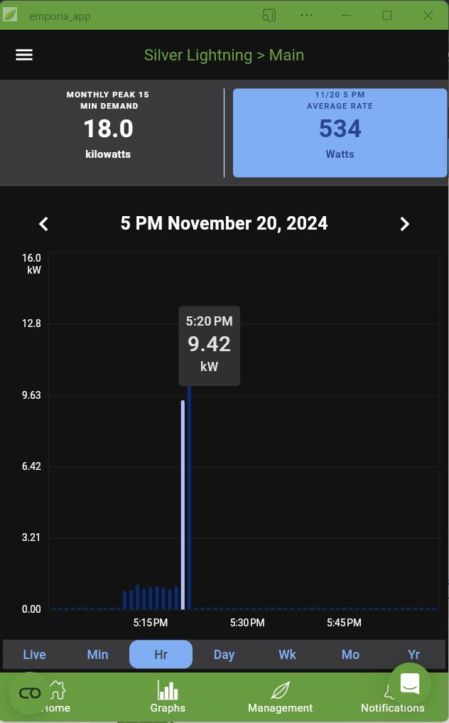

I had a weird event occur yesterday afternoon & last night.
Initially I had set up a 6am to 9am charge window, figuring that is enough time for our routine.
Plugged in the truck at 1:39 pm, previously I had already set up charging scheme for a specific time frame, early mornings daily, this will be my method of operation through the winter to leverage the minor heating value of charging and energy replenishment, our short trips are negligible, it's not cost effective to prepare the battery, all I need is a warm cabin.
The truck started to charge on plug in for four minutes, then it stopped all by itself:
Ford F-150 Lightning Ford Pass Has Worn My Patience Thin 1732206302201-f3

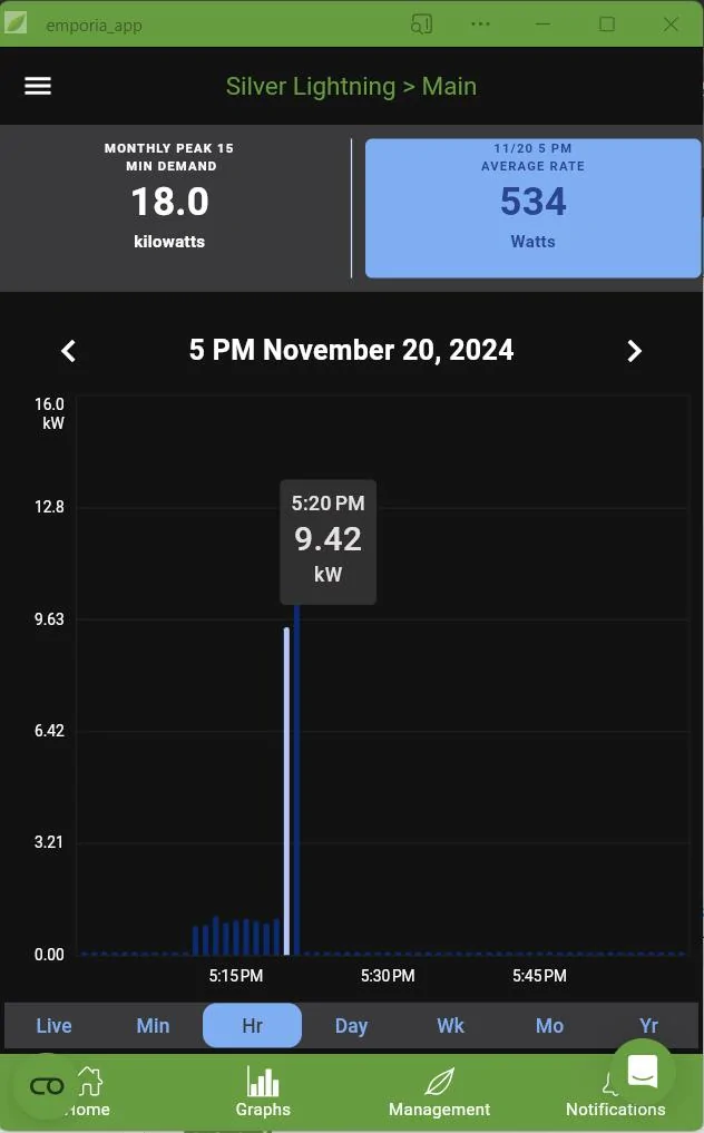

Then at 5:11 PM it started to charge at a very slow rate for 8 minutes, then a higher rate for 2 minutes, then stopped on its own at 5:21 PM. The outside temps and in the garage were upper 50's so I don't think the truck was calling for battery protection, and the Fordpass charging report showed charging energy being taken on.
Ford F-150 Lightning Ford Pass Has Worn My Patience Thin 1732206424018-xr

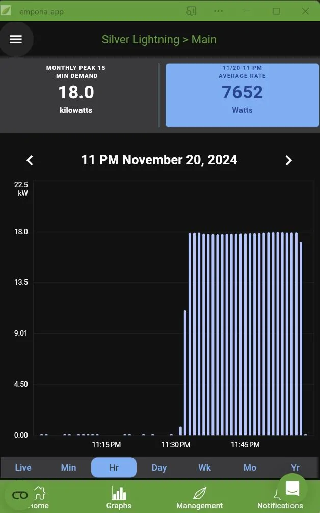

At 11:31 PM I decided to make a slight adjustment for this mornings charge session, new values would be 7am to 9am, I did this adjustment via Fordpass v-5.7.0, saved the change to the cloud.
The truck responded with immediate start of the charging routine instead of continuing to wait until 7 am this morning, I let it continue, think it might self pause after a couple of minutes, but that did not happen, and it continued at full charging rate until my SOC goal of 90% was reached at 11:58 PM
Ford F-150 Lightning Ford Pass Has Worn My Patience Thin 1732206650472-6u
Clearly the charging controls are not complying with our desires and tweaking them in any way while plugged in is certain to cause unintended consequences, the issue is either logic in the truck, Fordpass or combination of both.
