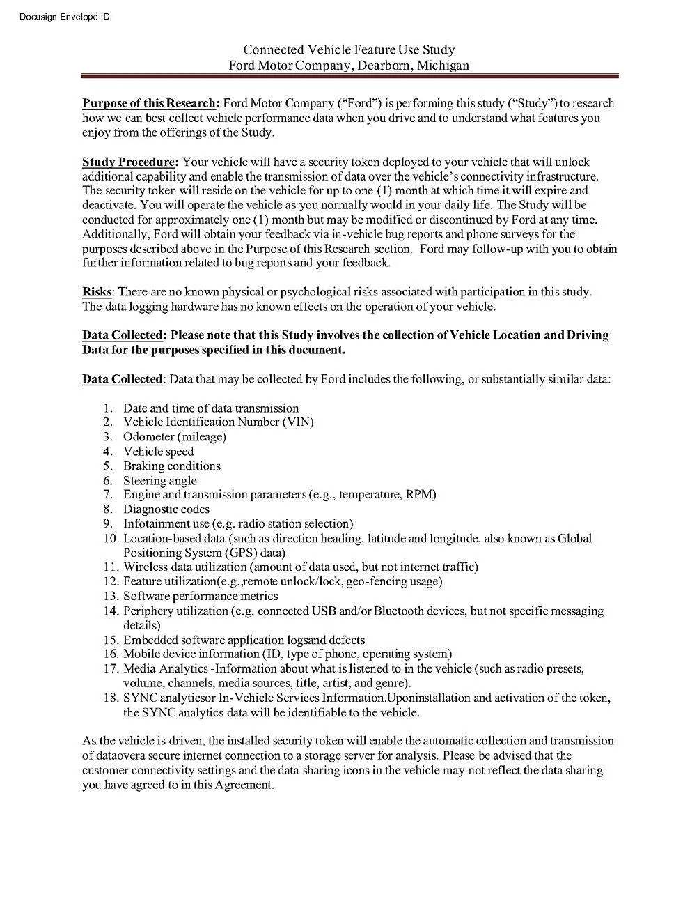

No direct benefit was promised me. I assumed that the monitoring was to determine whether the supposed update to truck modules to fix the HIS system interfered with the performance of the truck in any other way. The tokens were supposed to monitor what was going on with the ECG, TCU, and APIM modules.
Since I was told that nothing about the testing and agreement was subject to non-disclosure, here's how the first page of my Docusign document read. I figured Ford could already determine a lot about my vehicle use, and I have been using Waze and CarPlay. I don't have any concerns about being monitored as long as someone doesn't use information about when I'm not home to rob my house, etc. If you use a credit card, your every purchase is monitored, and the information is resold to "business partners" of the credit card company. So you're already living in a glass house.
My conclusion, as discussed in other threads, is that Ford has not yet fixed the Home Integration System. Using the UNLOCK button press, charge head removal and reinsertion, I can get my system to transfer backup power 100% of the time, but manual intervention is required more than half the time. The HIS equipment (most likely the fault of the truck and FCSP) cannot be relied on to initiate a backup power transfer automatically.
