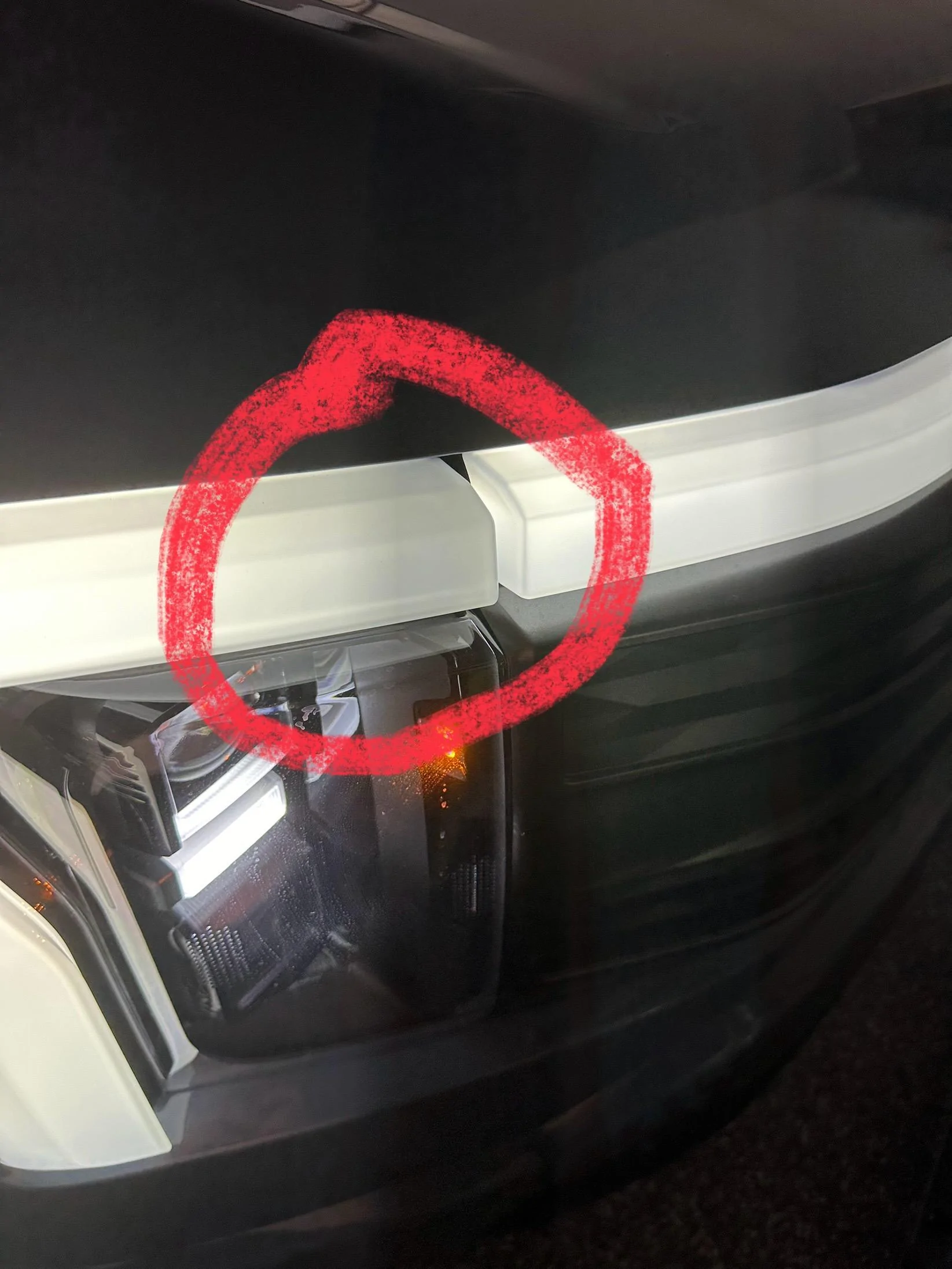

Anyone else having issues with their front light bar partially lit? Noticed last night the section around the passenger headlight and half the frunk not lighting.

That looks like a defective of some kind. You could try pulling the negative on the 12V battery and waiting a minute and reconnecting to see if it resolves itself, but my guess is it needs to be replaced.
Disconnected 12V. Light bar came on for 1/2 sec and then back off.

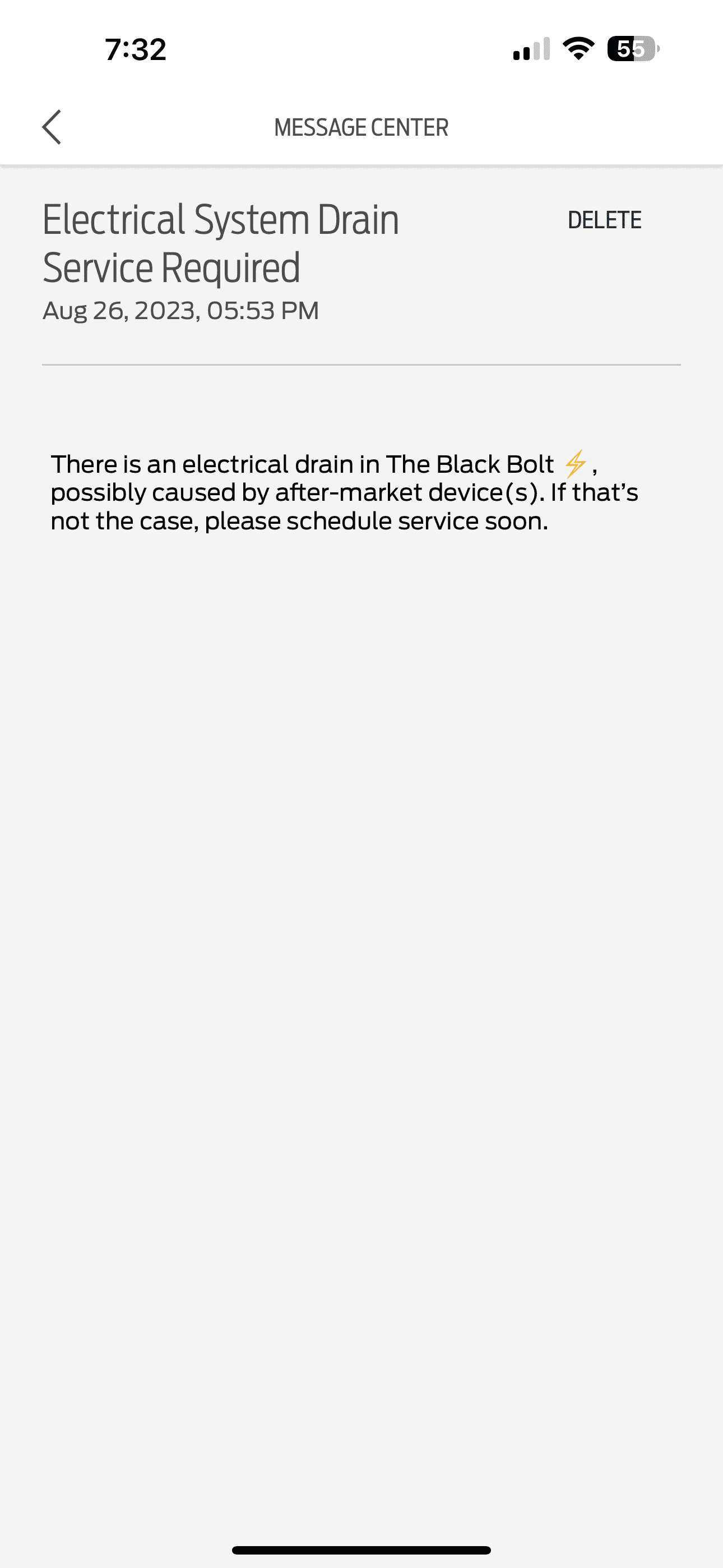

Mine started with this problem 3 days ago. But in addition to the drivers side half of the light bar it also includes the whole drivers side head lights unit. I tried cycling the frunk. Have not tried disconnecting the negative lead on battery. Sort of makes me think a fuse issue. Not sure probably will have to make an appointment.
Lightning Man
Jul 25, 2022
Boston
F150 lightning
I did get this message on 8/26. But then went away. Pretty strange as I don’t have any 3rd party devices or anything like that. I’ve had the for a year now as of tomorrow lol first issue I’ve had

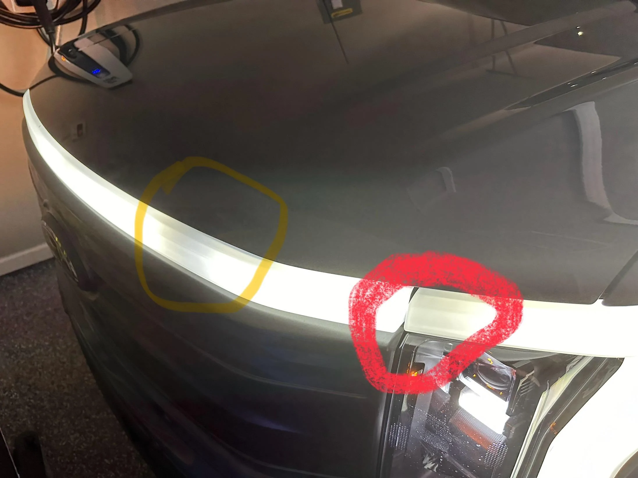

My dealership confirmed the center light bar needs to be replaced bc of a dead spot (yellow circle), they tell me the dead looking spots circled in red are normal. Does everyone's look like that?

Sadly - The corners of my outer lights above the headlamps have that small dim portion like is circled in your pictures, so you are not alone.
I never spoke to my dealer about it - just assumed it was the connection area where there was not a diode.
