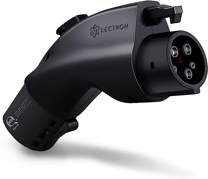

I've used:
Ford F-150 Lightning Daily charging with TeslaTap or mini? 51VxrVQhZcL._AC_SX679_
for about a year with no issues before I finally got around to installing the Charge Station Pro:
https://amzn.to/3RULpHB
Never had any issues at all. Worked on my home Tesla wall charger and took it on the go in case I came across any Tesla Destination chargers.
