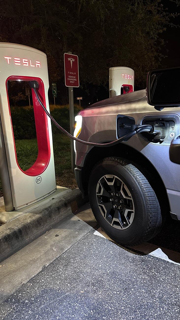

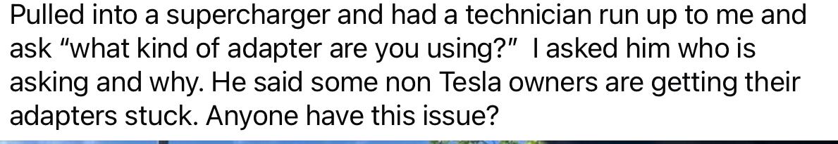

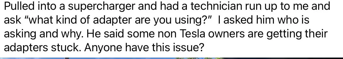

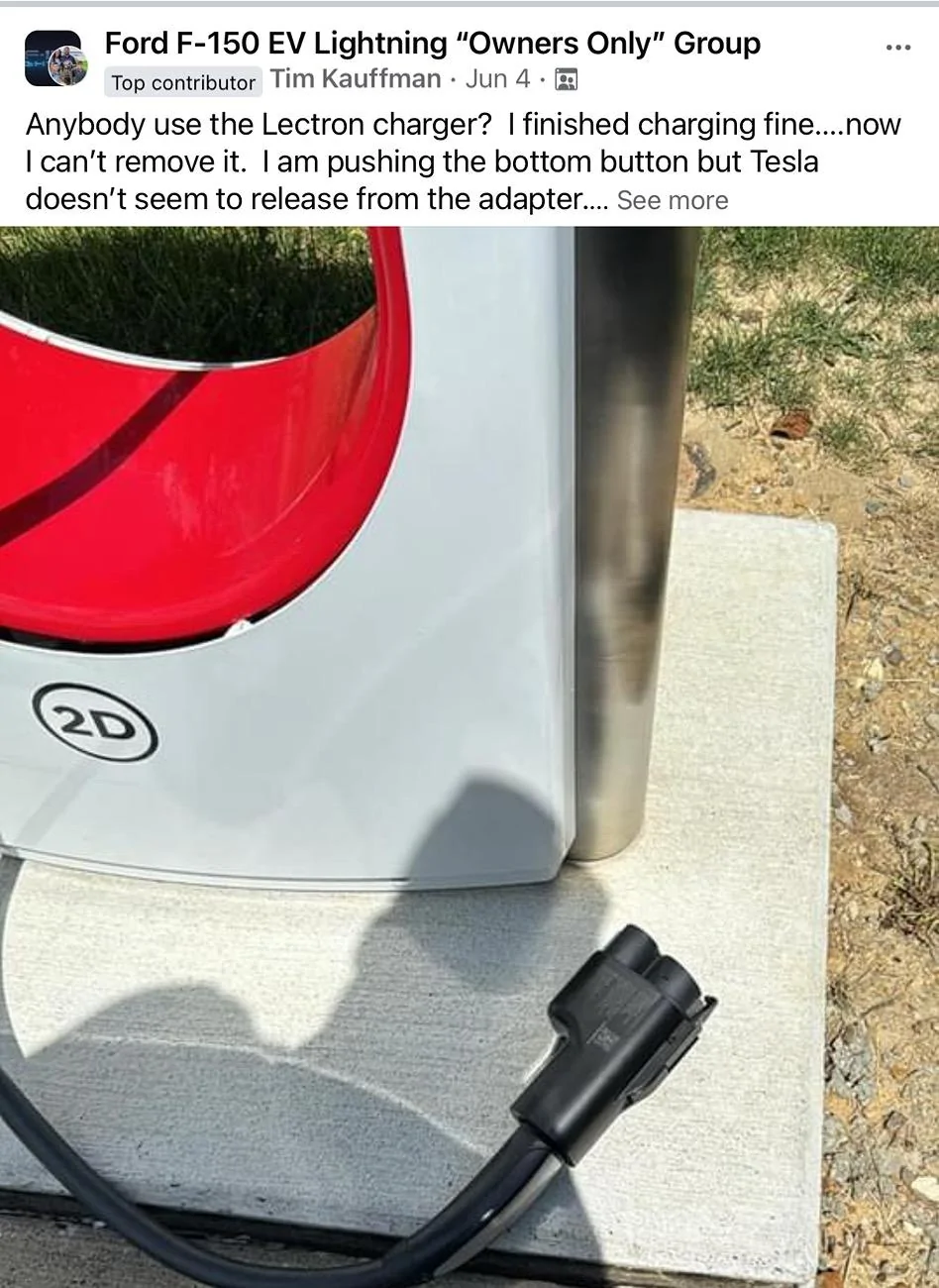

I would recommend the A2Z instead of Lectron. You probably can’t get is as quickly but there have been a number of problems with Lectron. Some people have had difficulty getting them to release from the Tesla connector and have even had to abandon them at the charger. The original A2Z can be tricky to get locked but they just switched to an improved design the should solve that problem.

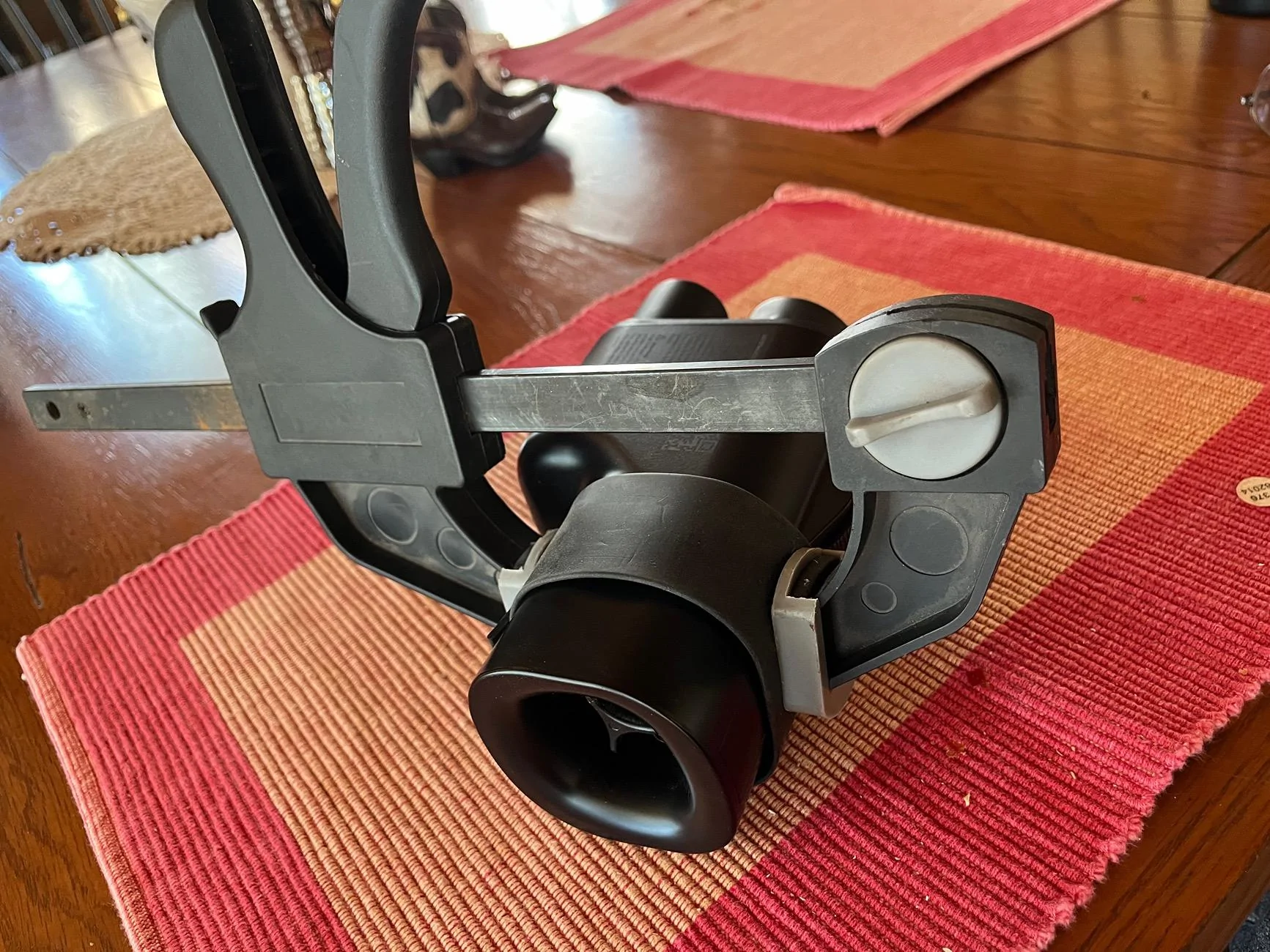

And he did have a past problem with pulling out the Tesla NACS plug unless he let it cool off a bit. He actually did a modification by Dremeling (grinding) a bit off the inside moving latch of the adapter receptacle and he says the sticking problem has not reoccurred. His also a newer Vortex direct from Lectron since the recall was issued. Another person said they needed to use a clamp to press the release button firmly enough to have it release, but I do not know when that one was purchased. Previous Vortex units were too loose in clamping? And some other recall for pre-May '24 units?
I wonder what the idle charges will add up to ?

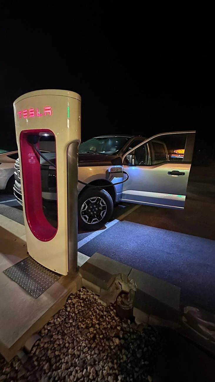

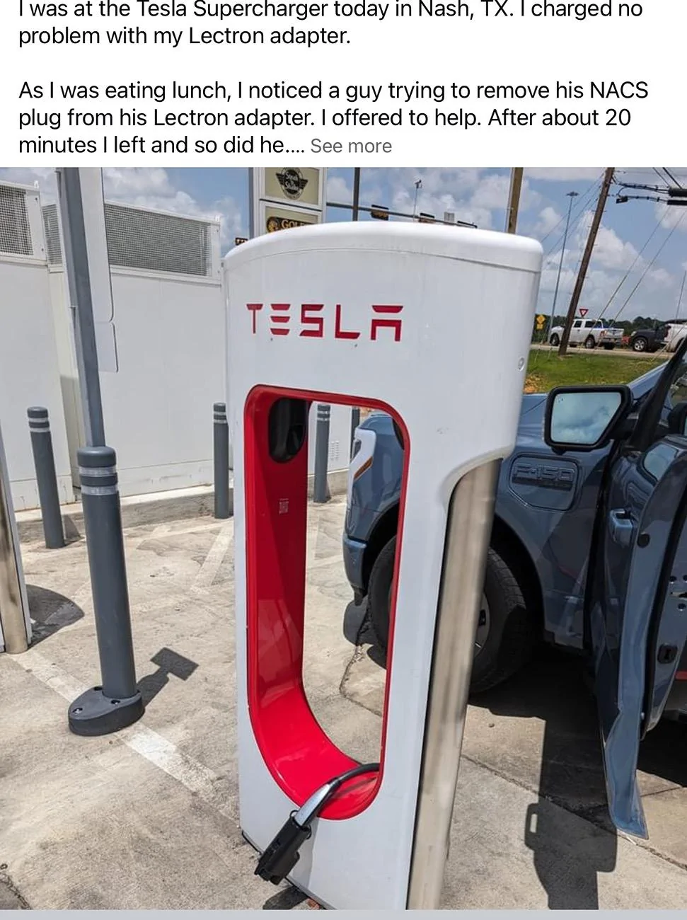

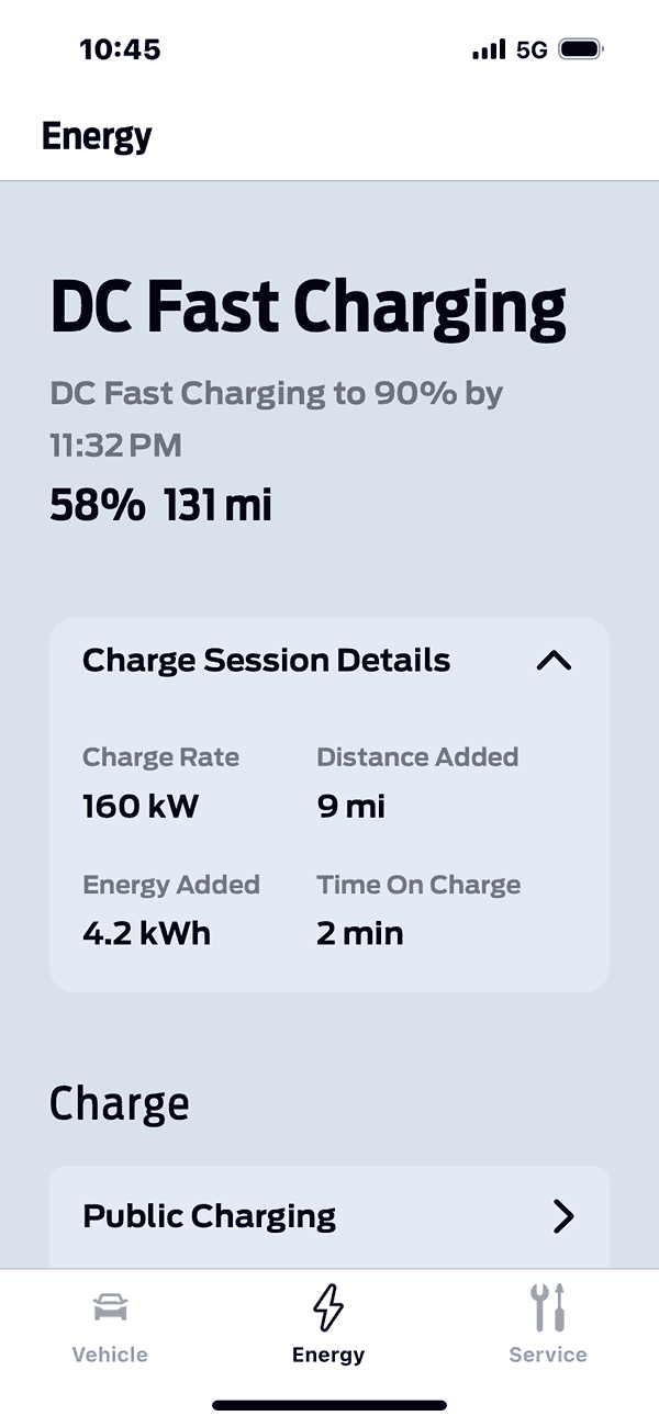

LECTRON and Supercharger charging for no less than 16 times in the last month, over 1,000 miles up and down Georgia and FLorida, and not a single issue.... works great.

I’ve posted elsewhere on the forum about my experience with the Lectron adapter I ended up using a clamp, but since reading about Grinding down the catch with the Dremel tool, I tried that. It seemed to work perfectly. It doesn’t take much and really isn’t very difficult to do, but if you have the time I would probably go with. A2Z
