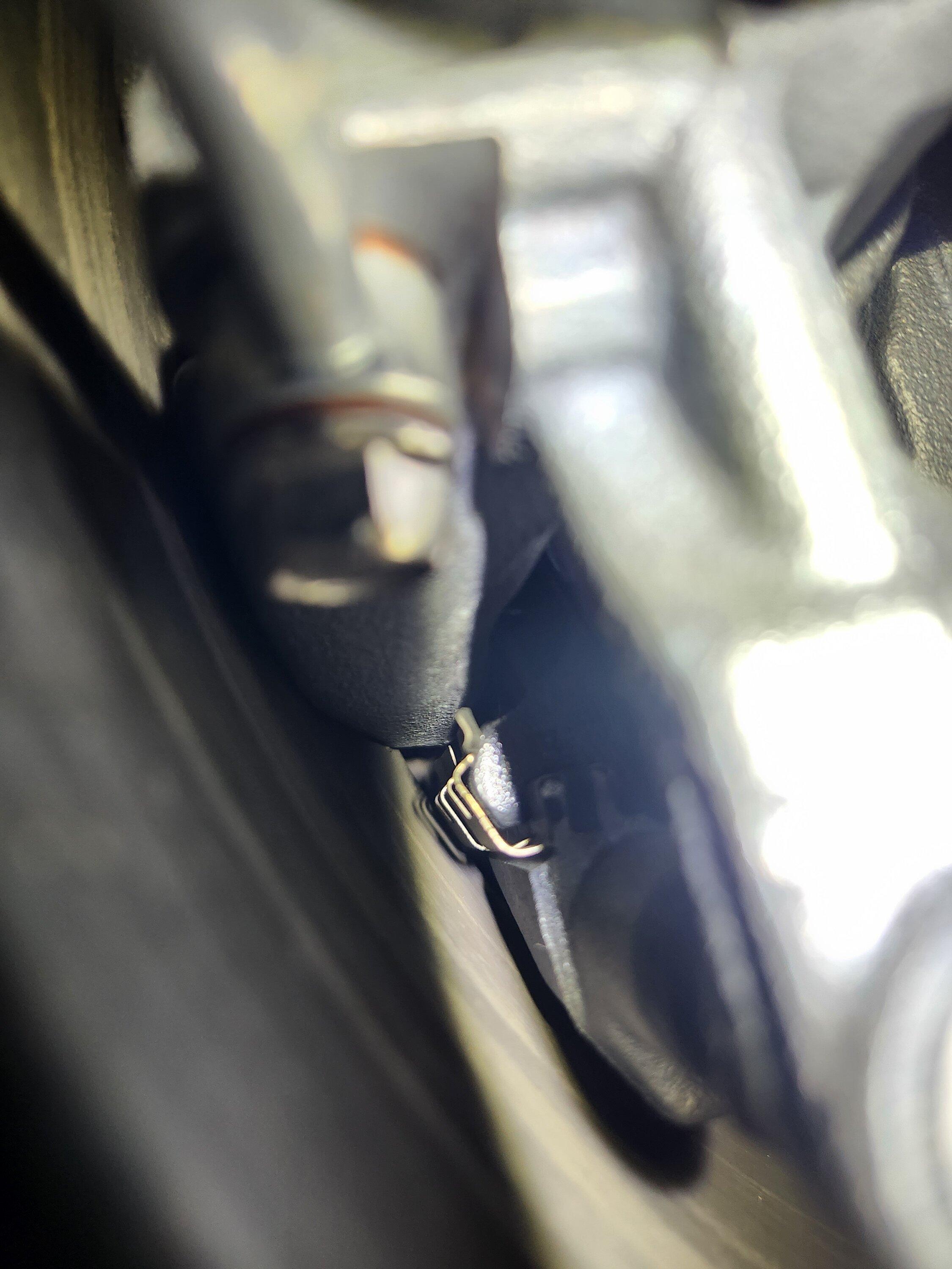

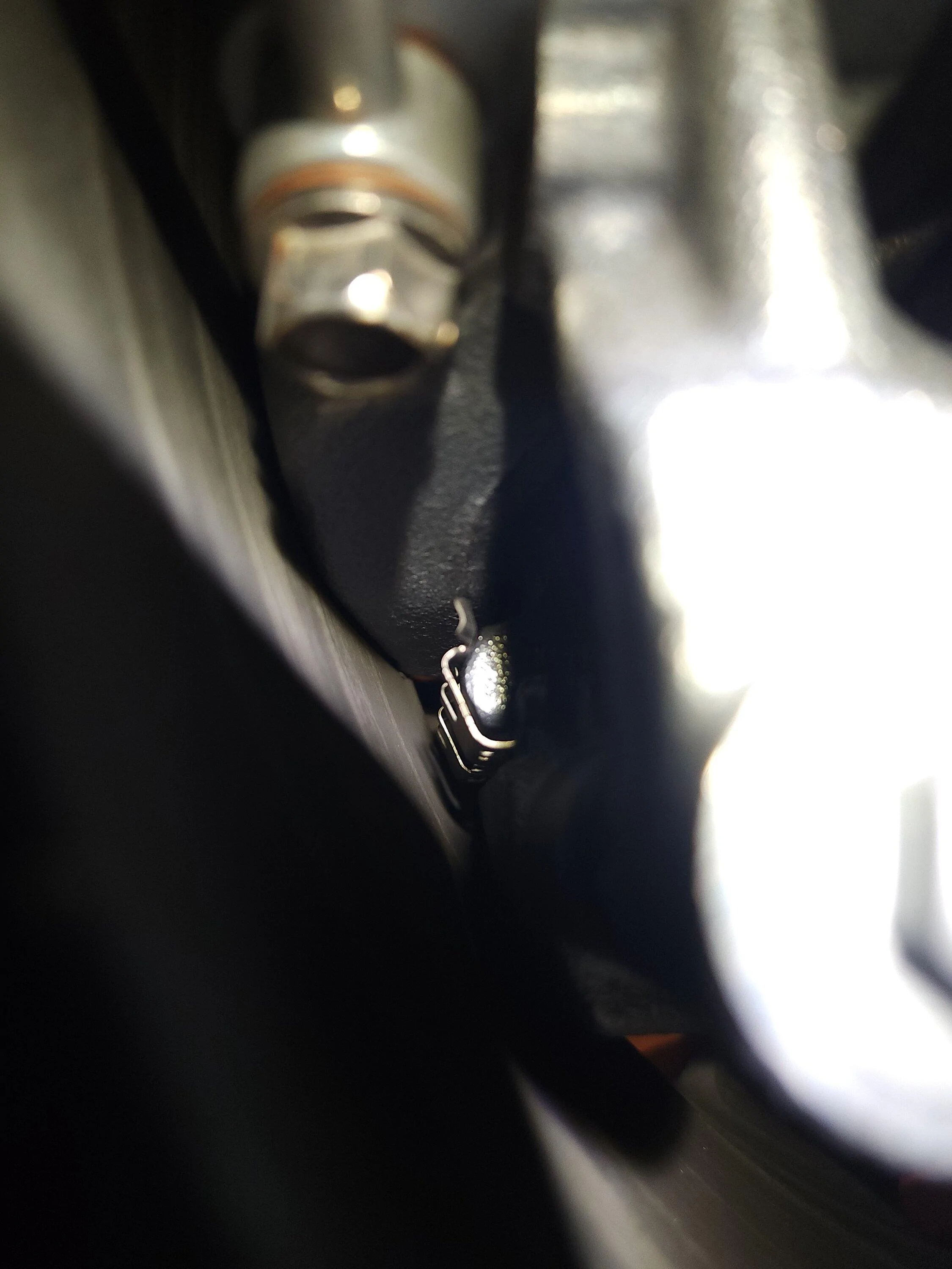

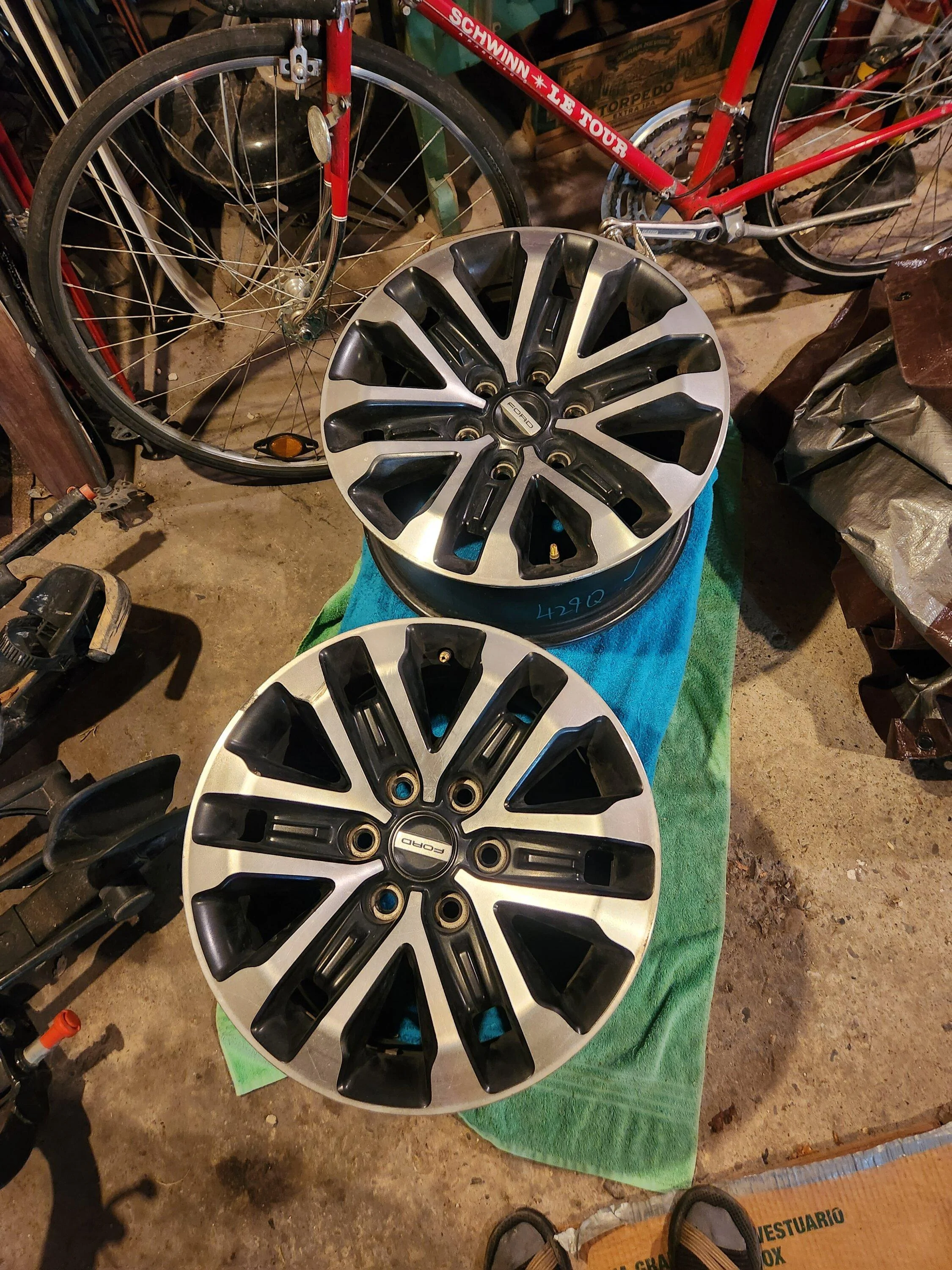

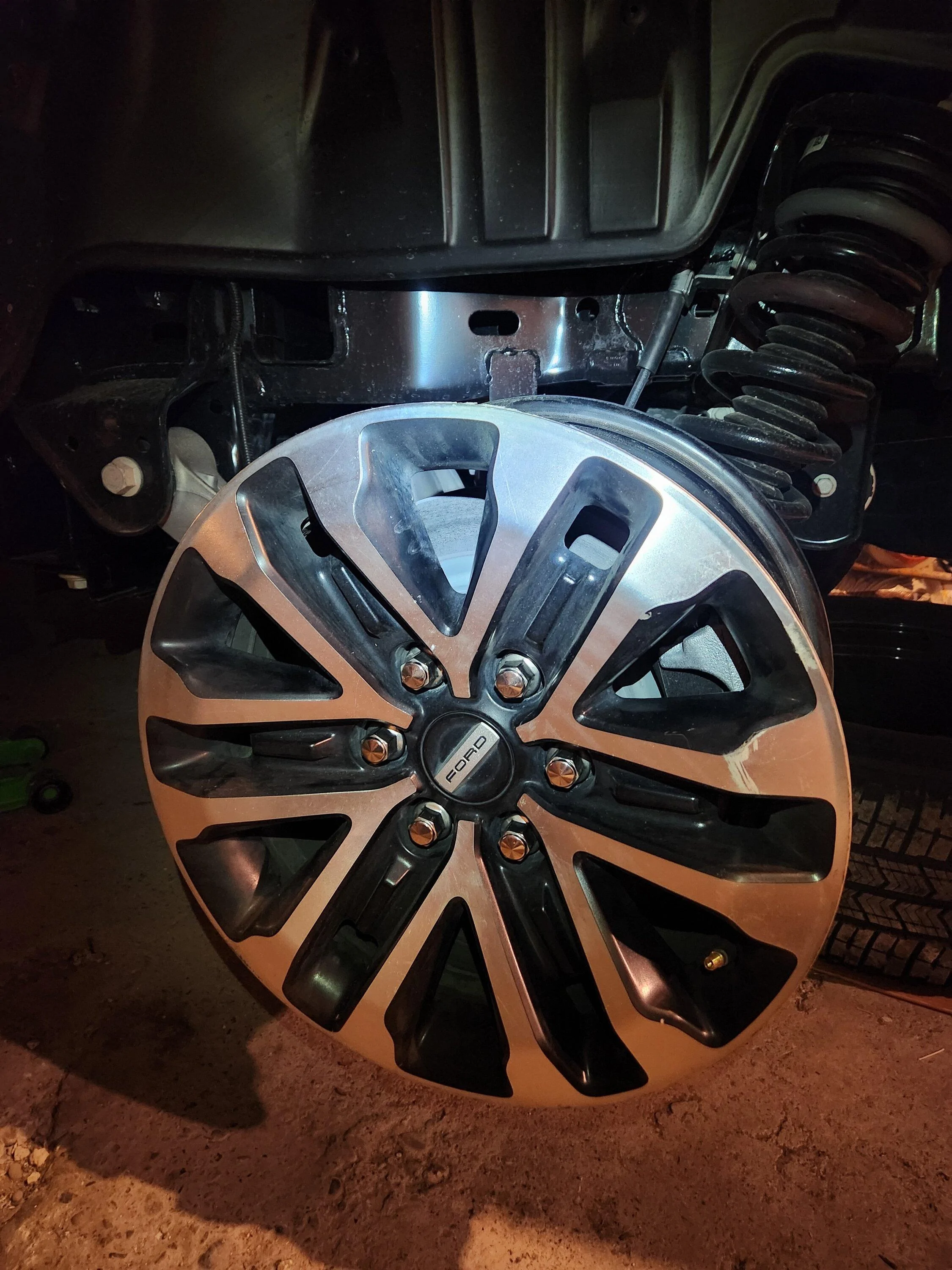

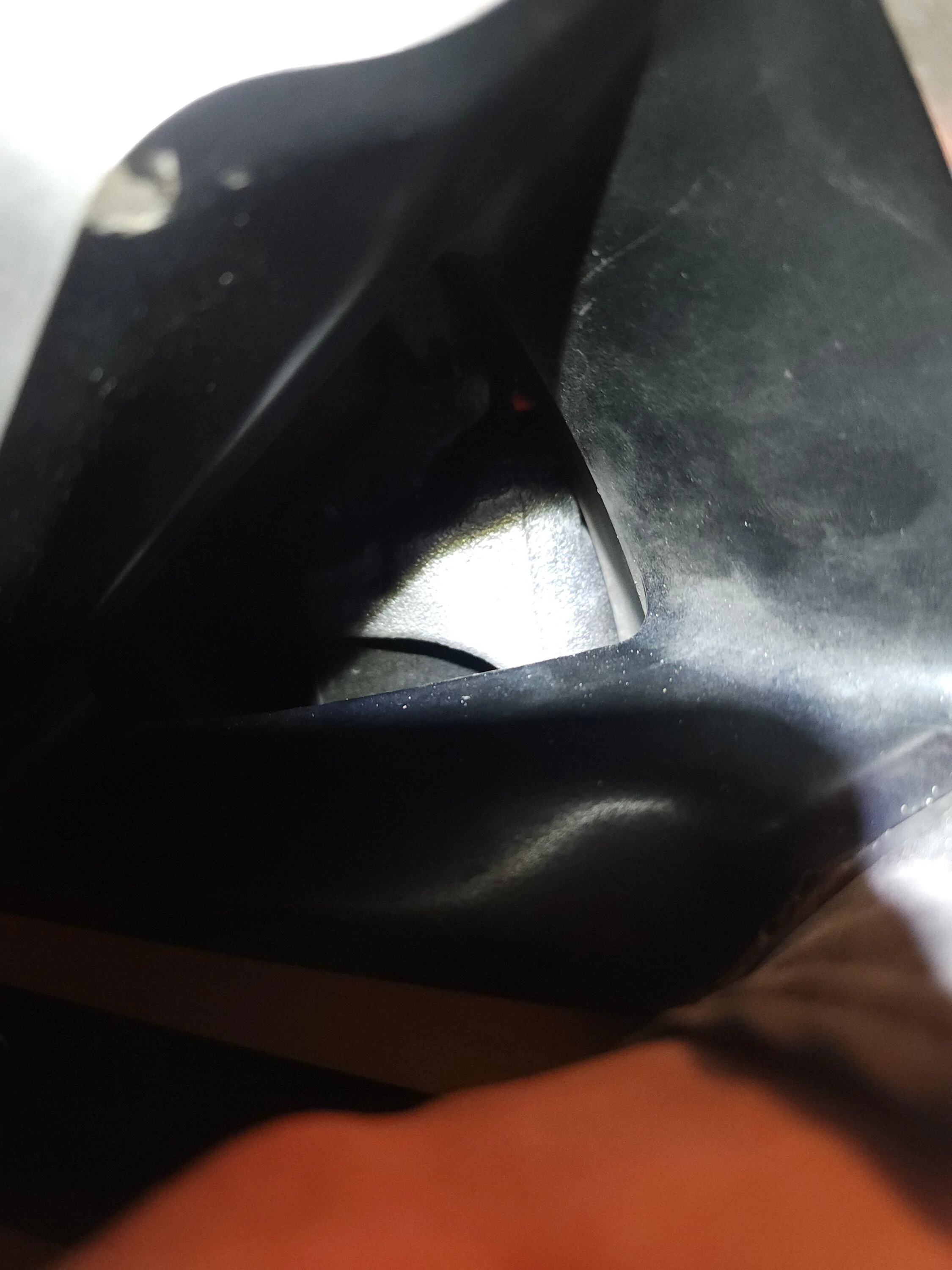

So after reading a few comments on here, it sounded like Raptor wheels would work on the Lightning. Well, I just tried on my '23 Pro with Max Tow and the calipers are rubbing on the outside and maybe a little on the outboard edge as well. Might work with an offset but not stock. I think these are like 2018-2019 ish Gen 2 raptor wheels. Maybe other versions have a bigger ID.
