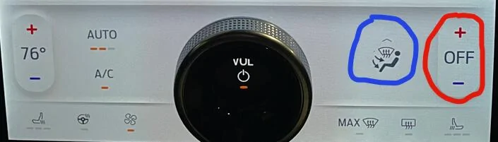

I have the Lariat with dual climate, and I have noticed that if no one is in the passenger seat, the climate does not come on on that side of the vehicle! I find this strange, but it is what it is!

@Scorpio3d - there is a setting in the HVAC mode menu for Driver Focused. It will turn off the vents like you experienced. You can turn that setting off (which turns the vents on). When on, the temperature displayed on the passenger side will be OFF instead of 72 e.g.
I never checked the settings as I don’t really care because it keeps me cool???
But it is good to know so thank you!

Wait…maybe I am misunderstanding!
The picture above is what mine shows unless someone is sitting in the passenger seat then it will show the temperature?
Correct. When driver focused is on, the passenger temp will be off if no one is sitting there. The picture above shows driver focus on. The HVAC only cares about the driver.

So I checked it tonight as I drove to dinner, and even though the passenger temp shows off, I reached over and I could feel the air conditioning coming out of the vents on the passenger side…. So I’m wondering how or if this even works? I always assumed it was not blowing out of those vents if it showed off, but apparently it does.?
2,767
3,919
I’ve never tested it. I thought I read it only worked for heat since that uses a lot of energy. But others reported it works for AC too. ?‍♂
But these vehicles are getting more sophisticated with how they do air movement so maybe Ford has a reason to blow some air even when they show it’s off. My wife’s Hyundai will automatically change over to recirculate (no outside air) for a few minutes when you operate the windshield washer. Says it’s to keep passengers from smelling the washer fluid.
