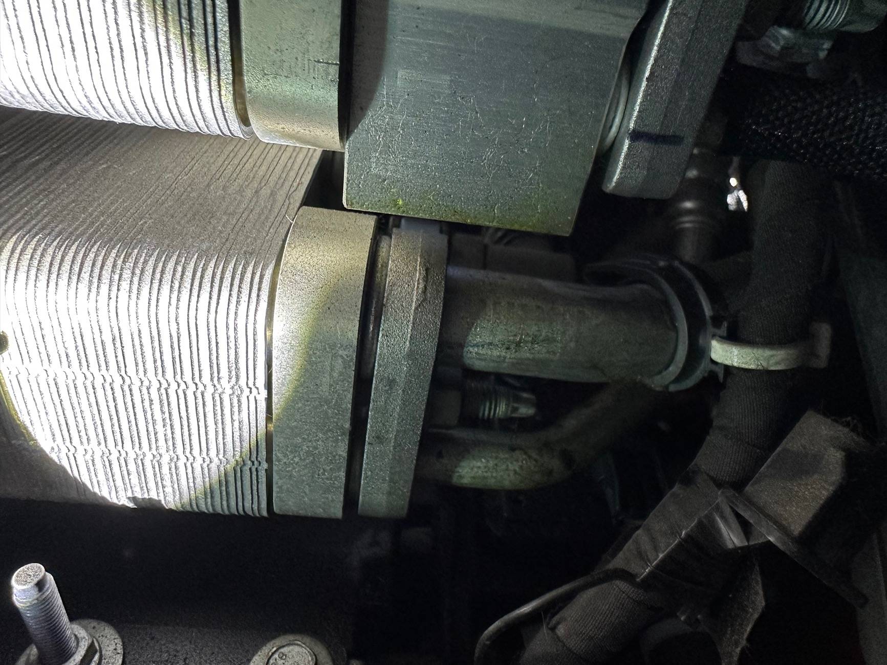

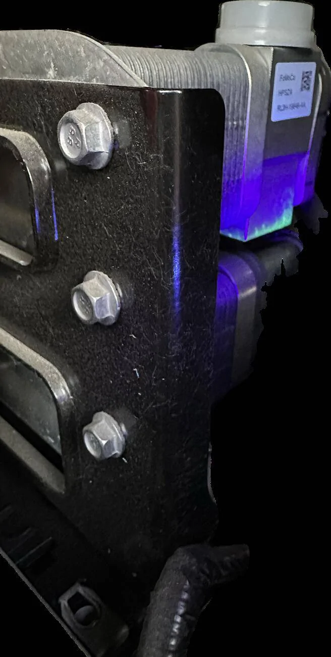

My Flash AC leaked out. Bad Oring around a sensor. You could see the OIl all over next to the 12 volt battery.
If you have Forscan check the Evap core temp.

I don't have forscan, unfortunately.
Spent a few hours at the dealer yesterday, new sensor installed, no fix. They are now ordering a new compressor.
Frightening comment from service advisor that they only had pinouts from a gasser to work with and they don't match, uhmmm, yah, yikes.
