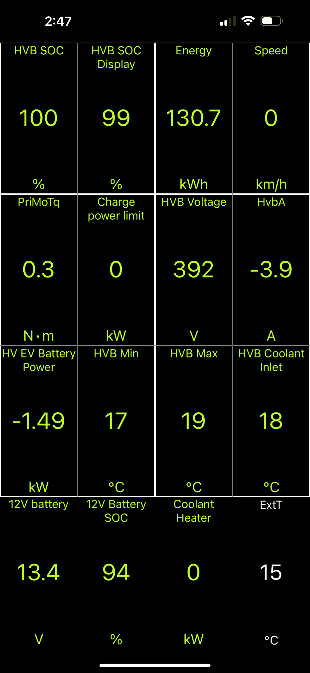

So I did that, I got it down to 15% and charged it today. But something weird happened (or at least I think so) and the truck stayed at 99% for 2 hours while continuing to pull 6kw (mobile charger). In the end, it got charged to 130.7 as shown below, and 100% HVB SOC, while the dHVB SOC Display stayed at 99%. I unplugged and plugged back in, and the truck displayed 100%.

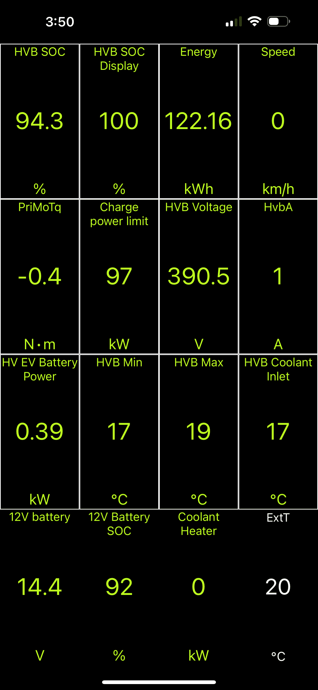

After this, I took it for a drive immediately to burn off some of the battery. What I got was below. Now the truck was at 100% displayed SOC, while the HVB SOC was 94.3 and energy was 122.16

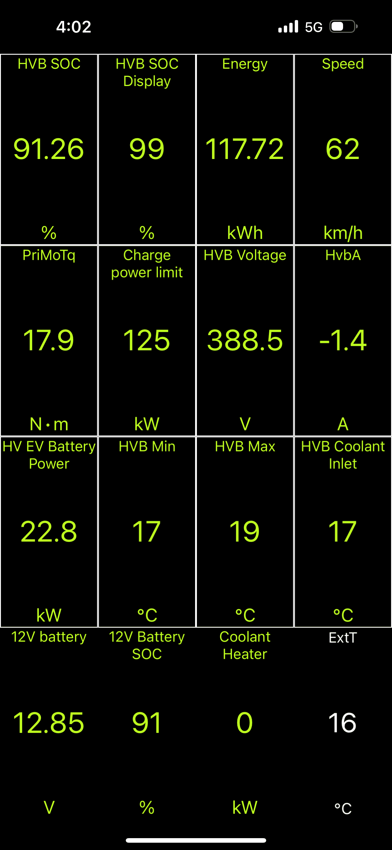

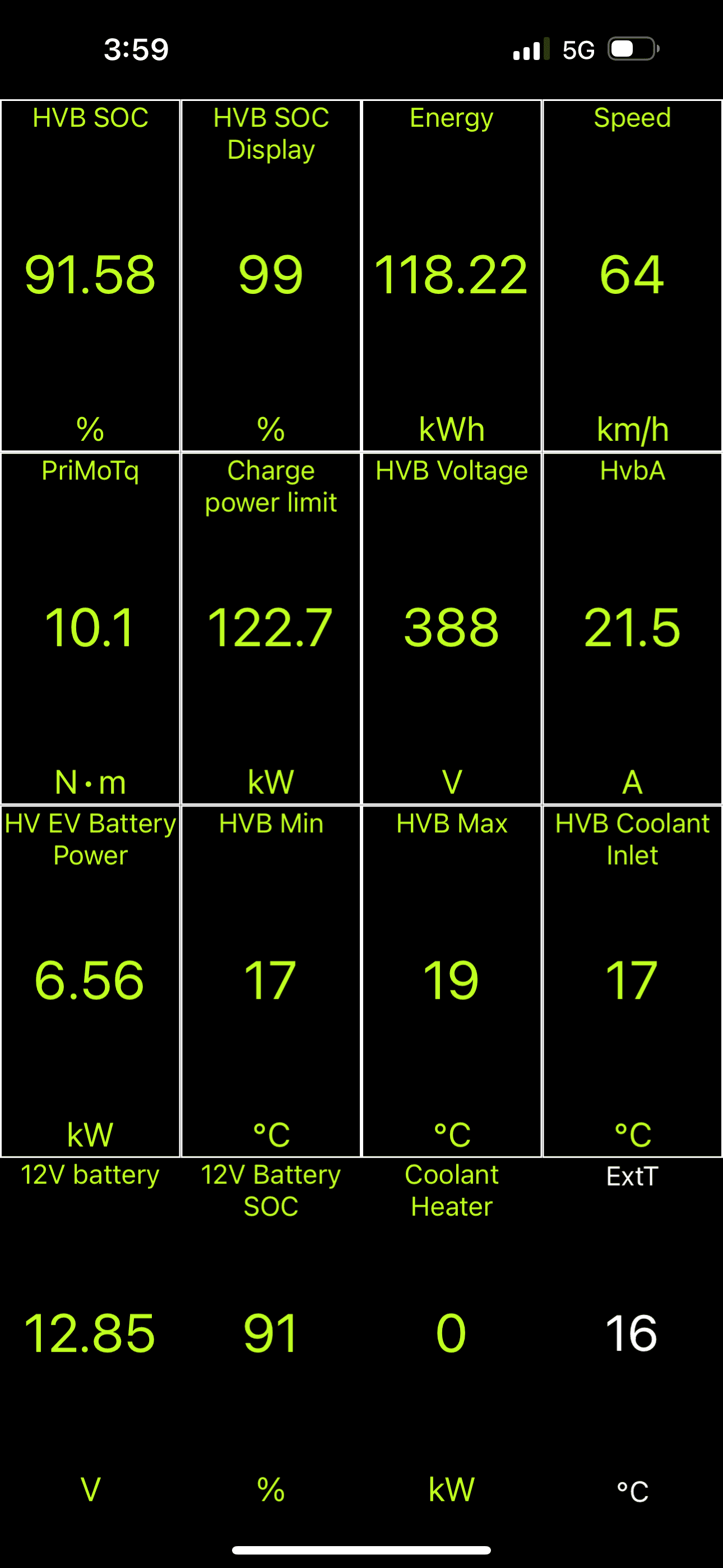

I kept driving and this was where the display SCO finally dipped below 100%

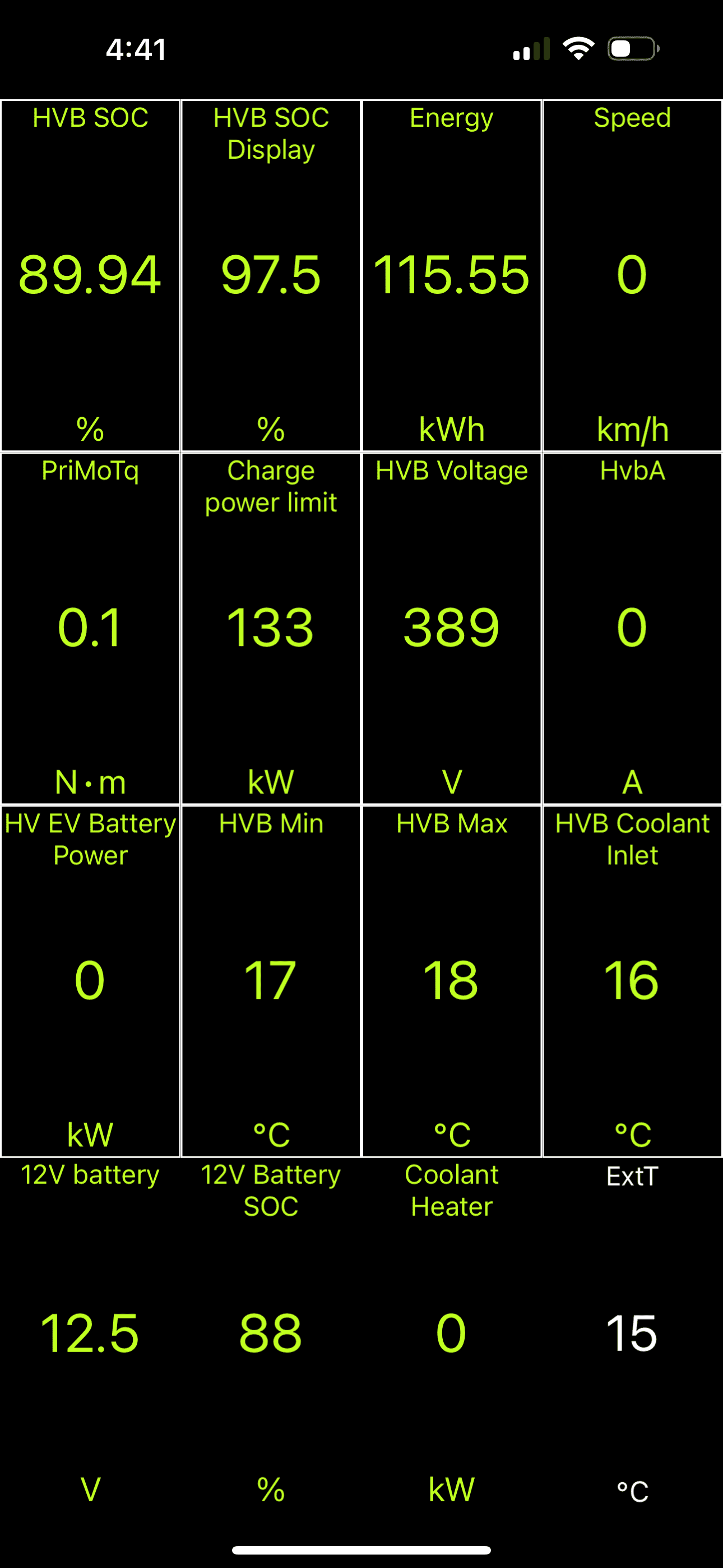

So now I have questions what 100% in my truck is or if there's a way to correct the BMS so it's a bit more accurate. I did try to take this to the dealer, but unless there's an error code, they wouldn't do look at it.
Any help is appreciated.
