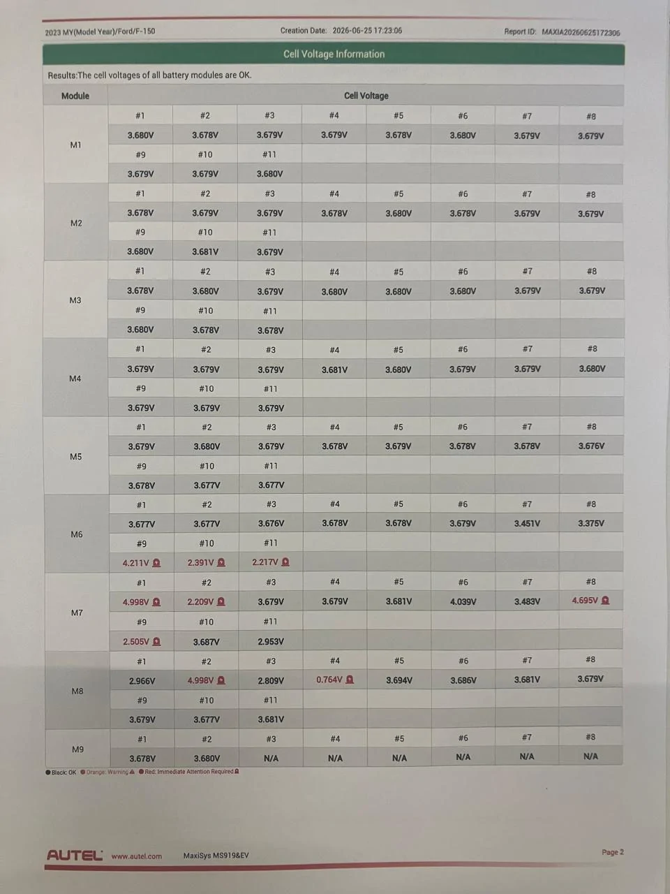

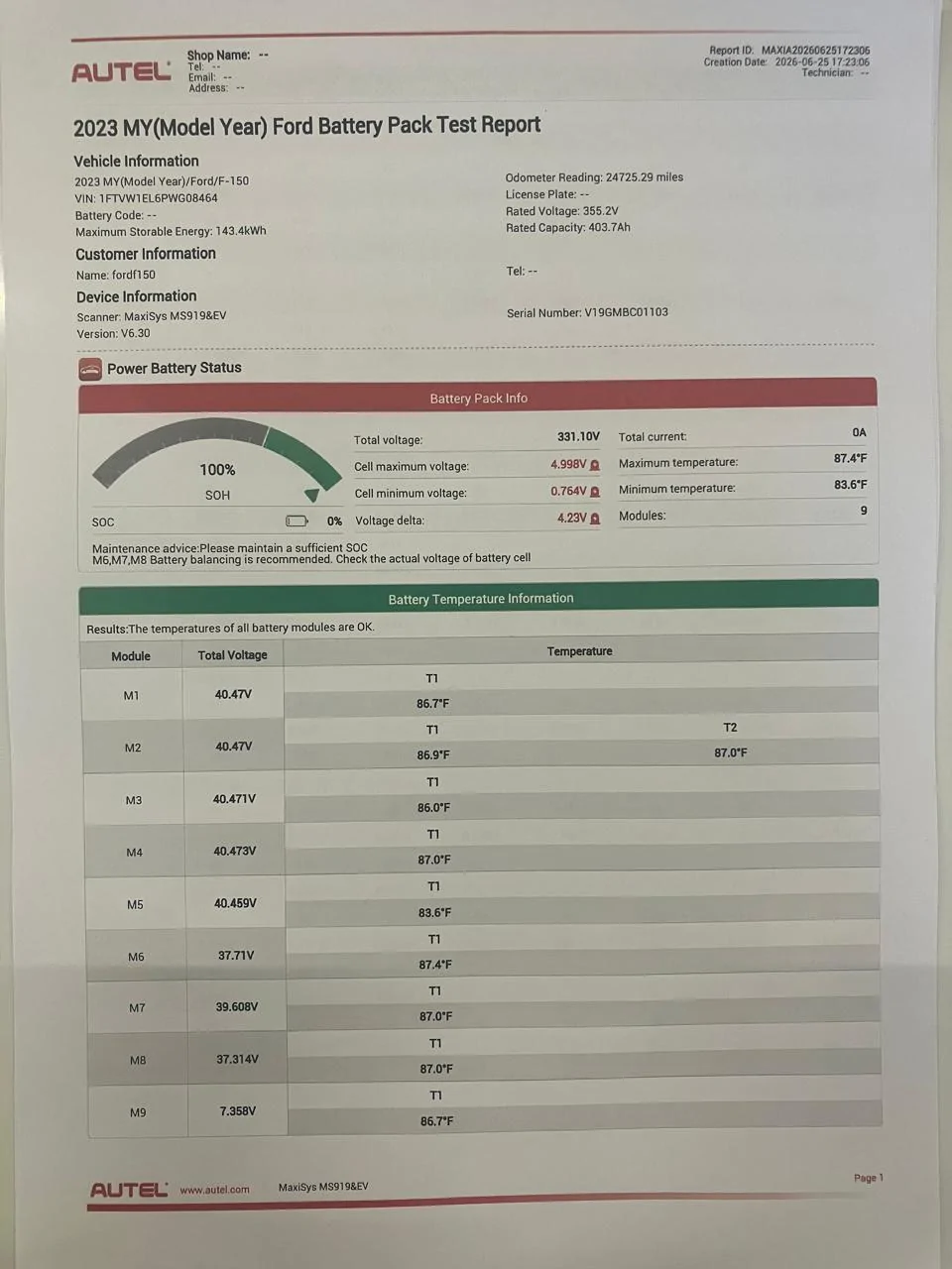

The latest diagnostic report appears to show:
  • Abnormal voltage readings associated with modules M6, M7 and M8.

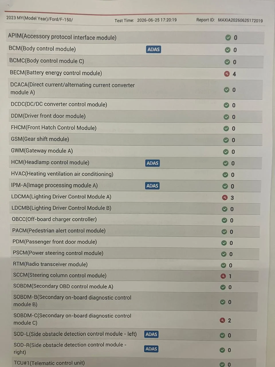

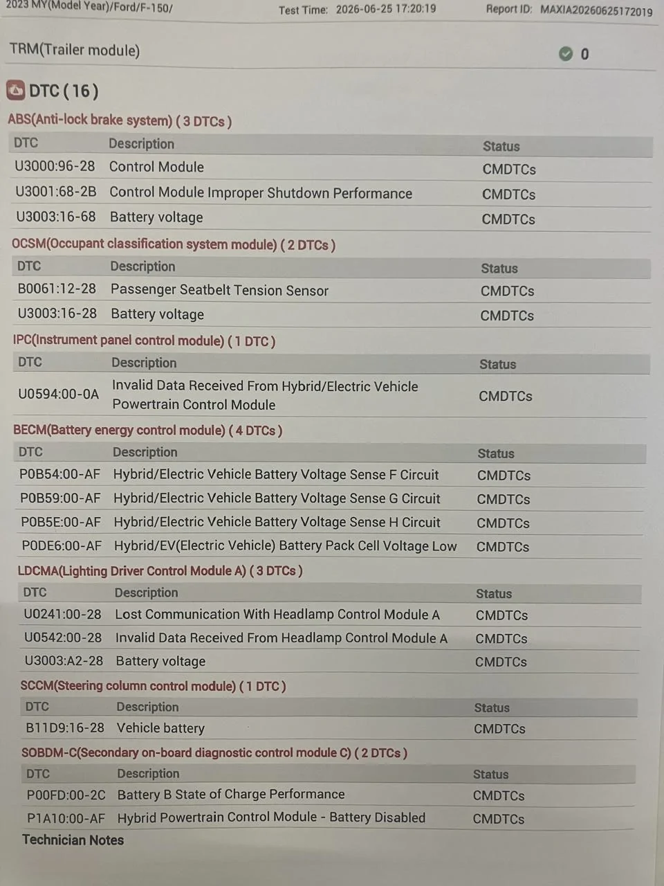

  • BECM DTCs including:
    • P0B54 – Hybrid/Electric Vehicle Battery Voltage Sense F Circuit
    • P0B59 – Hybrid/Electric Vehicle Battery Voltage Sense G Circuit
    • P0B5E – Hybrid/Electric Vehicle Battery Voltage Sense H Circuit
    • P0DE6 – Hybrid/EV Battery Pack Cell Voltage Low

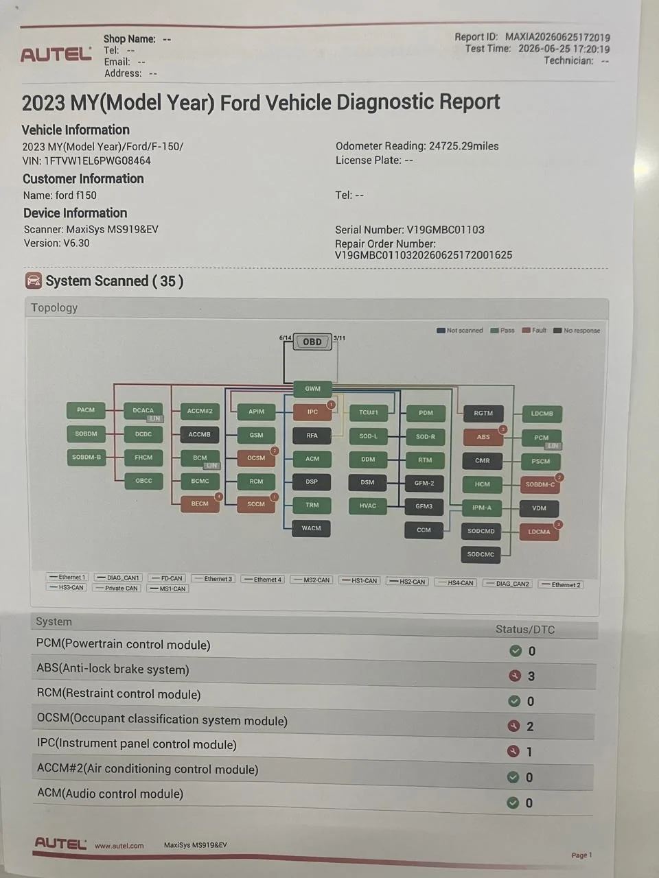

I’ve attached the diagnostic reports (with the repair shop’s details removed).

Modules that are out of spec should be replaced, not the entire pack as a whole.
Module 9 is not reporting conditions on cells 3-8 which is odd, might be a data glitch??
Thanks for the support. So module 9 is shot, are there others I need to replace?

Are there any other shops you can take it to? Any module that has one or more cells with a voltage that significantly varies from the others is going to be out of commission. Module 9 is unkown, I would want the test run again to see if it's ok or not. The report shows 6, 7, and 8 with cells out of whack. If a second test is consistent, those for sure will need to be replaced or opened up and balanced manually. A few reports of a single truck having multiple failures, typically over time though. There might be one or two reports of multiple modules failing at the same time, but that is incredibly rare. Having 3 go bad at once (maybe 4) is some seriously bad luck.

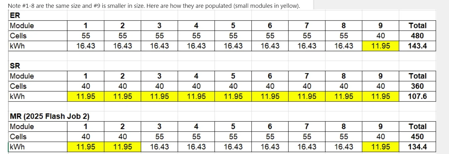

One thing I noticed is that the Autel report identifies the battery as 143.4 kWh, but the physical Ford label on the battery clearly states 107.6 kWh. Could this indicate the scan tool is using the wrong battery configuration?
143.4kWh is the actual battery size of the ER battery, the usable amount is 131kWh as I recall.
107kWh is the SR total, usable 98kWh.
So yes, something is funky.
