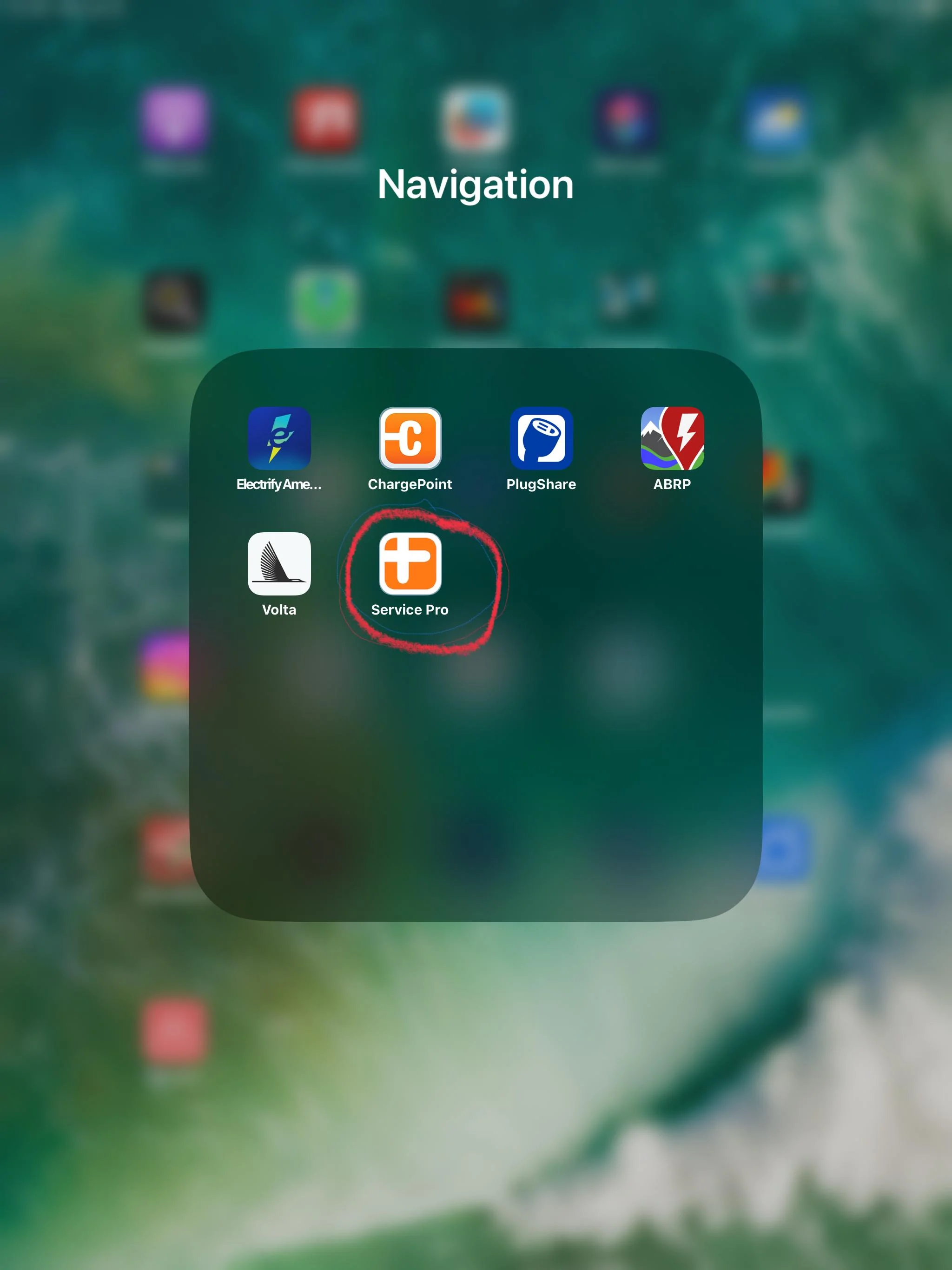

That was not my experience - the Quick Start Guide has instructions to connect to the unit via wifi and you get one shot at setting amperage. If you don't configure it, it stays at 16 amps. After configuration, there is no way to go back and change amperage.
if turn off the breaker and turn it back on and connect wit the pro app it can be changed Please make sure you have proper gauge wire and hard wired for the higher amp. Pro will need to be a different email account setup…
